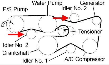

    So yeah, ran into higher water than I anticipated a few weeks ago, water over hood, powered out like a champ, yada yada yoda.
    A few weeks later, I start getting bearing noise up front. I have isolated the noise (I think) to the two No 2 pulleys (see attached)
    Never replaced a belt before, let alone swapped out pulleys. Any thoughts, advice, or well wishes?
    Part numbers would be awesome. I hear Gates from RockAuto is the way to go. Just not sure what else I should replace whilst I am down there.
    Option?
    Thanks all!

    Search up “replacing idler pulleys tacomaworld” some guy did a thread and included all the part numbers in it for each idler, two are the same number IIRC. Just do all 3 while the belts off. I did my two that were smoked and 30k later i need the other one cuz now it squeaks on cold start.

    I've done this on all three of my vehicles. Aside from getting the Gates kit on RockAuto, my best advice is this: remove the fan and shroud. The 10 minutes you spend removing/replacing them will do wonders for not having torn up forearms and hands. Very simple job, don't be afraid to jump in.

    Argh - Need some advice. I can't get the bloody nuts off the fan clutch to remove the fan. How do I keep it from moving whilst trying to loosen? I don't see any place to wedge.

    You don't have to remove the fan. Just run the belt in between the fan and the rad. It's open on the front side.

    Right as rain. Just worked the belt over the top of the fan and through the bottom. Sounds good as new.

    I found the easiest way to change them is from the bottom.. Just pull the skid plate and everything is right there. Also I would suggest doing all the pulleys.
