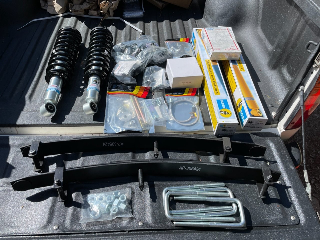

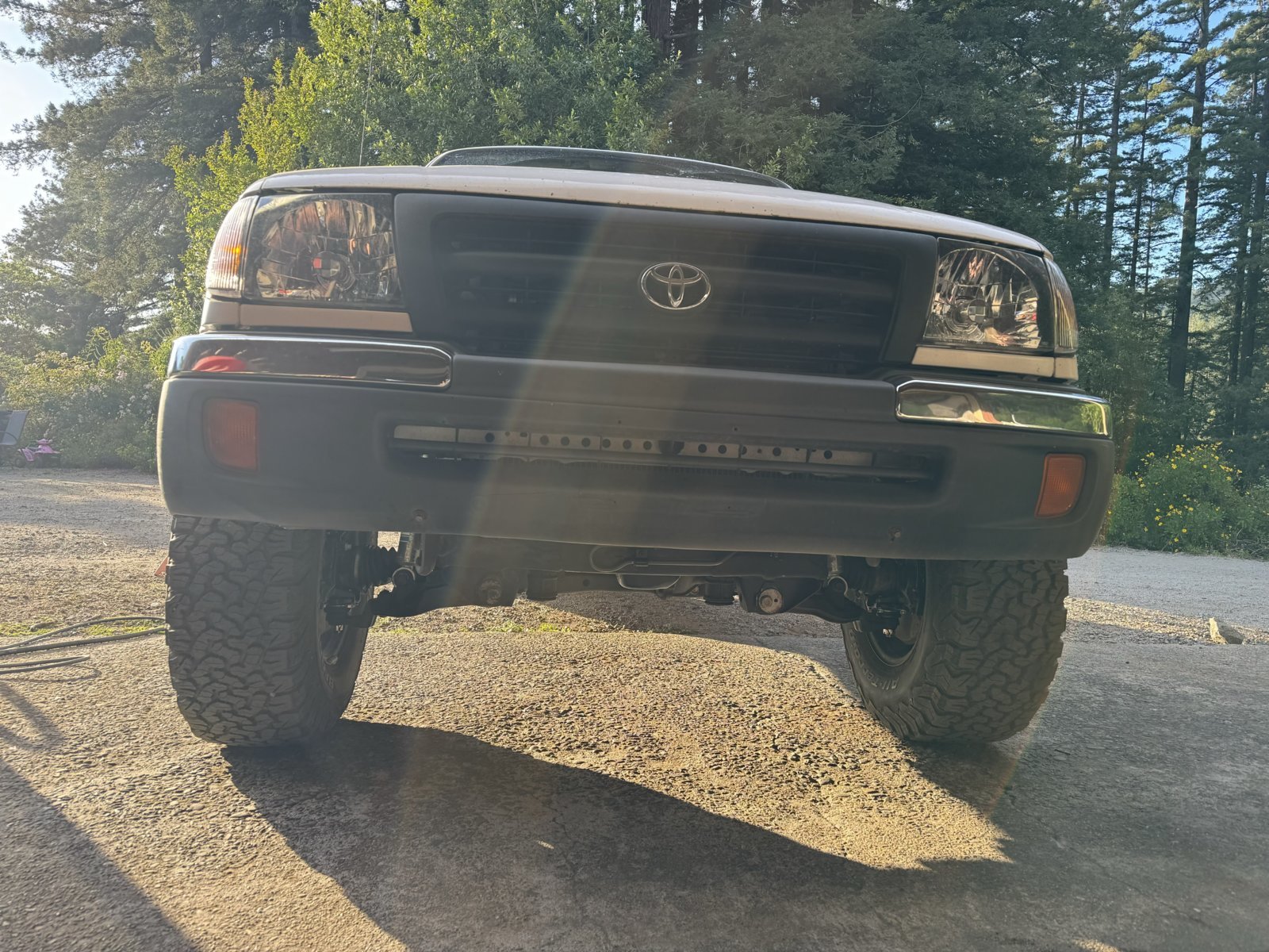

  19. May 14, 2024 at 7:07 PM
    #19
    Diablo169
    Diablo169 ROKRAPR
    Mar 12, 2016
    #181079
    2,908
    Max
    Santa Cruz, CA
    99’ Bro-Coma’s Revenge 3RZ 345k+
    Stock
    I'm going to quote myself here. WTF. Just got the RCD and OME coilovers and Icon Add a leafs, and I’m exactly 1” Lean to Drivers side. I thought the RCD versions had the spring cup groves different to adjust for the Taco Lean.
    One was labeled “Driver” and I do see a 1/8” difference in bottom cup to center lower bolt. Driver 6 1/2”, Passenger 6 3/8”
