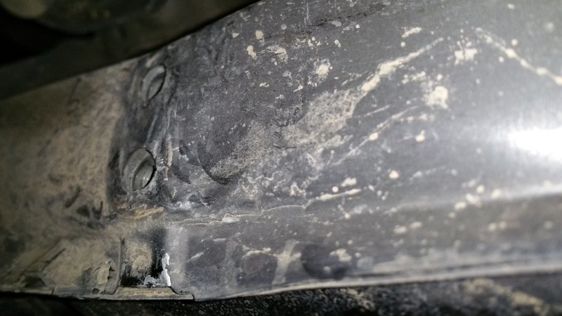

    Need some advice... A couple of weeks ago my wife took out the driver side steps. She bent the step back and I took them off no biggie. I got some used ones to replace the steps. I have one problem. The bottom part of the truck where you bolt them on is bent. I've tryed hammering it out but it didn't budge. And ideas on how I can straighten that part out so I can bolt on the steps.
    I'm thinking of putting on the bent bracket and hammering that out. Maybe with a mallet? Any ideas?

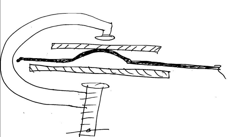

    Can you get at it with a c-clamp? I will attempt to draw a picture to illustrate but you could maybe put a piece of straight metal like angle, etc. on either side and use a c-clamp to press the bend out.
    Just remember that they call me "MacGyver" not "Picaso"

    I had to use this method to try and straighten an aluminum bracket that some of the guys at work damaged.

    Nice drawing. But no it's under the door. Maybe if I get a big c clamp mad open the door?

    :laugh:You sure did get me and beat me to it with that artwork!:thumbsup:This is pretty hilarious MacGyver!:cheers:

    wrong angle? take the handle of the c-clamp in the picture and rotate it towards your face, does that angle work better?

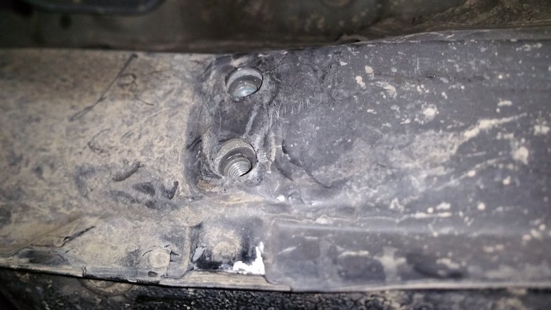

    This is what it looks like
