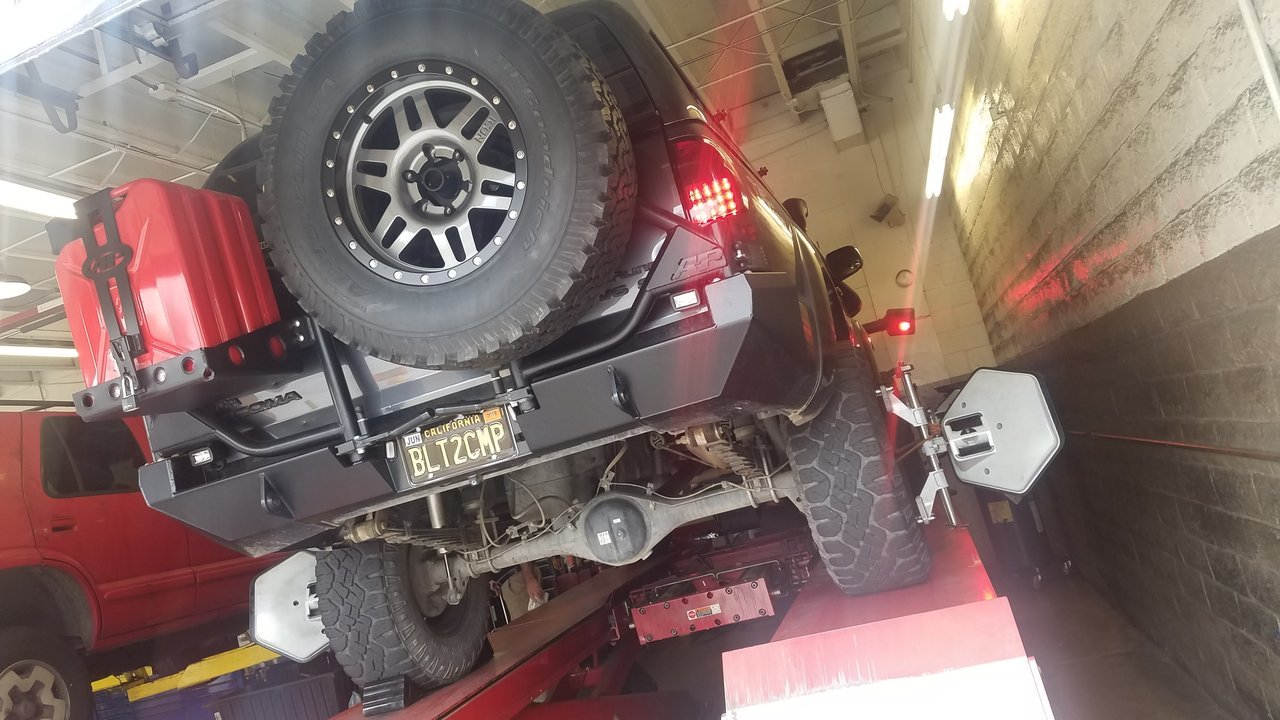

    Gonna go to alignment shop first thing in the morning and see what happens after that. I flexed out on a curb and got an extra 180° out of the steering wheel. Im only short maybe 1/4" of clearance on the front and rear, if the alignment doesnt help and TC tells me everything is right and it is in fact my spindles, ill take to the grinder and see what i can get. If worst comes to worse, ill either resell them and find the non race series ones that @Airdog has because i know they work or ill see what it would take to make a small notch on the lower and reweld. But thats all worst case. Ill keep everyone posted

  15. Jul 24, 2017 at 9:07 AM
    #6355
    ProForce
    ProForce IG @proforce.expeditions OB#5411
    Oct 12, 2009
    #24205
    7,078
    Anthony
    Alaska
    09 MGM TRD Sport DCSB 4.0 Auto 2wd
    Too many to list. See build page. Link in signature
    Here we go....

  18. Jul 24, 2017 at 9:20 AM
    #6358
    ProForce
    Oct 12, 2009
    #24205
    7,078
    Anthony
    Alaska
    Luckily this alignment tech is really good! He has an FJ with Icon and AllPro up front, all the other goodies winch, bumpers, snorkel etc. So he's got this down. Ive never been able to get my caster higher then 2.5 on each side and right now im at 4.1/3.8which is freaking phenomenal. The lowers added a degree i think.

    #6360
    LTDSC
    LTDSC 32oz of fun
    Apr 7, 2013
    #101544
    13,385
    Sam
    NorCal
    thats about where i maxed out on mine, was a big fan
