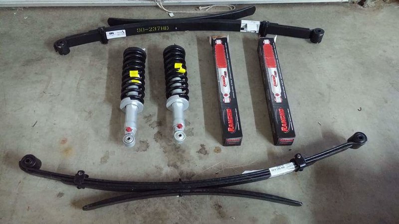

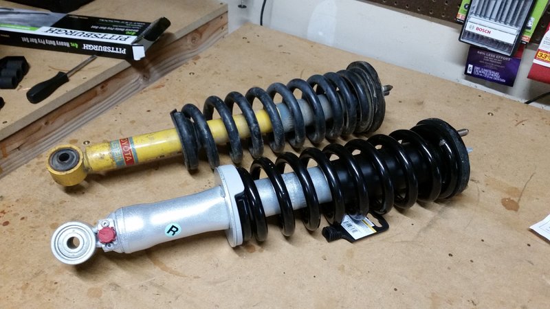

    After much debate I ended up going with the Rancho Quick Lift and General Spring HD's. The ride is much improved over the stock set up. I was experiencing wicked axle wrap. The suspension is tight, has a firm but not harsh ride and the shocks have 9 adjustments. Which I'll probably never use...
    The rear sits 1/2 higher in the rear but I'm sure it will settle over time. The front measures 37inches to the bottom of the wheel lip. The rear 37 1/2. I'm running 265s.
    The total price for parts was about $900 after a $100 rebate on the shocks. I just wish I would've measured the before height! I'm pretty sure I gained at least 2" all around.FB_IMG_1450492175761.jpg

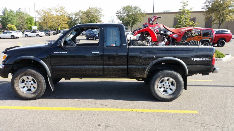

    Yeah my post might read a little confusing.
    Basically the truck sits 37 1/2" high in the rear and 37" high in the front. So 1/2" difference in ride height.
    My overall impression is that my new set up raised my truck at least 2" over the previous height with worn out stock parts. I wish I would've measured prior to installing.

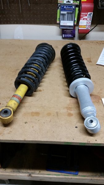

    The Rancho fronts supposedly add 1.75" over stock. I feel they are closer to 2 as installed and might settle over time. The height is not adjustable but the dampening is.

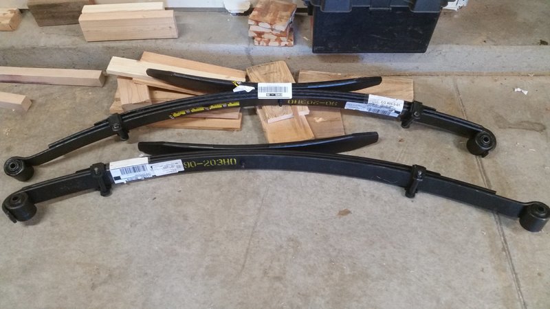

    The rear springs made a huge difference. No axle wrap whatsoever. After 400 miles they have softened up and now the shocks are actually dampening. I loaded the back with 120 pound sand bags to help settle the springs.
    If I was to just replace the rear leafs and not the front struts my truck would've had a nose down rake for sure.
    After endless research on suspension I think this set up is perfect for me. No bro lean, no taco lean, no vibes and no axle wrap.
    Honestly this is the exact look I was going for and I'm super happy.

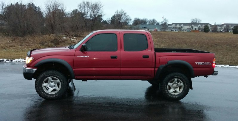

    Will add my 2004 doublecab to this thread since after hearing the review from Logger and messaging for information and others good reviews, this made me think this was the right solution for how I use the truck. 99% on-road, some towing of a 16 foot I/O boat and needing to get rid of the axle wrap from the worn springs.
    For me it all sits about 2" higher (V6) up from about 35" on the old worn out springs/struts. Rear sits at 37.25 with tonneau cover and at least 100lbs in the bed (and a full tank of gas) and 37.00 in the front with the passenger side just a .25 higher than the drivers - sitting on 265/75/16 Discoverer AT3.
    Appreciate the write up and the information provided - very pleased with the ride and handling over the post winter pot holes.
