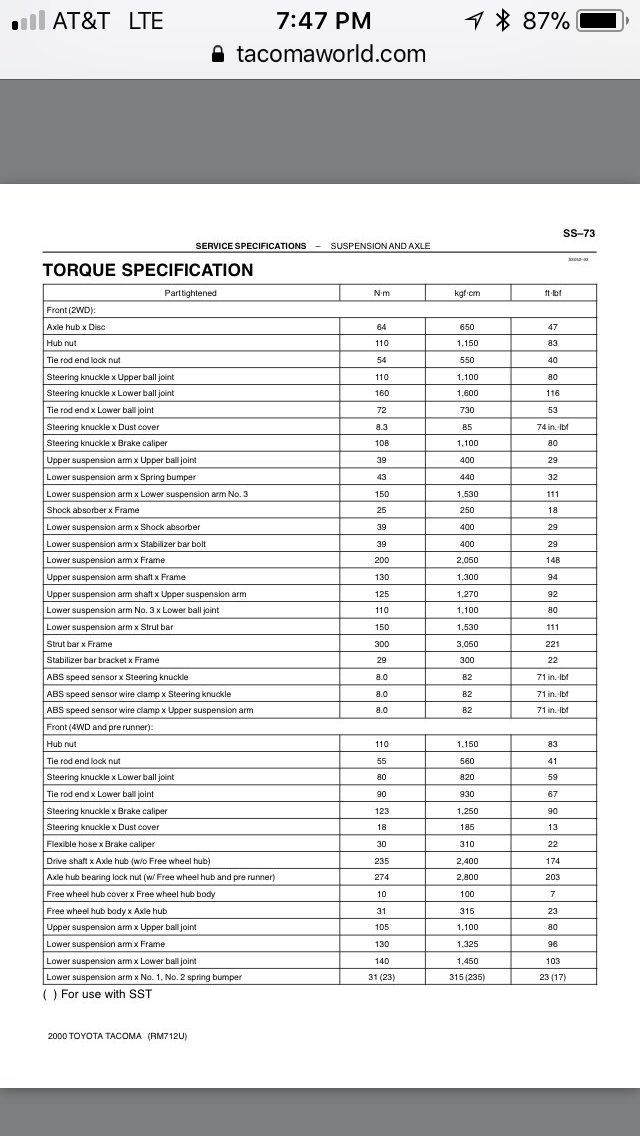

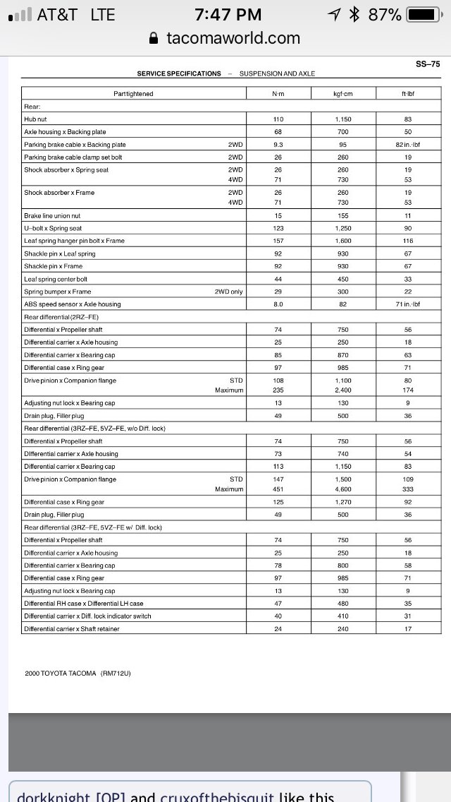

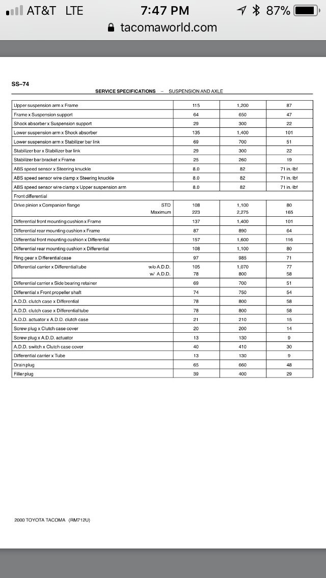

    Question, ones I put everything together I’m I going to have to torque the 2 lower control arm to a certain number?

    This should help.
