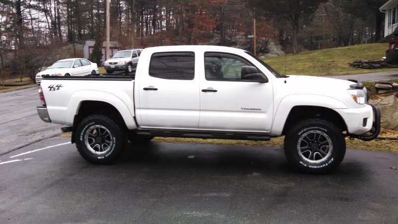

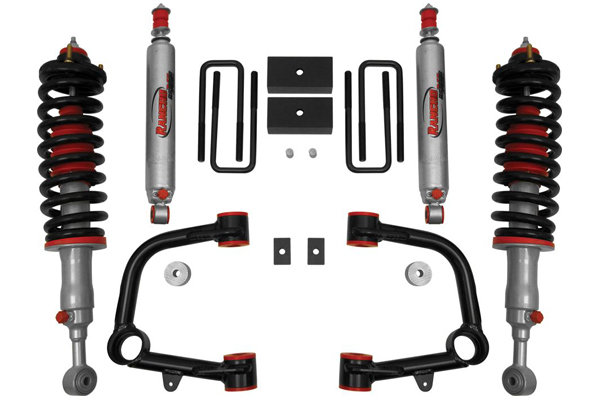

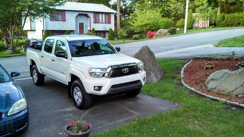

    I have the entire Rancho set up on my truck. The ride is great, when adjusted properly. a nice soft ride will be set between 2 and 5, hard ride is set between 5 and 8. The installation was easy, what I liked about the set up that I put on was it came with everything, all shocks, UCA, spacers, ect. I like the stance the truck has, allows you to install 285/70/17, remove the front mud flaps, slight trimming behind the front tire (Plastic trimming - no metal trimming). I don't off road much, dirt trails, mud pits, that's about it, no rock climbing. All in all I like the set up. It's not a popular set up with fellow Taco owners, not sure why. give me a shout if you have any questions, maybe I can help.
    BEFORE
    AFTER
    RANCHO SET UP I USED
