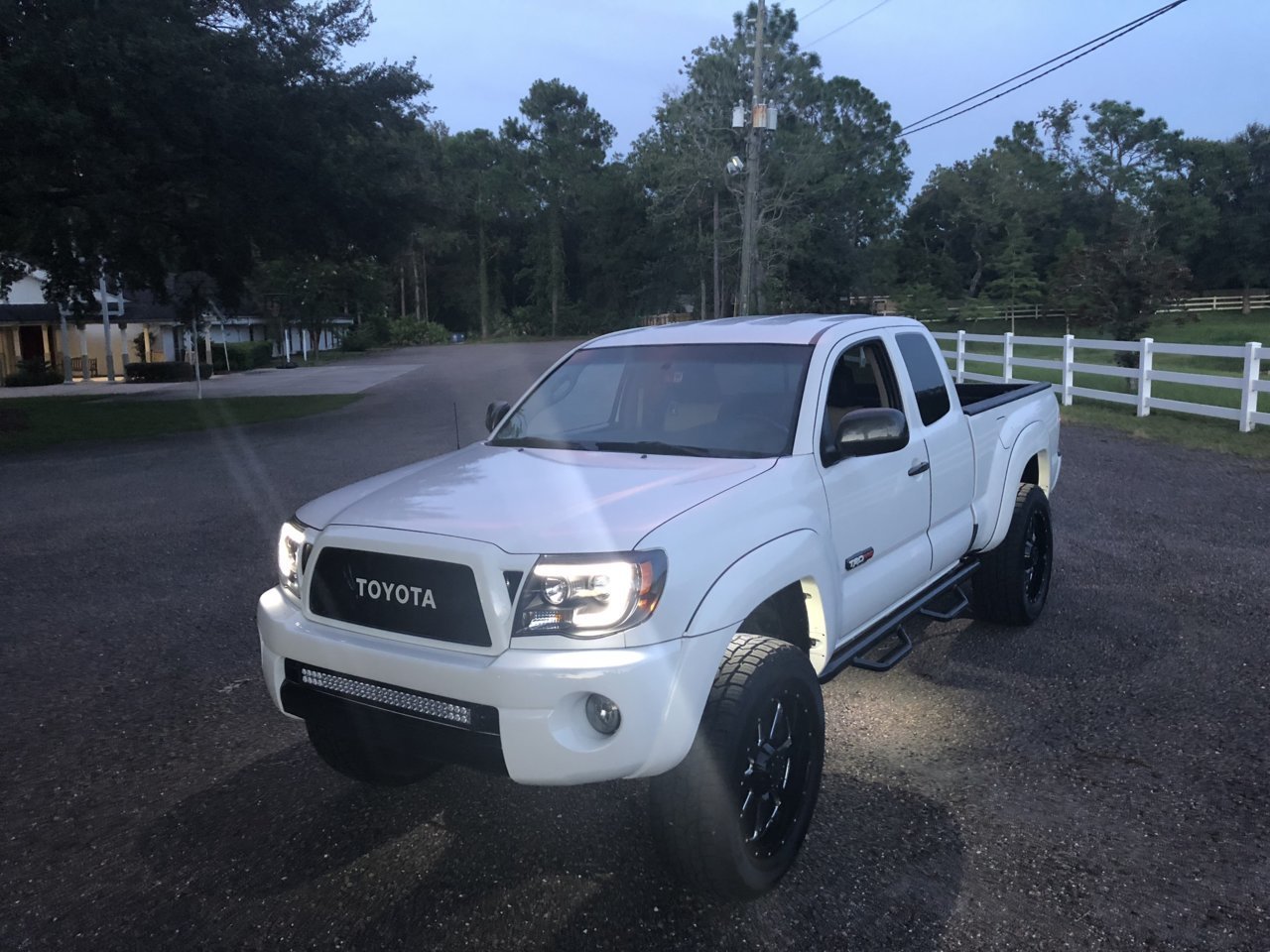

    they are working good on my truck. Rancho quicklift.:burnrubber:

    Cooper T/As 275/60/20 alignment is always a stab in the dark. find someone in your area that does lifted trucks.

    my alignment came out great even with my 285/70/17....with your tires all should have gone well, due to the smaller tires...by that I mean 275/60...the 20" rim and the 60 ratio is a good ratio to tend with alignment...nice job, looks great too. I Like the ride these suspensions give too. I also like your head lights, what are they?

    I had to take it back but it’s good now. Tacomabeast headlight check out the web site.
