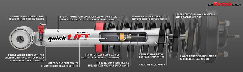

    Does anyone run this for the Front? What is your thought? I know majority of TW is on Billy 5100's but this unit is all in one so it will be lots easier to install.
    Amazon sells one for $165 bucks, complete unit for this price seems a great deal.
    Thanks.

    5100's are stupid easy to install if you unblot the LCA from the hub (two bolts) the shock drops out and you dont even need to use a spring compressor.
