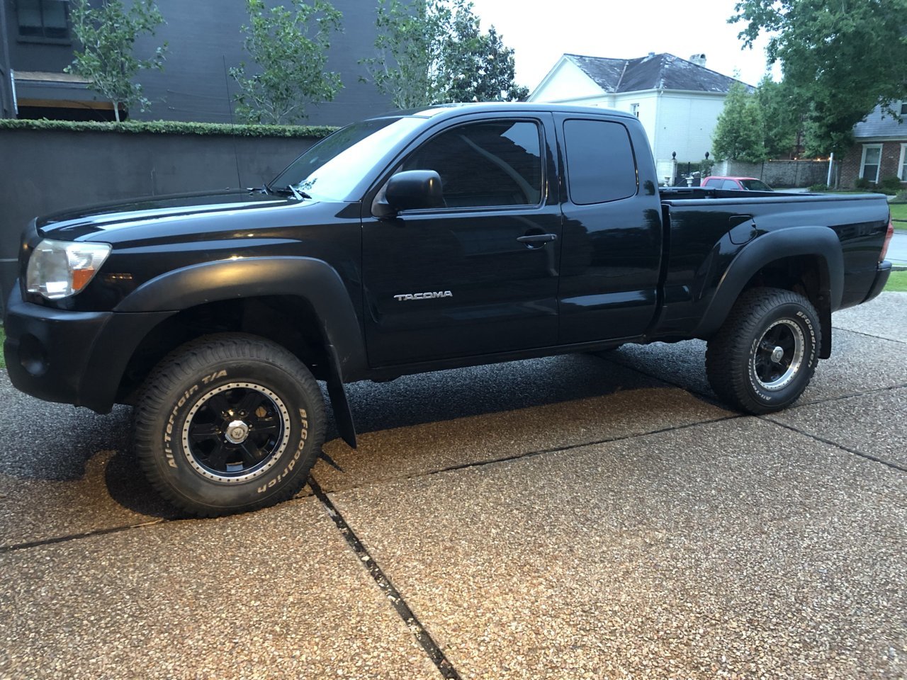

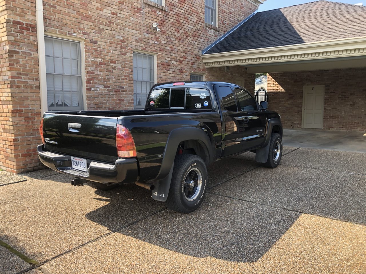

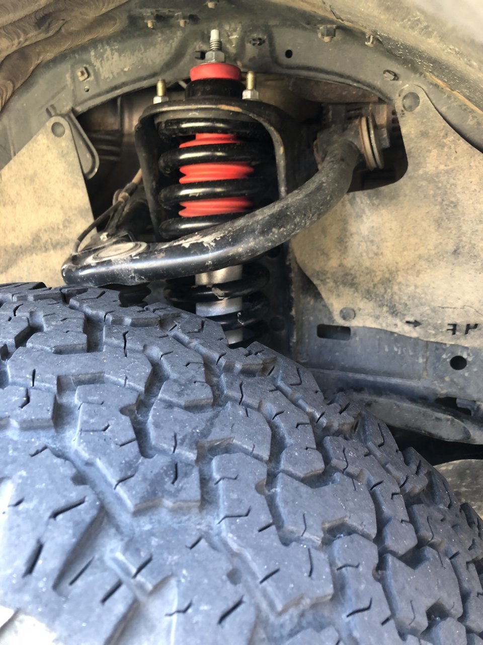

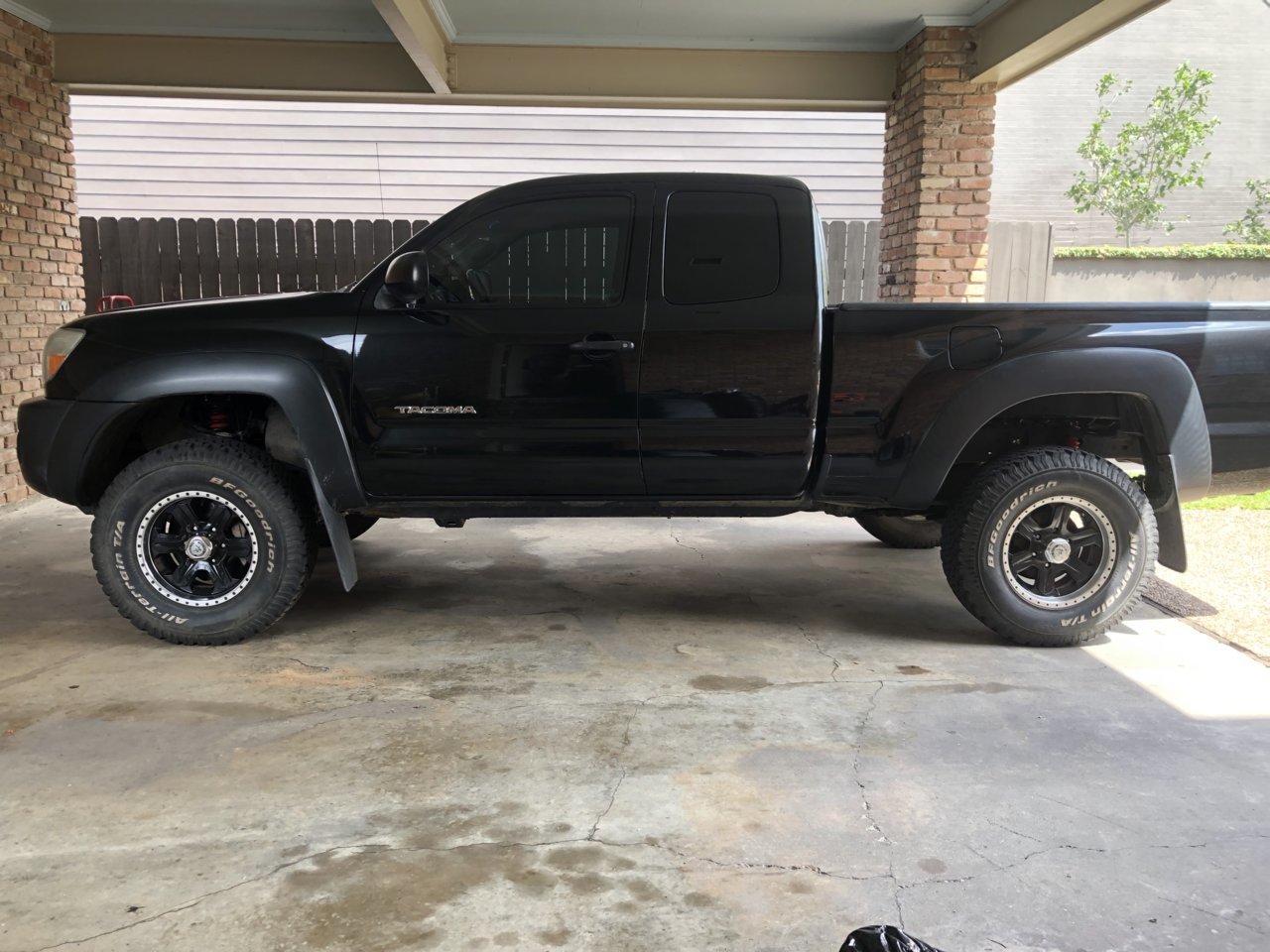

    I noticed there weren't many write-ups on the Rancho Quicklift for our trucks and what little information I managed to find was generally focused toward a negative direction. So I went ahead and bought it anyways, and two weeks ago spent a couple hours one Friday night installing it. The setup consist of two coil overs which provide aprox 2.5" of lift, two rear shocks which will allow about 2.5" of lift, and finally 1.5" blocks coupled with Hellwig Ez 500 helper springs. I use the vehicle mostly for city driving , however a few times a year it goes on camping trips or through the trails at my in-laws farm in WV, not to mention the occasional load of bark mulch or soil. So, essentially it gets both on and off road use, though nothing extreme.
    The verdict? Install was no problem, all the parts fit correctly and for anyone who has ever installed struts before it's a breeze. With hand tools, its 25 minutes per side once the wheels are off and the trucks in the air.
    The ride quality is fine, certainly better than stock. Its more responsive and feels tighter. Its a bit harsher ride than stock - only slightly- but it is a truck after all so I have no problem with that. Off road it seems a tad bit smoother, but nothing significant. At the snails pace I was traveling, I think a stock setup would have been just fine.
    In terms of settling , maybe a 1/4 inch at best. It's done a fair job at maintaining the out-of-box height.
    So would I recommend it? If you do a mix bag of driving -light off road use and occasional towing , then yes it's very suitable. I would not suggest it if you planned on going to Moab, though anyone with that consideration obviously is looking at a much more sophisticated setup. Hope this is helpful to anyone deciding whether to purchase this. Oh, and it cost me $419 after the $100 manufacture rebate.IMG_0168.jpg IMG_0178.jpg IMG_0177.jpg IMG_0174.jpg IMG_0178.jpg IMG_0168.jpg

    @Trucker08 Thanks man, and glad you found it useful. The one update I should mention is that I rushed the install between work and Family obligations, so I didn't properly torque down the rear shocks. After a few days, there was an clunking sounds which grew increasingly worse. Point is, make sure you torque down the rear shocks (Lower eye bolt) to 73 ft lbs to avoid any play.
