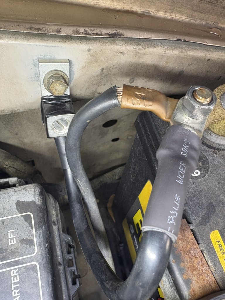

    Not flashing CE lite constant but on for 3 secs then off for 2mins then a 5 sec flash followed by a 2 sec blink
    Taco would bog….zero throttle response when CE lite on…..the CE off everything normal
    yall know me and codes…..I couldn’t read a code….no stored codes either
    Broke down and took advice to buy scangauge. Set on TPS reading
    Determined that tps reading would freeze for same amount of time as the CE flash
    Bought (ugh P cannon FTL) OE TPS, installed and calibrated
    Same issue
    back to TW for more searching
    One 2018 thread similar issue, dude found harness pigtail from TPS cracked/melted.
    Started to take off harness to inspect. During this wrenching, Thatt advised make sure grounds good. Nothing obvious with harness and found some diagrams of the 3 grounds (2RZ). I found 2 looked good but removed/cleaned anyway
    frustrated, thinking I’m going to have to do ECM pin out test went to bed.
    Cowgarf3 motivated me after work today (and was 10 degrees cooler than yesterday)
    Look WTH i found….

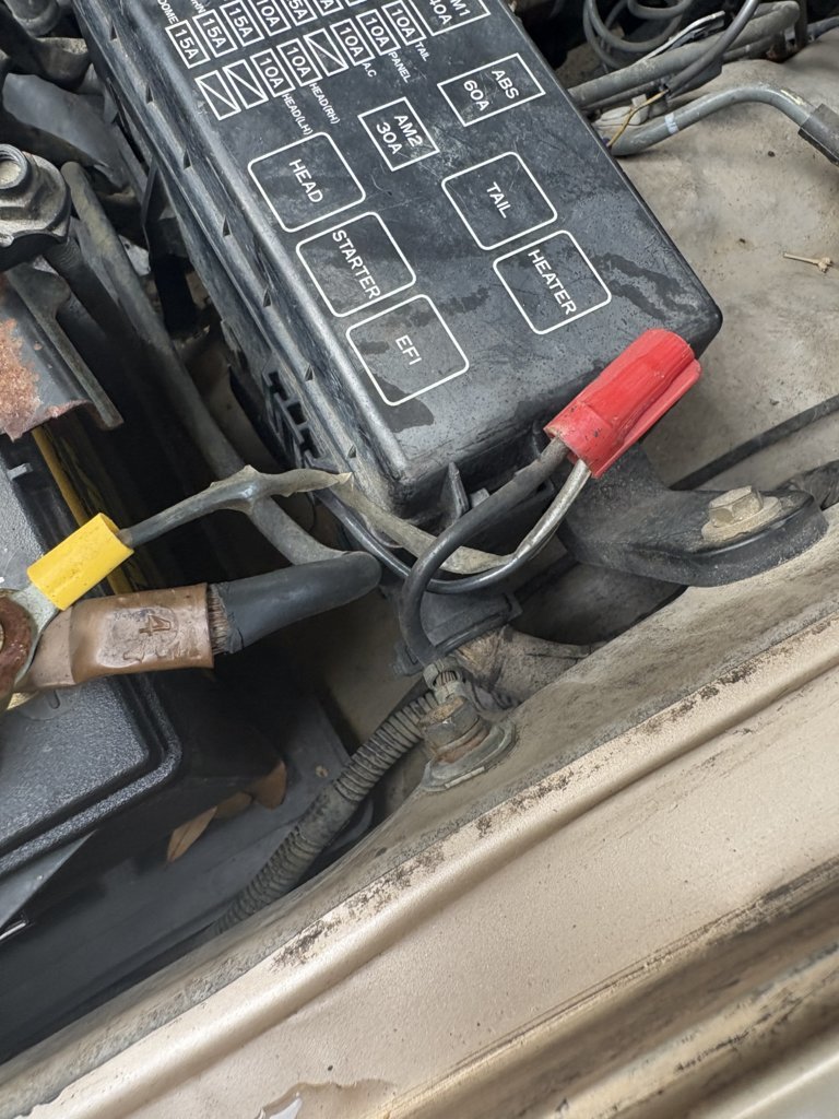

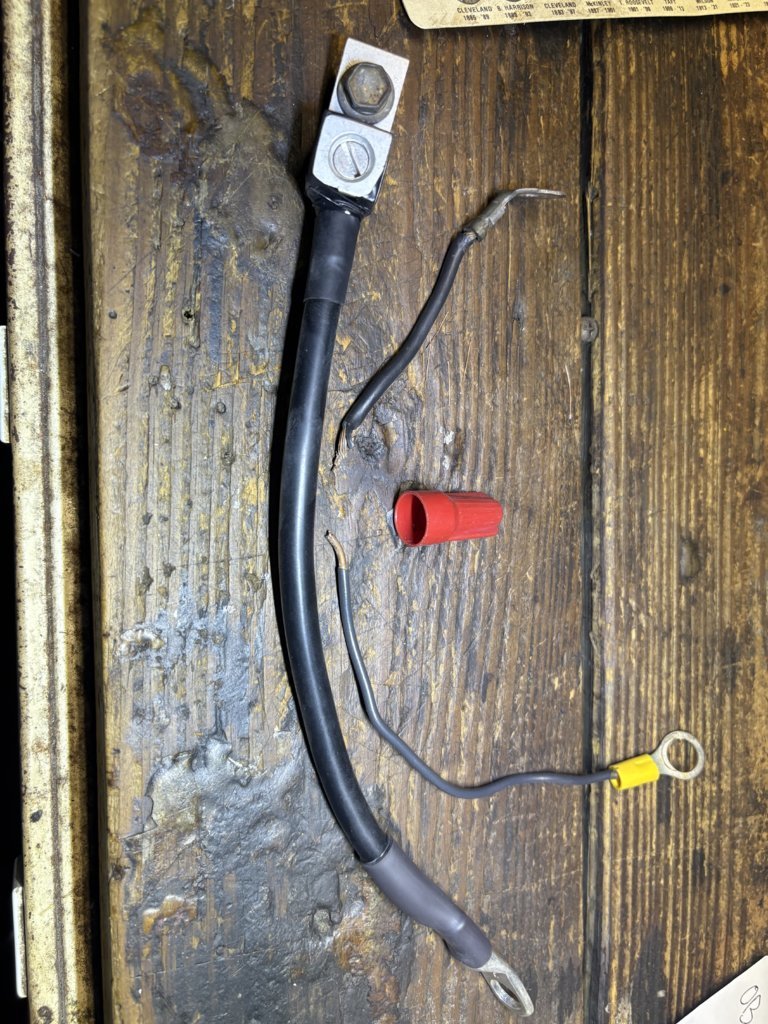

    Please everyone “prior owners” work there!
    could it be that easy????
    new ground wire made

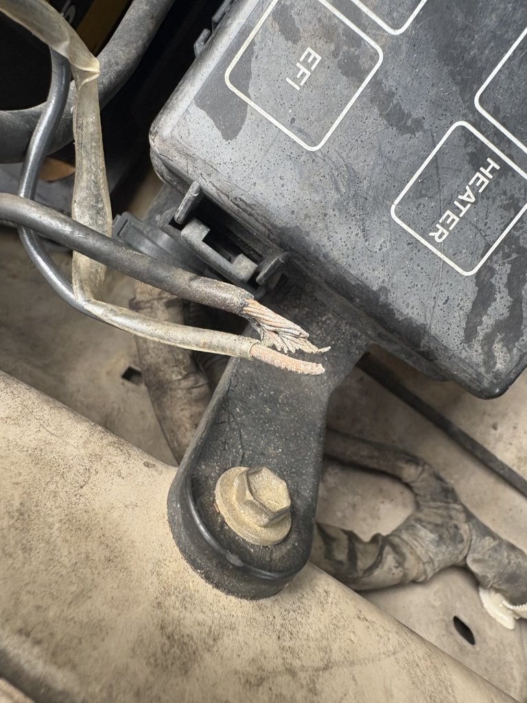

    Then had to re-lace engine harness also corriosionX-d all pigtails
    went for extra long test drive
    SUCCESS
    thanks again for everyone that posted (long ago in other threads)
    funny
    I’m 90% sure a shop would of installed a $550 throttle body and still wouldn’t of fixed
    Turned out to be $2 in parts I had in my garage.
