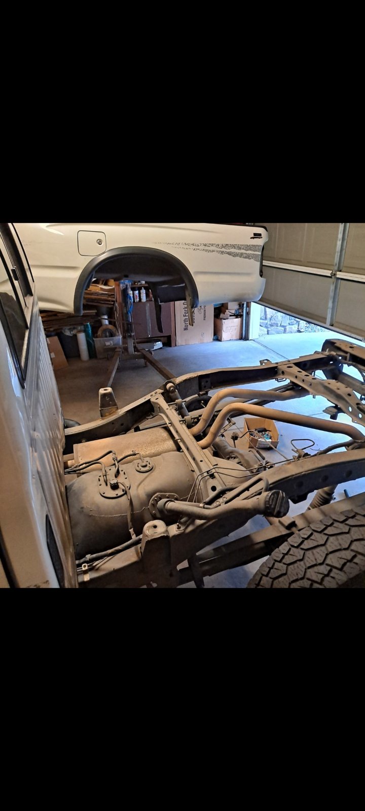

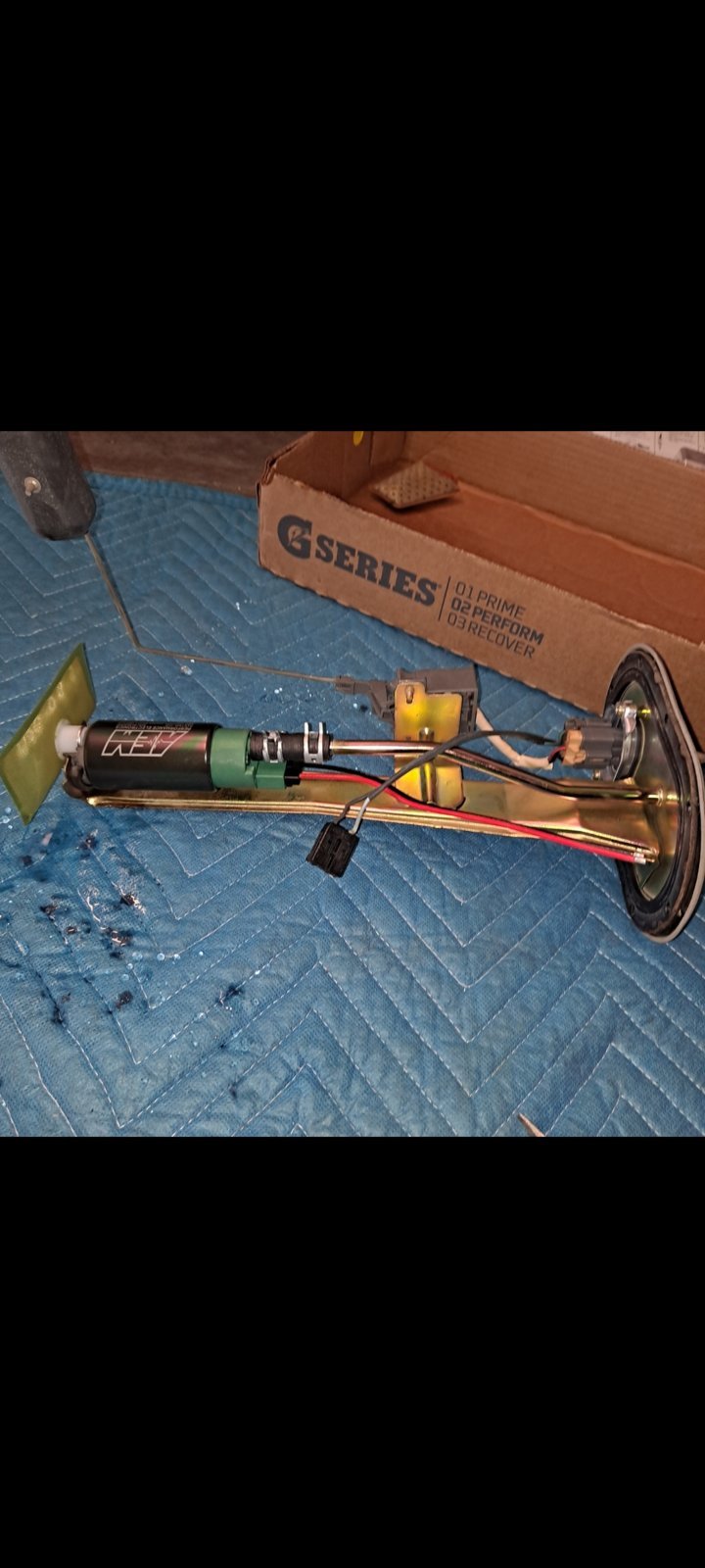

    It cut out again today, pulled off the highway and turned everything off, waiting a minute and turned the ignition on.
    No fuel pump noise that i usually hear for 5 seconds as it primes the system and no start.
    waiting 5 minutes and turned ignition key on and this time I heard the pump priming and started right up.
    Also I noticed my AFR at idle bouncing around from 14-17
    So yeah probably the fuel pump going south.
    Guess I have a Saturday project now :)

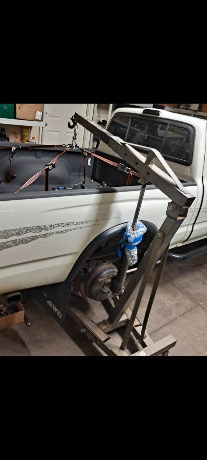

    Not 100 percent but 60k or so, but should have gone loner.
    It’s not that bad of a job,
    3 hours with an engine hoist.

    Yes it’s modified,
    I have a AEM 350 high flow pump aftermarket,
    Yes you can hear it turn on for 5 seconds or so maybe less sound comes from the gas tank,
    It’s controlled by the haltech stand-alone ECU so it’s different than stock ECU
