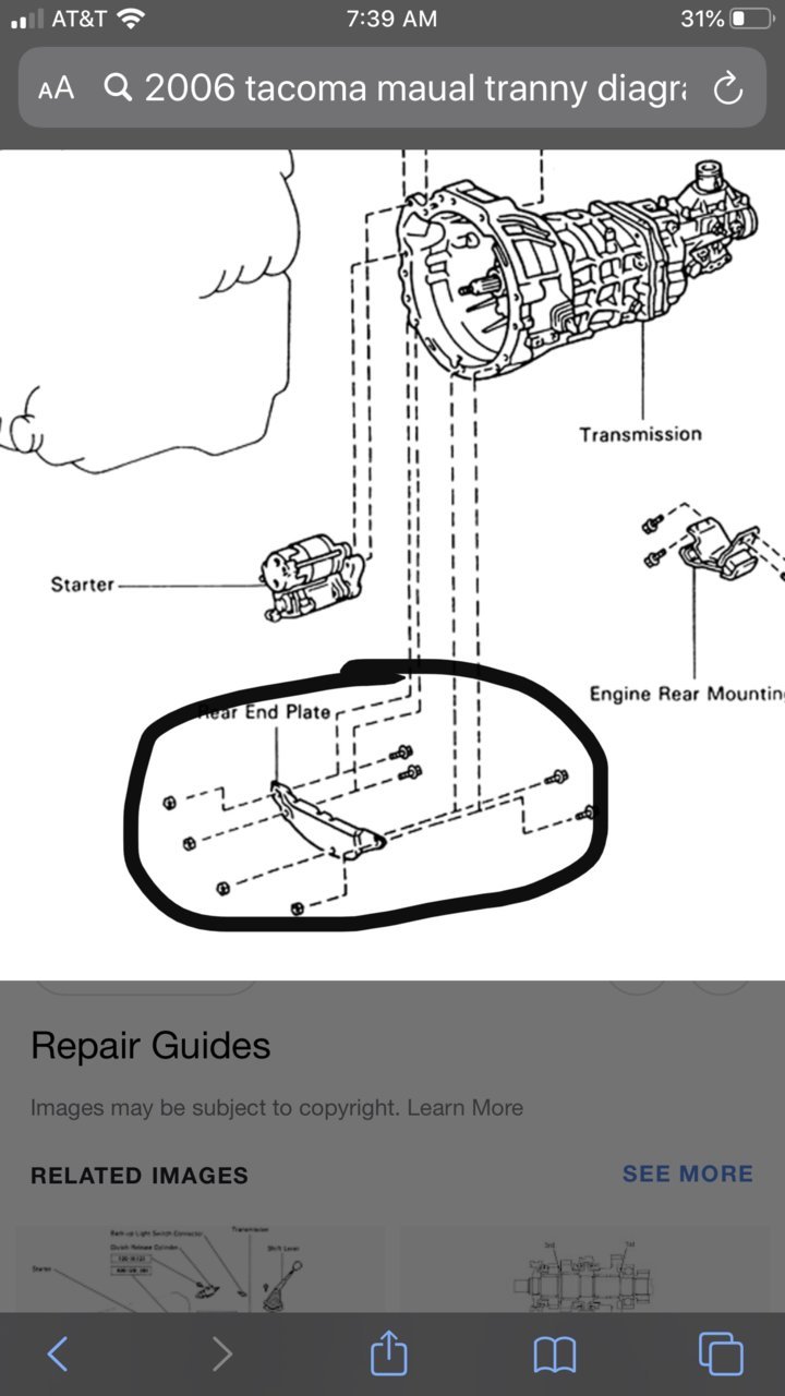

    Does your tranny where mounts to the engine block have this metal plate. It can actually be removed and look at the flywheel. 9ACD1835-AF44-4778-BC4D-04C50C6102F1.jpg

    I'll look again.
    That diagram is showing the starter on the wrong side though, so it may not be correct.
