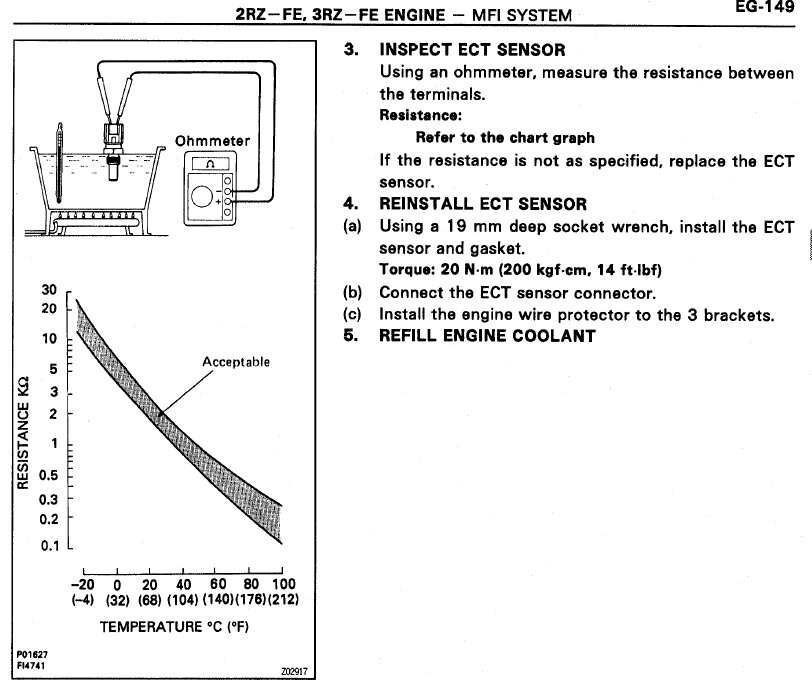

    Before you replace this one why don't you test it first

    So I tested the Engine Coolant temp sensor (not easy to get at if you have large hands) and it was bad, so I replaced it, reset the computer and went on a 45-mile, back road adventure. I stopped once for fuel, again for a Slim Jim and a bag of chips. I also stopped and waited for 3 Led Zeppelin tunes to play though when parked and ignition off. Not one issue
