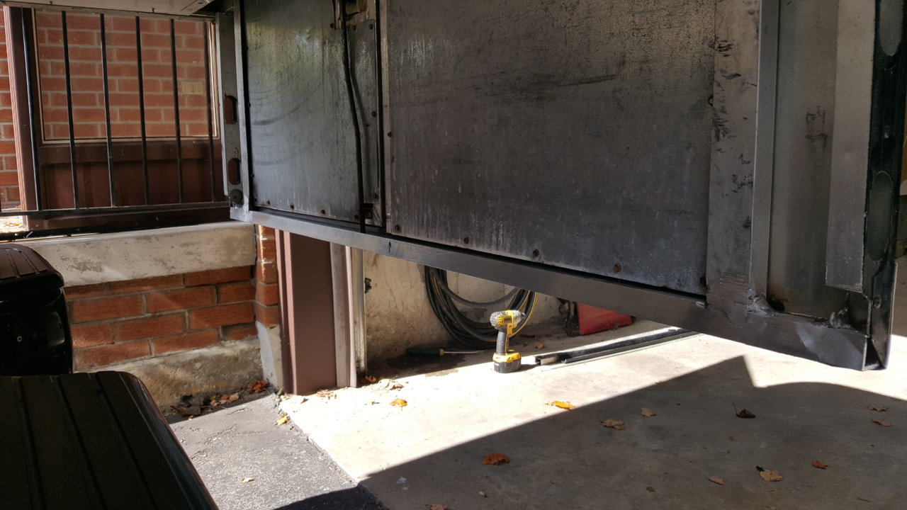

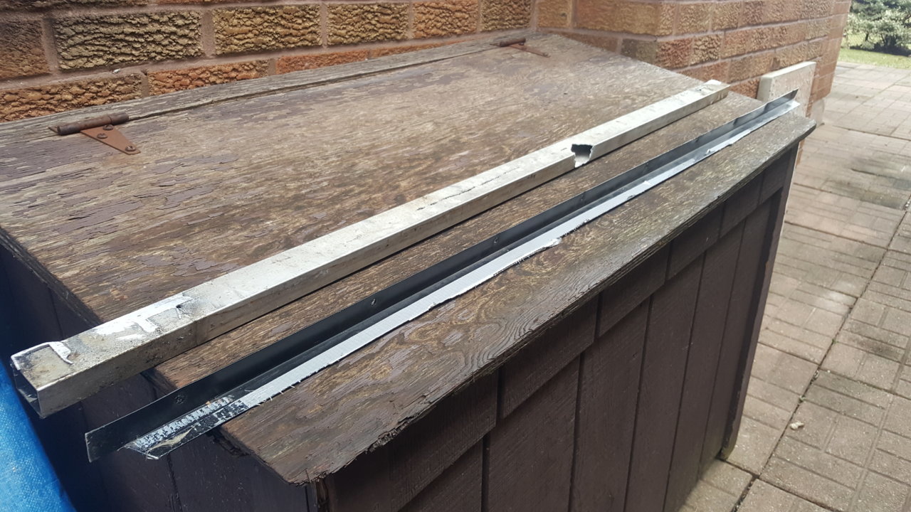

    Ok, Im finally getting around to posting the modifications I made to my Ranger ARE DCU double barn door shell. There is a 2" length difference between the Ranger and Tacoma box. Tacoma being longer. 20200104_150527.jpg
    These are the 2 pieces I removed. The 1x1.5 thin aluminum was the old lower rear door frame and the 1x1 black angle was on the front of the cap.

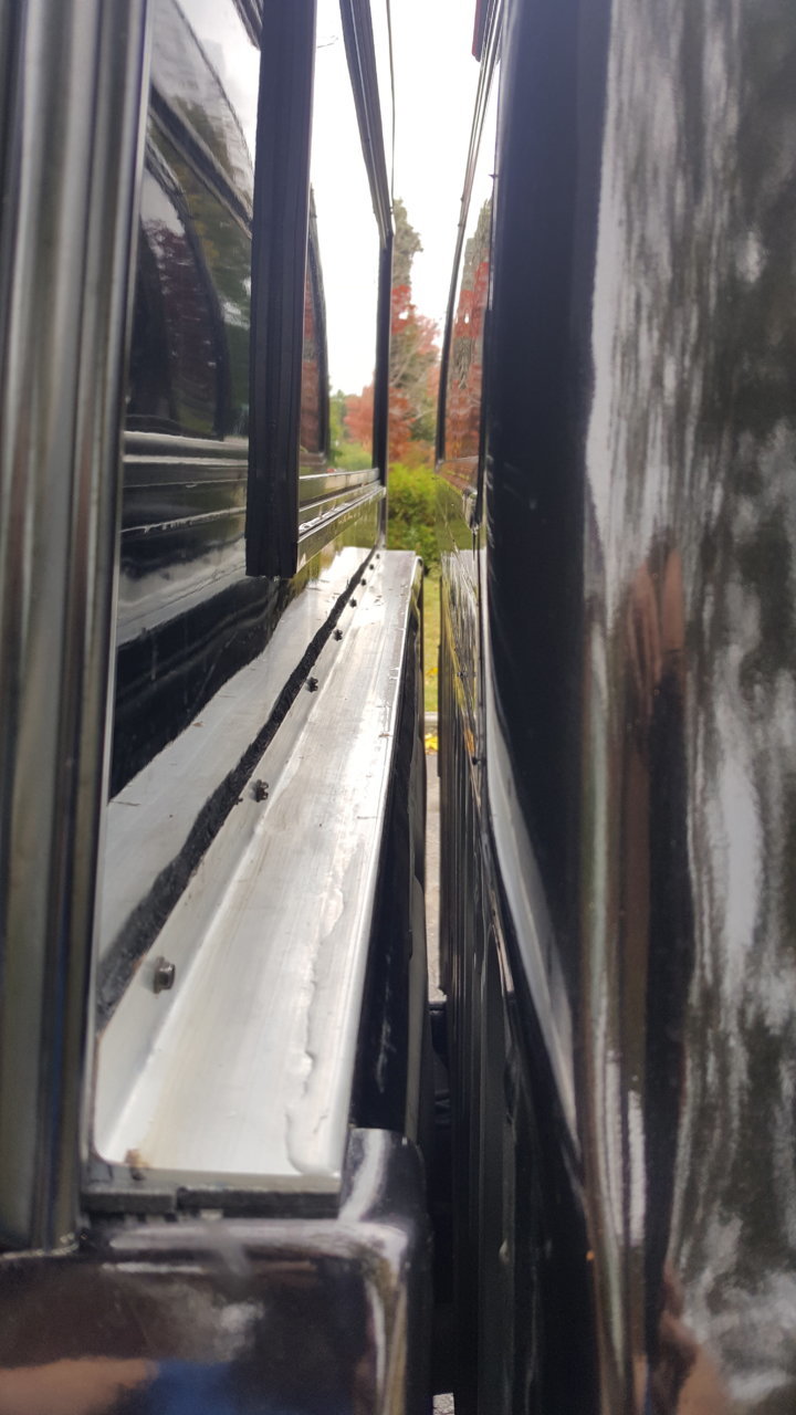

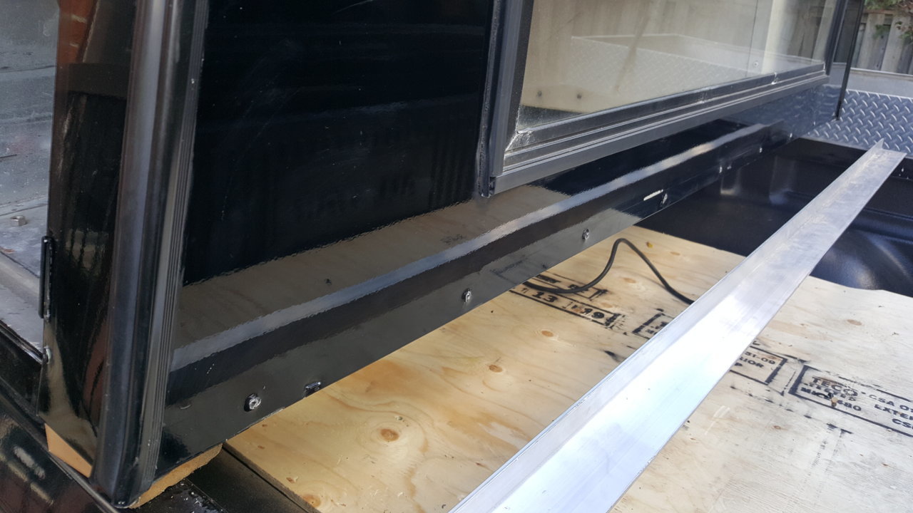

    Rear lower door frame removed.

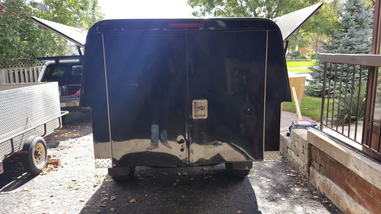

    New 1x1 1/8 thick aluminum bar welded in place. Drilled a new hole for the lock rod. Rear of cap is done.

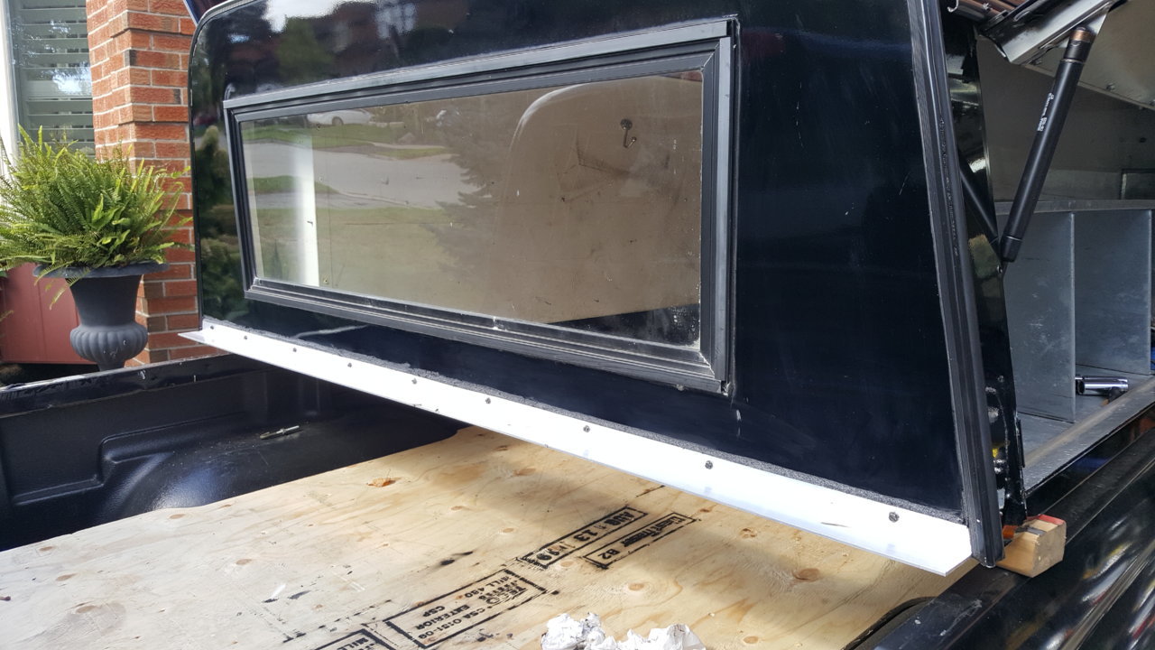

    The new 1/8 thick 1x2 for the front.20191005_125811 (2).jpg

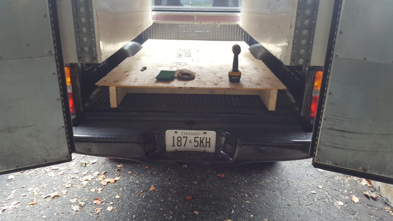

    Installed, sealed and much sturdier than before. The rear of the bed floor were in rolls down above the bumper got pushed forward with a 2x4 to gain the extra 1/2".

    Nice solid seal up front. Still have enough room to clean the windows too. I also found some soft rubber seal I used between the cap and taillight gap. Sorry no pics of that right now.
