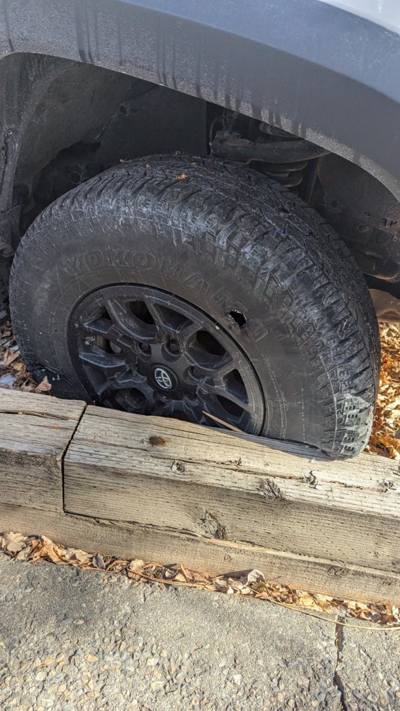

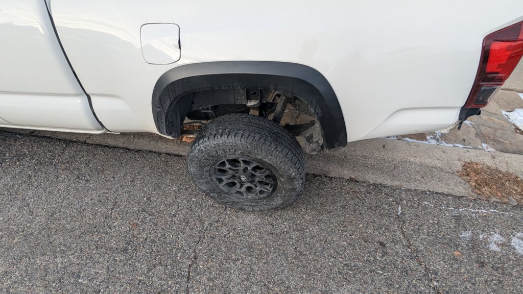

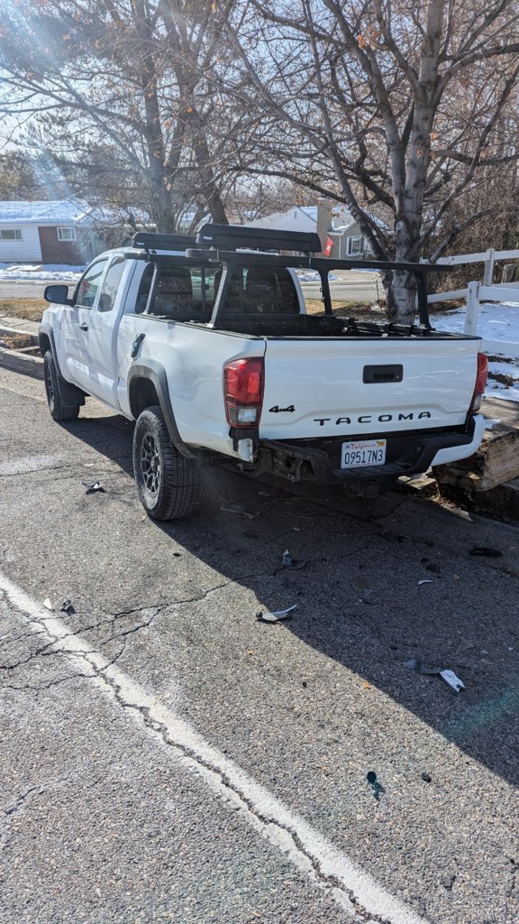

    My poor 2020 SR SX got nailed by a drunk driver while parked in front of my house. Those who have been rear ended... What are your thoughts here? I'm fearing that its totaled...

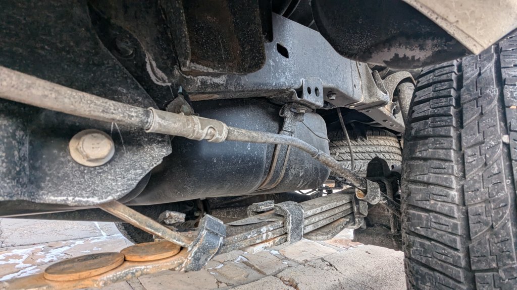

    The impact clipped the back left corner of the truck, hitting the back left tire dead on. The front right tire/wheel hit a big landscaping rock. Axle is very far off axis and the leaf springs are both bent/ broken. The back left quarter panel is buckled, and the bed was pushed forward far enough to dent the cab. I can't tell for sure, but it looks like the bed is no longer aligned with the cab. The whole truck got launched about 20 feet forward from the impact.

    Your insurance adjuster makes the decision and will let you know. The biggest factor: the value vs the costs of repair. The amount of miles is the biggest factor on value. It looks like the frame didn't buckle in the rear, as the car went under it,,, but the spring/axle shift still has me wondering if there is frame damage elsewhere.

    From what I see, the frame is fine. The rear hitch ( bumper ) is mounted by screws/bolts on the actual frame. That's a whole piece they can replace. They replaced mine, the bumper might be damaged but it does not directly transfer impact to frame, since its screwed on.

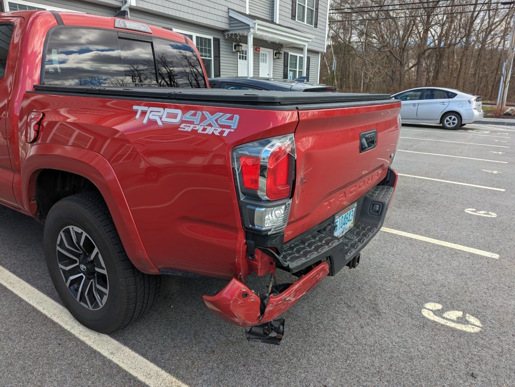

    Here was mine, I was standing on red light when minivan rear ended me around 30MPH or so downhill he was going. The cost was roughly 6k. Make sure to check your tailgate, in my case it was misaligned and they had to replace left rear bed fender too.

    Bed side, bumper, leaf pack, tire, dent repair on the cab, probably the leaf shackle hanger... probably not totaled.

    Still waiting to hear from the insurance estimator, but the shop tallied up about 10k worth of repairs without including any frame work, which they determined to be bent diagonally.
    Sounds like they're waiting to hear from Toyota if they can replace some portion of the frame, but the shop sounded doubtful of that.
