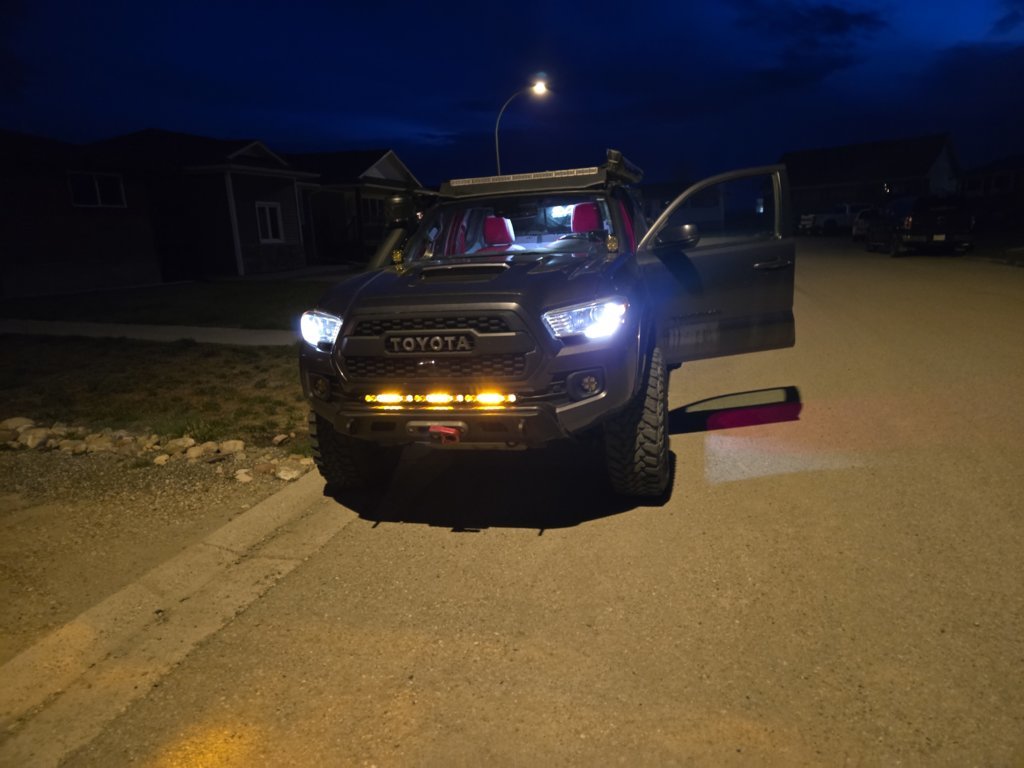

    I'll stick to amber back lit lights for any accent lighting.

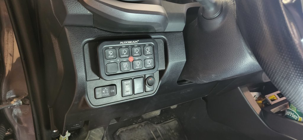

    Mine are wired in on a switch panel so they are on when ever I want them on. I wouldn't tie into an existing power source for anything beyond a signal to activate a relay. Leds are low draw but i have done my best to leave all factory wiring alone on my truck to limit any future problems. Even my switch panel isn't hooked to a switched 12v source so it can be ran with the truck off for camp lights

    Interesting. I'd like to know more about how you powered your Auxbeam. I'm a novice, so I've just been winging my wiring. I believe the way I wired my Auxbeam, the truck has to be in at least accessory mode to use it. But I do plan on connecting my Blue Sea Systems for anytime needs. My understanding is in the case of my air compressor, the truck should be on to run it. But LED lights would be nice to activate anytime. Do you mind sharing a photo of your wiring? I've documented my progress on the forum here.

    No pictures but its really easy. All i did was pull an additional 18g wire from the hot connection at auxbeam relay box that is in the engine bay back to the switch pictured by the switch panel in the cab. Flip that switch it powers the panel right from the battery and no mucking around with the factory wiring it's all stand alone.
    I havnt wired in my compressor as I move it from vehicle to vehicle somewhat regularly and with the amount of back road I bang the truck down I don't want any extra weight mounted to my fenders as I'm sure if I looked close enough the factory battery tray has already cracked. But if I were to do it I would wire it in via a relay then just use the 5amp output from the auxbeam as a trigger for the relay as the highest fused output is 30 amp and im sure most compressors can exceed that amount of draw.
