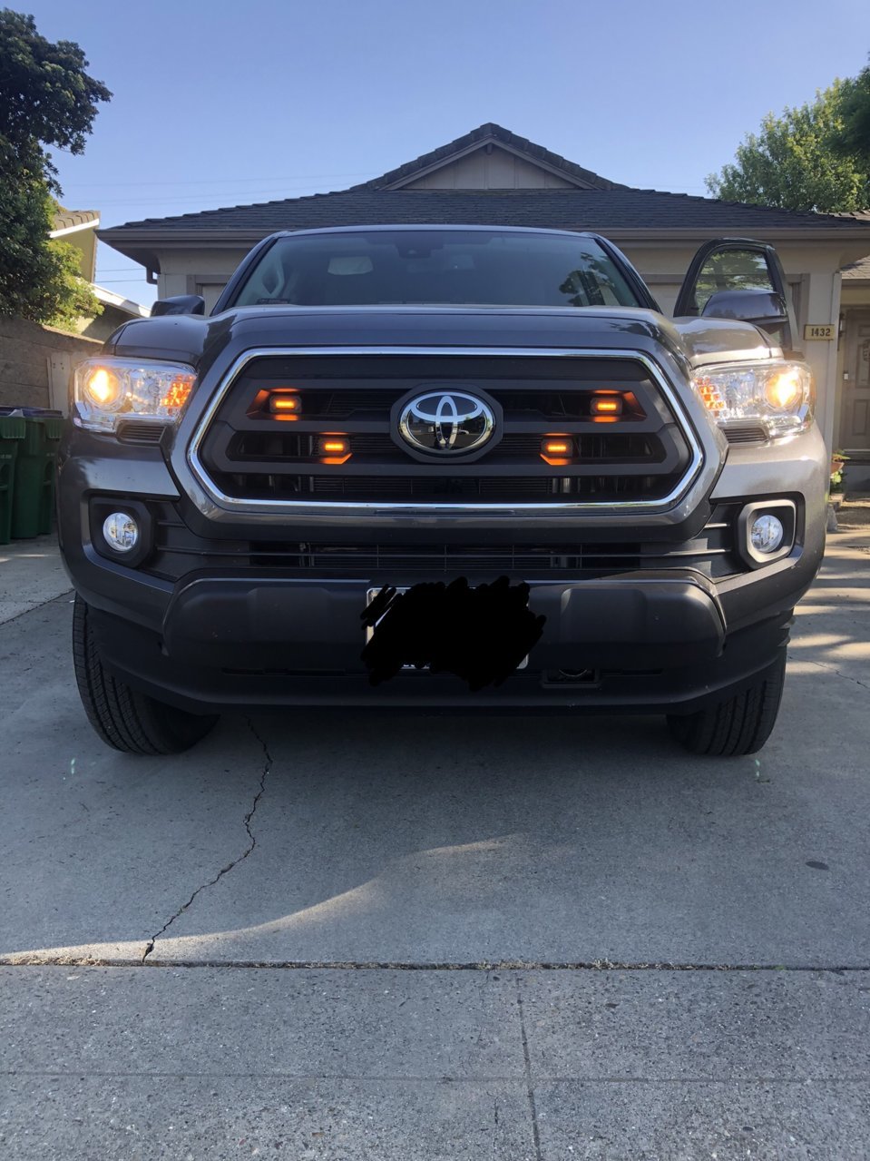

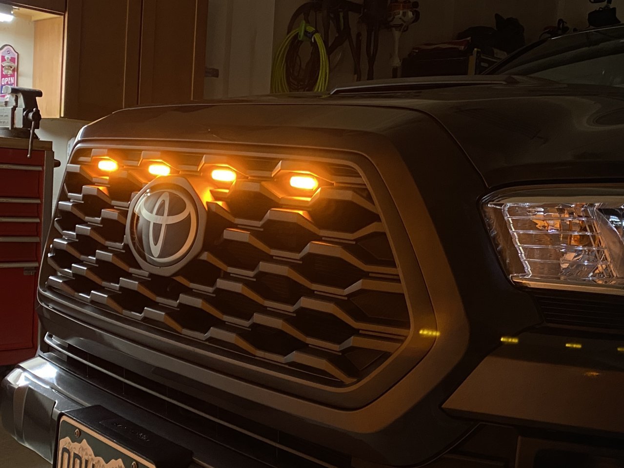

    Hey everyone I needed some guidance on which fuse to add on my raptor lights to? I tried INJ and they remained powered unfortunately. I tested other fuses but nothing to keep them on like daytime running lights. Any ideas would be great I’ve searched for answers but nothing for my particular situation whyE5E0B23E-43C7-49D2-9928-4B1632244B52.jpg C3E5CFBA-89B6-4386-9659-B800DA7B6C20.jpg doesn’t INJ work?!
