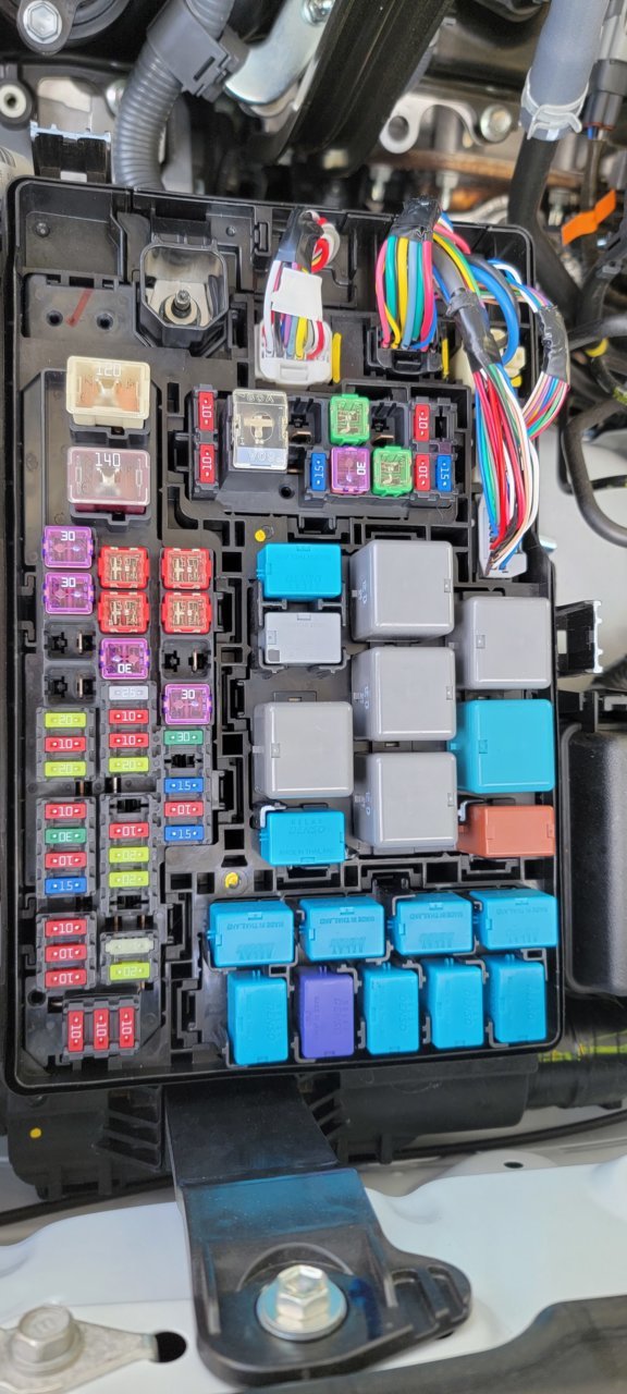

    No, your Raptor lights will stay on all the time. The DRL fuse has power on all the time and the BCM (Body Control Module) controls a relay to apply power to the DRL. The other challenge, IF you tie into the DRL wires directly, this can be an issue too because there are (2) feeds for the DRL. 1 of them feeds the DRL during the daytime when there is no call for headlights via the dash sensor, and the other feeds them in the evening when the sensor calls for the headlights. I tied into the peach wire as suggested and this worked in the evening, BUT, if you want them on during the daytime they will not illuminate. So, I gave up, and tied them to the radio fuse under the dash vs. the hood so that ANYTIME the key is on they come on. Secondly, I was not comfortable connecting the Add a Fuse to any of the fuses for the ECM, Injectors, etc. due to the fact that if this cheap china made add a fuse fails, you end up off the side of the road. NO THANKS.

    I found the open tabs were all constant power. Most the keyed fuses are found in the fuse bus under the drivers footwell

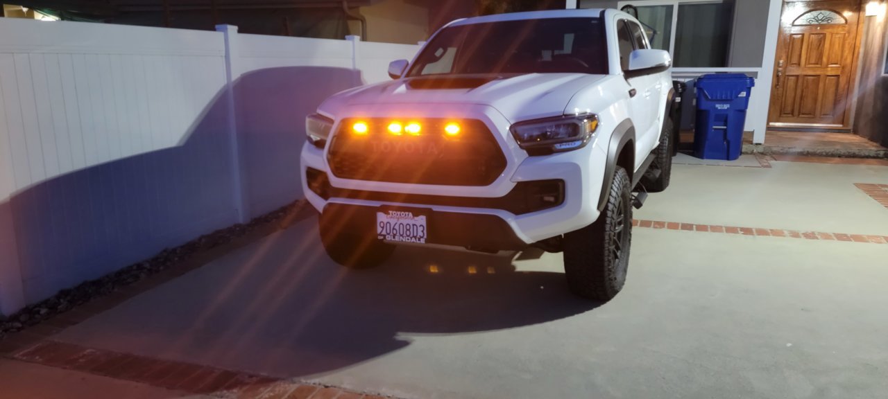

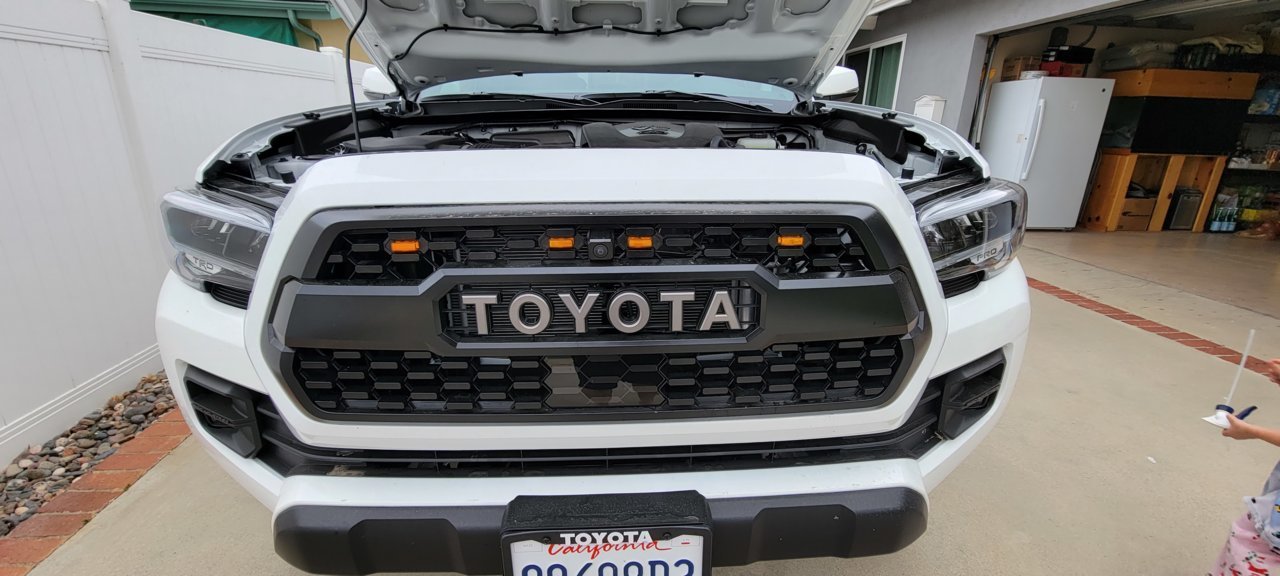

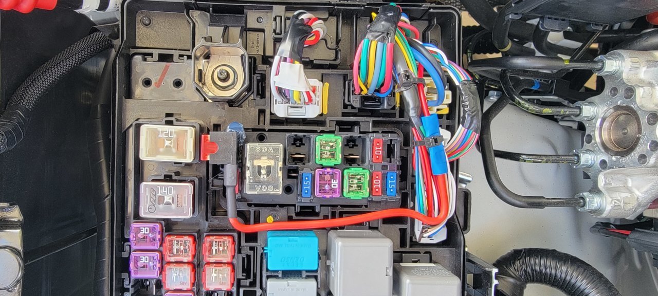

    Finally got around to wiring these lights in. I used a small amount of RTV to help hold the Add a fuse from moving.
