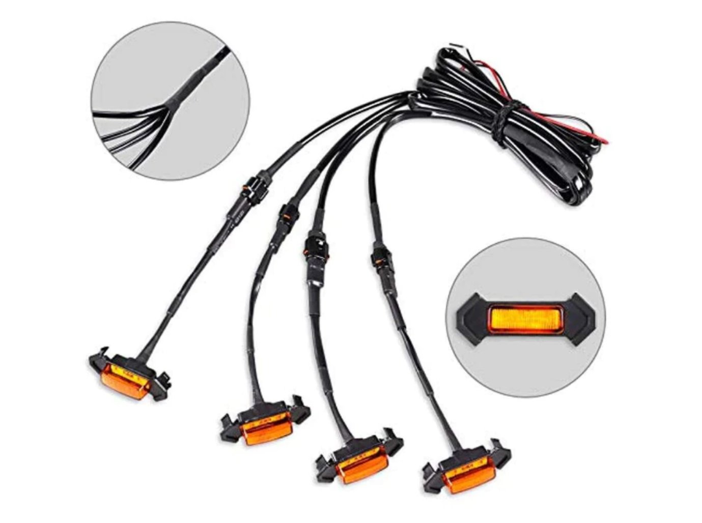

    Hi Dave, got some Raptor light from CALIRAISED for my Taco TRD Pro 2023..so it has the Fuse tap in the fuse box etc etc. From time to time the Raptor lights are staying on so I have to start the truck and stop and relock...a Pain. So thinking about getting the following from you: https://fbchs.square.site/product/tacoma-2020-led-t-harness-with-grille-lights/8...Will it work for CALIRAISED using the connector or will I have to cut and splice the CALIRAIDED connector....and how about getting the Raptor LED to also work with Hightbeam ? Anything plug and play ? Finally last question, I'm also putting in the THE BRITE BOX ANYTIME...will it interfere ?

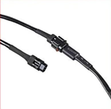

    Post a photo of the connector showing wire colors and I’ll let you know.
    led T grille light feed is on anytime stalk is not off so unaffected by high beam.

    That’s a different connector.

    Actually I have my answer....I need to splice and cut....the 4 LEDs have a connector each...going from 4 into a 4 to 1 octopus...at the other end there is 1 fuse box (RED) and a free black wire...I need to order a kit I guess.

    Yeah, that’s how my eBay lights come. The R4T stuff has a connector that is plug and play.

    So I guess I will be all good with this:
    Tacoma 2020 - 2023 LED T Harness with grille lights

    Yes, and some wire strippers and a heat gun or hair dryer or tessa tape or loom or ...
