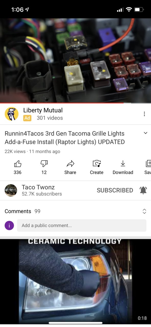

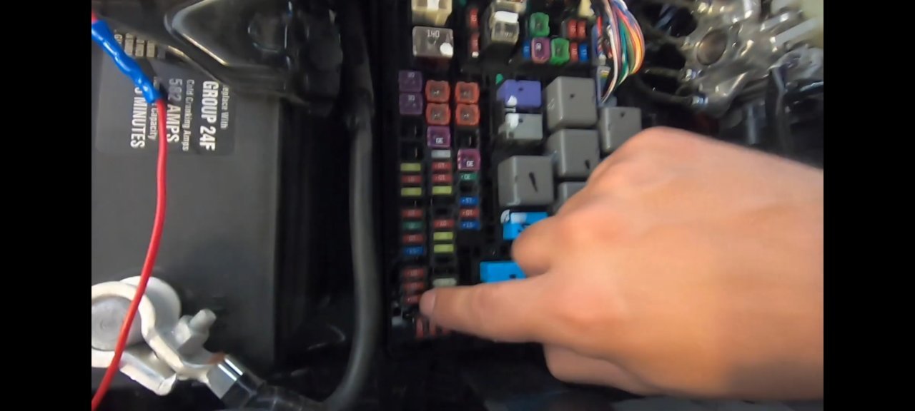

    I watch the tacotwonz video for the install and they ran it to injector fuse so it would always be on when the car was on. I started to run it it where Jesse did. E091969A-0EDD-4967-BAD6-D8B25CEDC14F.jpg

    Most tutorials for these say you want this specific 10amp fuse. They will turn on with headlights. I don't think I'd want them running all the time anyway with DRLs but that's just me

    Watch the Jesse Rizo video for install. Looks totally different location wise

    The battery was dead. I went ahead and moved the lights to the fuse that Jesse recommends and everything is working properly now. For everyone who commented trying to help thank you!
