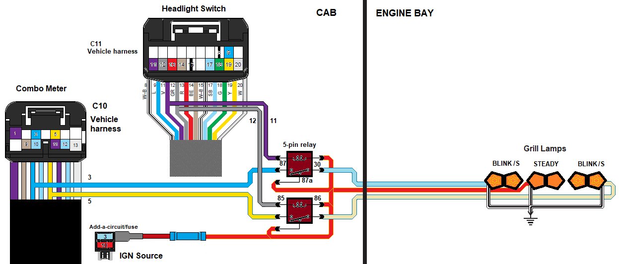

    Had a 3rd gen get behind me today rockin raptor lights in an aftermarket grill. Low and behold when he turned on his directional the raptor lights started flashing is this a thing? Or did he just tie into the wrong wire and nobody told him yet?
  2. Sep 5, 2021 at 5:43 PM
    crashnburn80
    crashnburn80 Vehicle Design Engineer
    Jun 6, 2015
    #156893
    14,751
    Kirkland, WA
    2003 DCSB TRD OR
    Tapped the wrong wire.
  3. Sep 5, 2021 at 5:50 PM
    caribe makaira
    caribe makaira Well-Known Member
    Feb 13, 2011
    #51121
    11,767
    Caribbean, Puerto Rico
    05 PreRunner TRD Offroad AutoTrans
    Hood Struts, My version Fogs always ON, Map & Overhead Light Mod,
    An added Relay can be used to select between DRL illumination and Turn Signal Flash.
