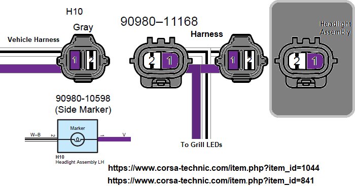

    Hey guys, I'm not sure if anyone has already asked this. (I feel like someone already did, but I can't find the thread lol)
    It's a quick question anyway.
    "Which fuse is it for the amber side marker lights?" (3rd Gen)
    I would like my raptor-style lights to illuminate whenever the side marker lights are on (which I believe is every setting: Parking, DRL, low beam, high beam. Please correct me)
    Thanks in advance!

    Tail fuse in cab fuse box.

    Just posted on the yesterday...i used INJ 10amp with an add a fuse...on all the time.

    No cut add lights to circuit.

    So you're suggesting splicing into the side marker wires?
    I'd prefer the add-a-fuse option if possible . . .

    Thanks, so that's also for the side markers, right?
    Does anyone know where this fuse is??
