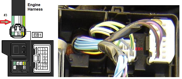

    That's the wire I was going to suggest if the OP had the V6, it is powered by the IG1 No2 Fuse 10A in the interior fuse box.
    I would suggest using a fuse no larger than 3 amp on your tap if you go the route of using that wire.
