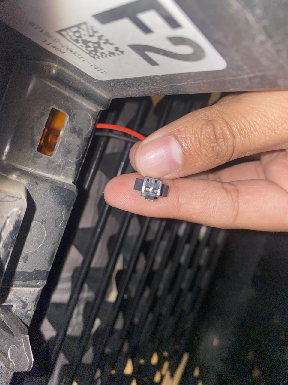

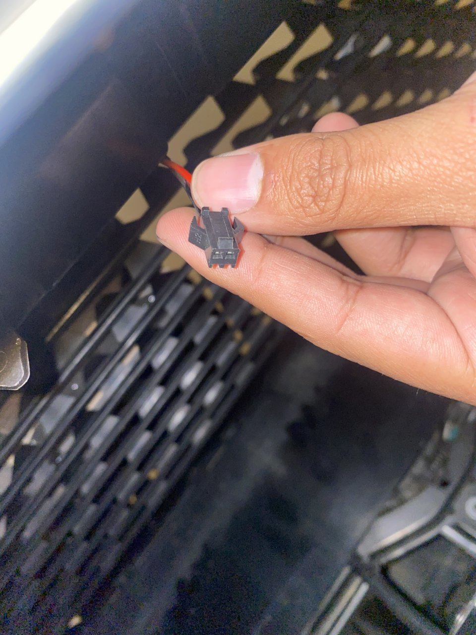

    So I got a grill with some raptor lights already included. Thing is I can’t find the wiring for the lights and I bought one from Amazon but it’s the incorrect one. Anyone know where I can find the correct wiring for these lights?? I’m absolutely lost.

    If red is power and black is ground, cut the end off and do an add a fuse to the low beam.

    I did add a fuse to INJ so they're always on when truck is running.

    That is a JST connector. (not weather proof)
