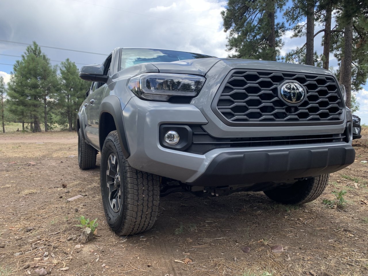

    Has anyone installed raptor lights on their 2020 Tacoma Off-road?
    I would like to keep the original grille but add raptor lights.
    this is the grille I’m referring to:

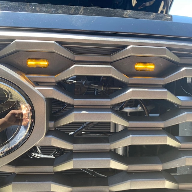

    This link should help you with that https://www.etsy.com/listing/792672398. The 3d printed bezels should fit the 2020 grill. You still need to buy the raptor lights separately though fyi.

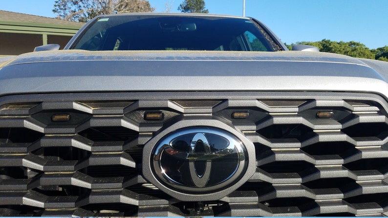

    No problem! Yeah I have the same ones on my truck. They fit well. There is also a youtube video featuring the install of the bezels/lights. You can view that video here https://youtu.be/UPOu653MIng
    Side note - You might not want to ground the negative wire the way he did...if I remember correctly he just wrapped it around the ground haha

    Yeah I did but I still had to buy the negative ring terminal (purchased at autozone) to ground the wire and I also purchased a 'low profile' 5 fuse amp(purchased off Amazon) to connect to the fuse box. The set does come with a 5 fuse amp but it gets in the way in where I wanted to placed the add-a-fuse.

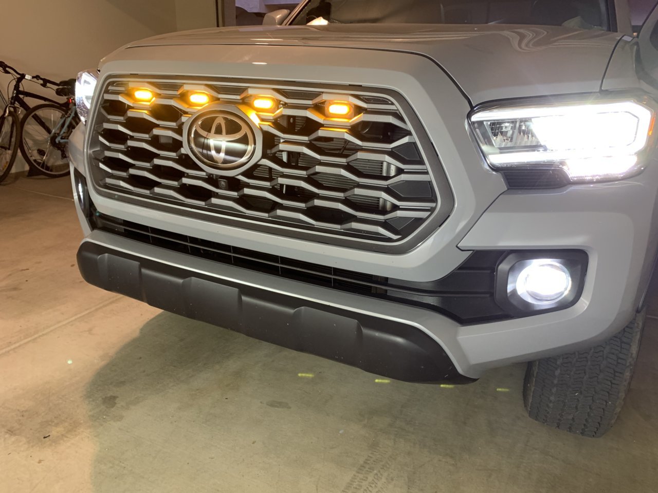

    Just finished installing them.

    :thumbsup: I like it!
