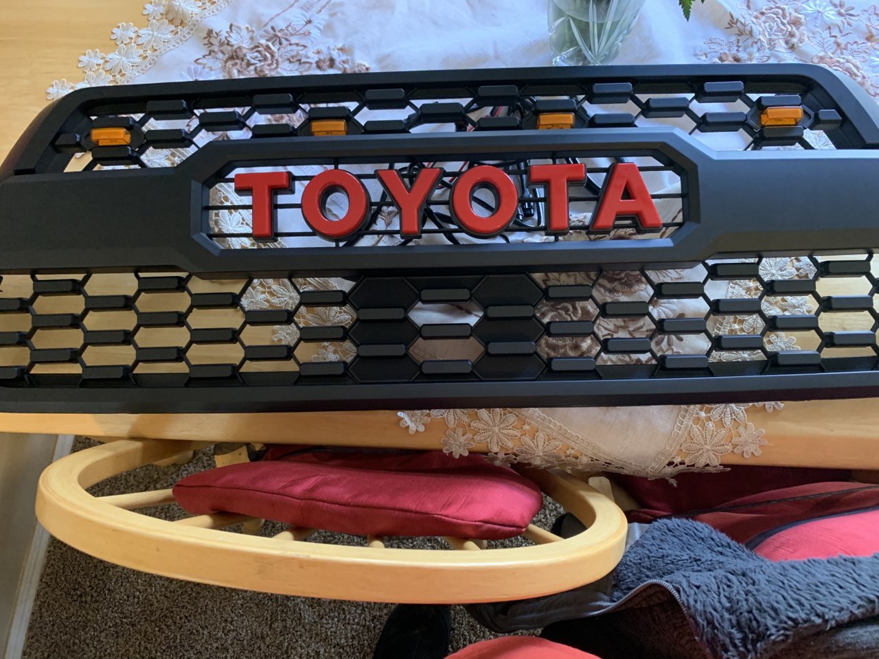

    So, I bought the pro grill:

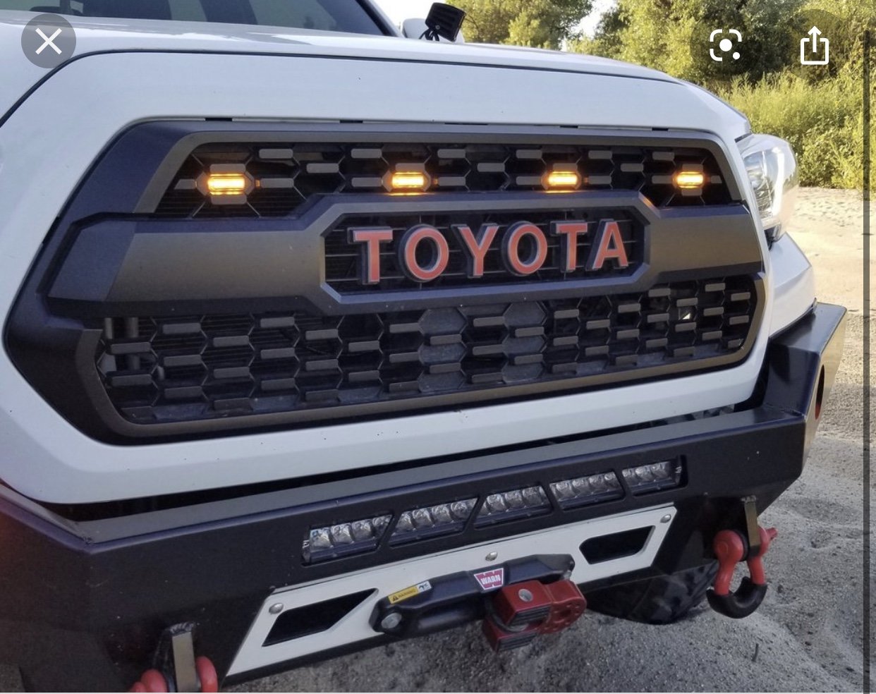

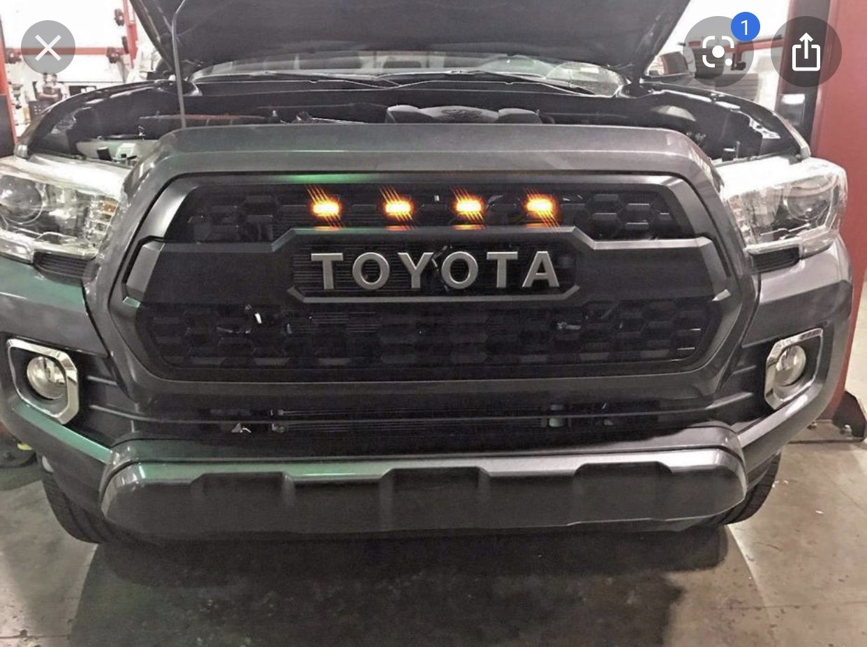

    But, the two outer lights won’t push in far enough to clip. I see there are a couple of options for placement:
    I definitely prefer the spread out look.
    Anyone run into this? Any insights? Thanks!

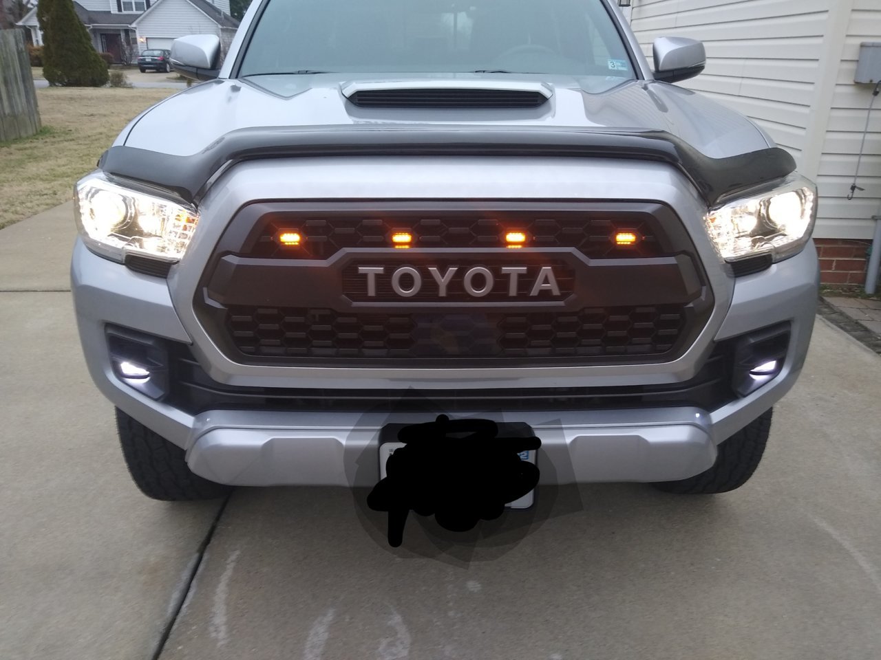

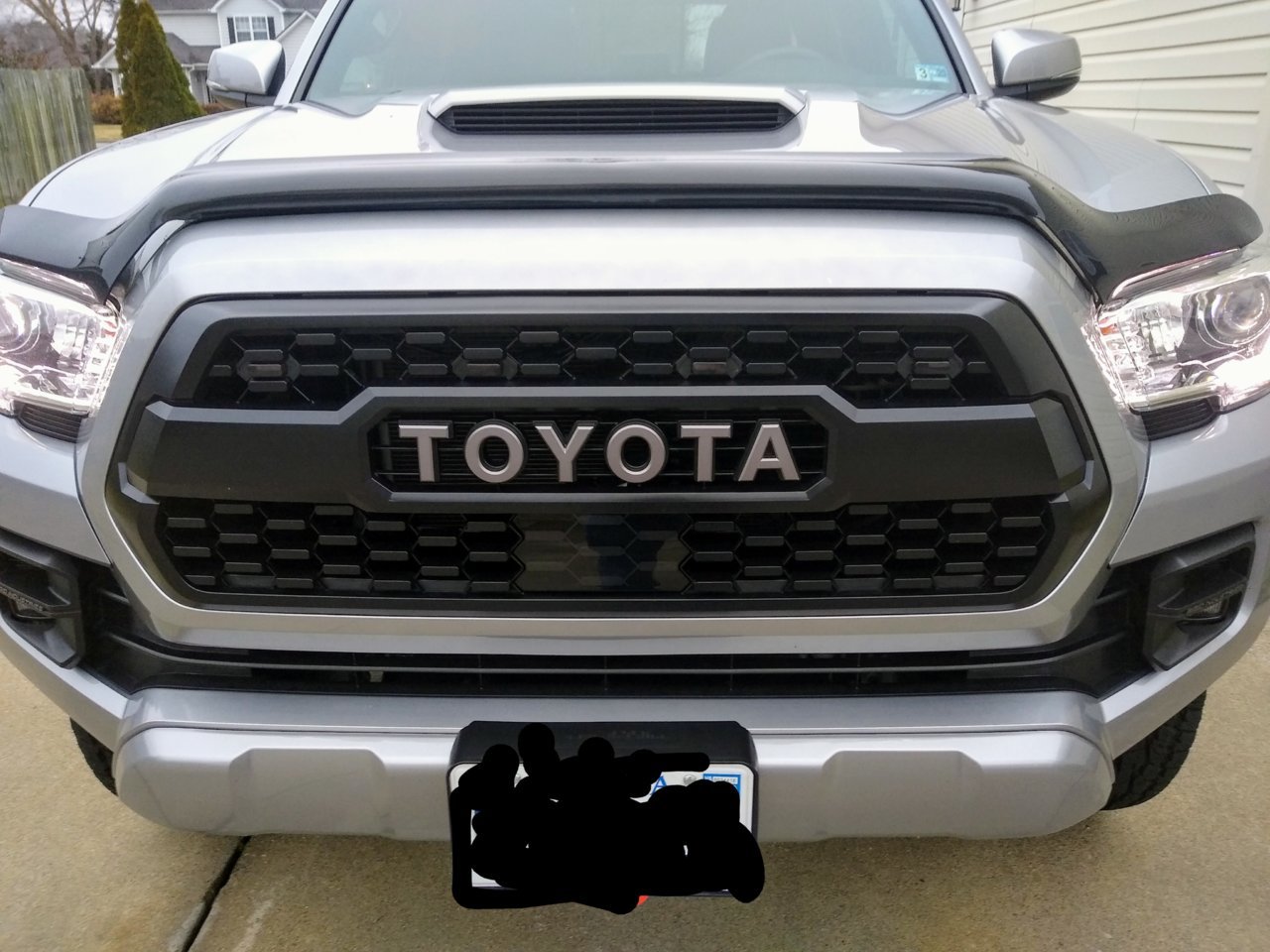

    Sand down the ends of the lights on some 1500 grit sandpaper. Test fit then sand more if needed. It doesn't take much.IMG_20200103_161041164_MP~2.jpg IMG_20200103_161057031~2.jpg

    Love the red color match to compliment your shackles

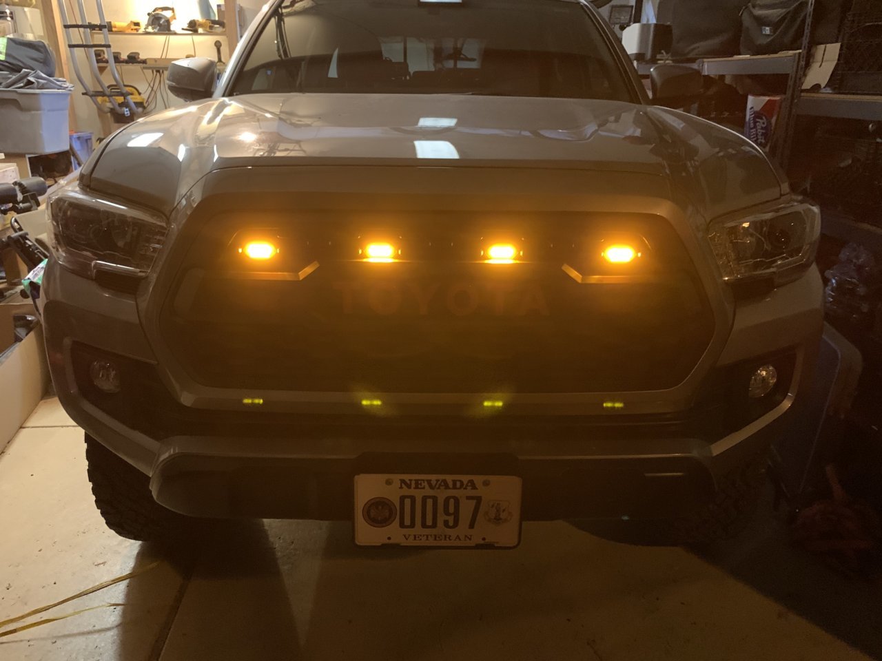

    Install done! Love the TRD PRO grill and lights!! Grill is hard to see as it is 10PM, but the red lettering of the TOYOTA will match my red shackles if my front bumper is ever delivered.

    Looking good. Definitely like the 4 lights best!
