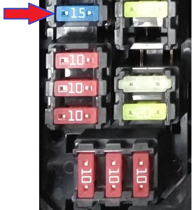

    Installed raptor lights yesterday when I went to start my truck this morning I had no crack boosted it and disconnected the lights and so far no issues. Had it wired into h-lp oh-lo

    You mean this fuse?
    If YES, then it's always "HOT".

    Those are the low beam fuses. They should not be energized unless you turn the headlight stalk to On after all is off.

    3rd generation Tacomas have a relay in the cabin, so caribe makaira is right. It’s always hot. There are 3, 10 amp fuses you can tap from. I used an add a fuse on one of the three bellow the 15 amp you tapped from
