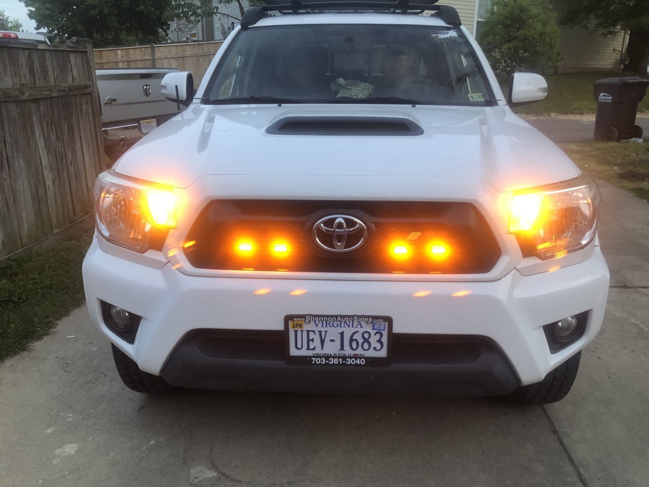

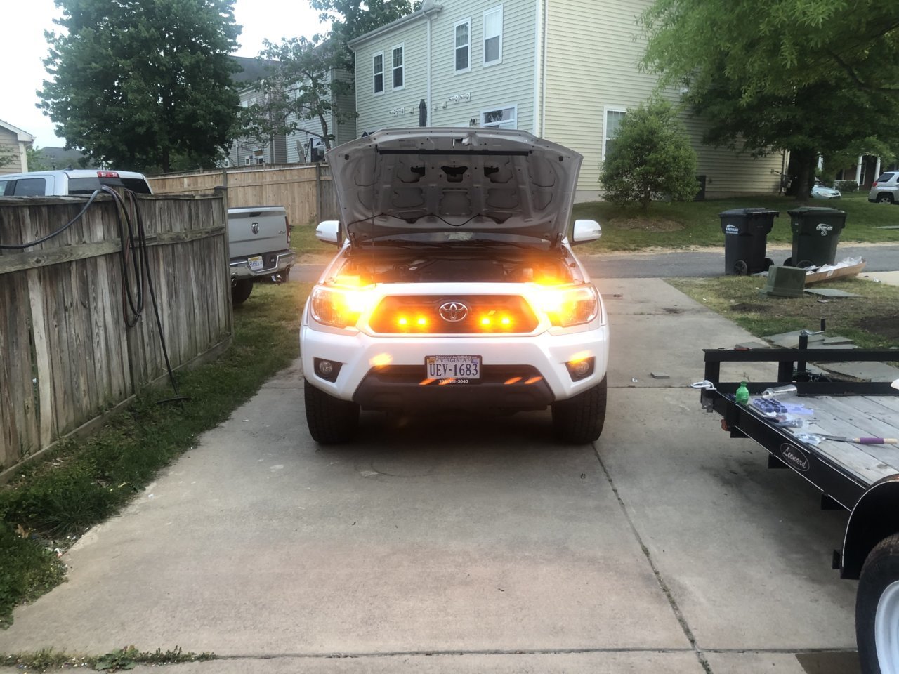

    I installed some raptor lights this evening. I didn’t want to swap my grill out so I used zip ties to hold’em in place. I do have them wired into the engine compartment fuse box. How did everyone else wire there’s in????? I watched a few, hint, very few YouTube videos on where, but I’m still curious on how everyone else did. 178961F5-BF86-4CC9-9084-87D1F9A5C6DE.jpg843DC1E6-7E09-4CF9-87D2-F0F460044C0B.jpg

    Tied the power wire to the parking light power so they come on at accessory or headlights and normal ground. That way they aren’t on all the time
