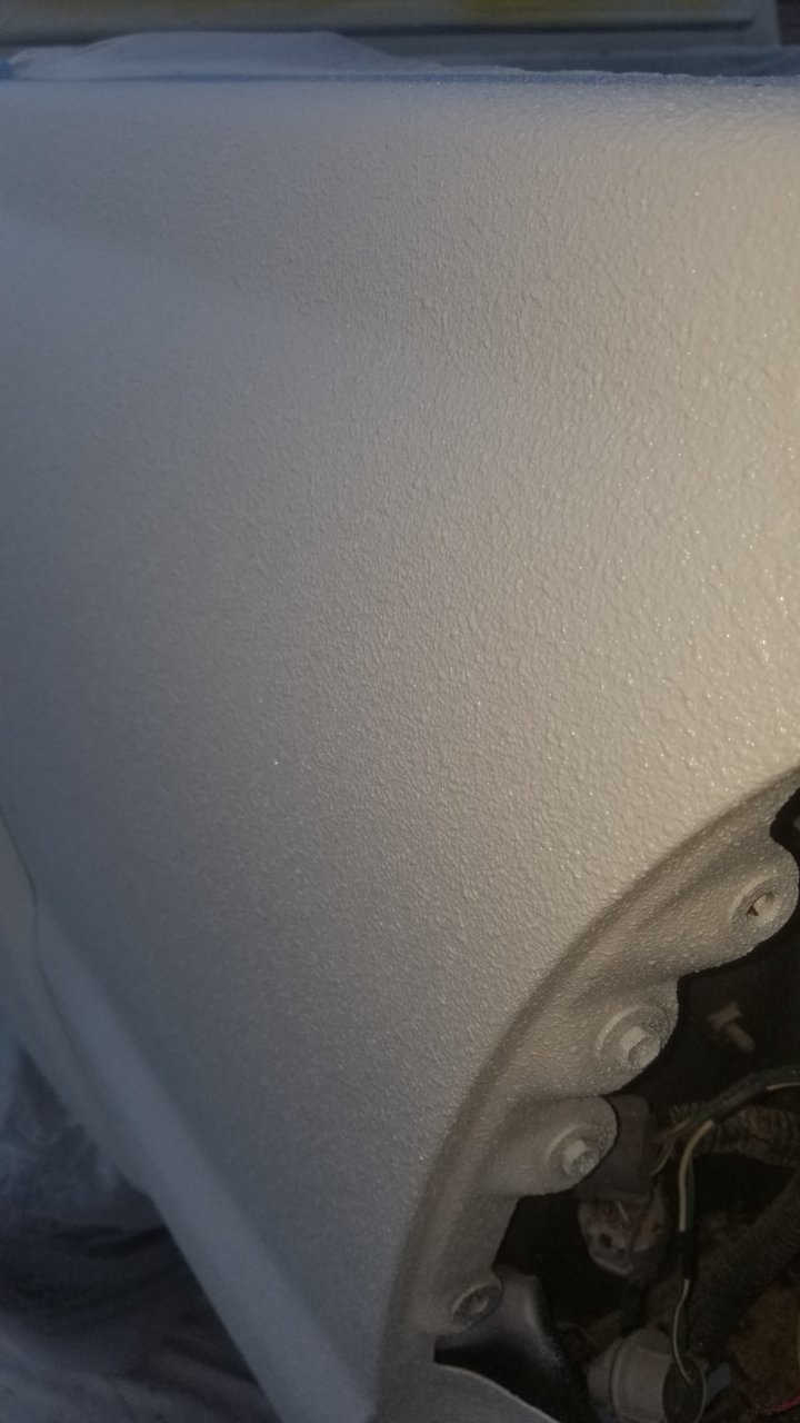

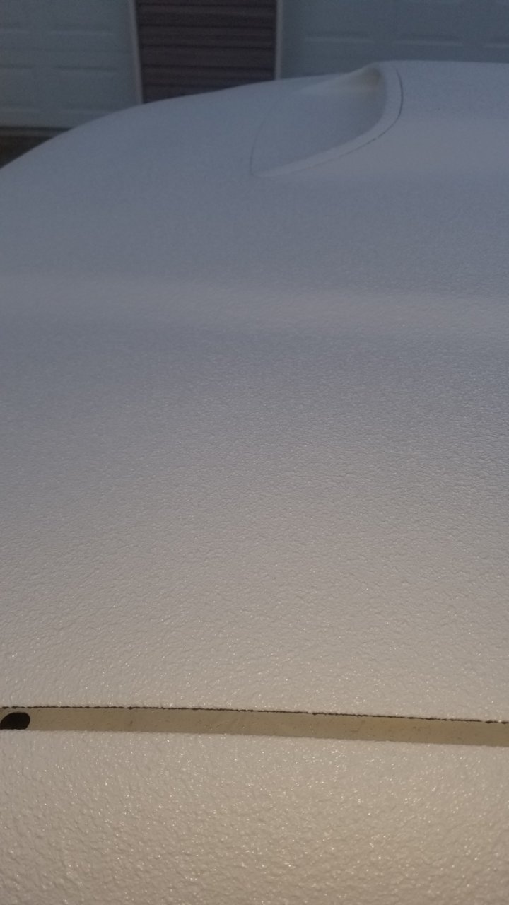

    I just wanted to write this up because when I decided to paint my truck with tintable bedliner, I couldn't always find the info I wanted.
    So my taco had tons of hail damage. I wanted an affordable somewhat unique way to fix it.
    After doing some research I settled on UPOL Raptor Liner.
    It offered the simplest process with what appeared to be the best results.
    I bought 10 liters of the tintable version that came with spray gun and hardener.
    I purchased a quart of 2K urethane based acrylic arctic white tint. I mixed 9mil of the tint in each bottle to get the color I wanted.
    The actual painting only took about an hour, but it took me and my loving supportive girlfriend 5 days of prep work before hand.
    The whole project cost me around $400 bucks. The most expensive part was the bedliner kit. I paid $170 for 6 bottles and the gun, and $116 for another 4 bottles.

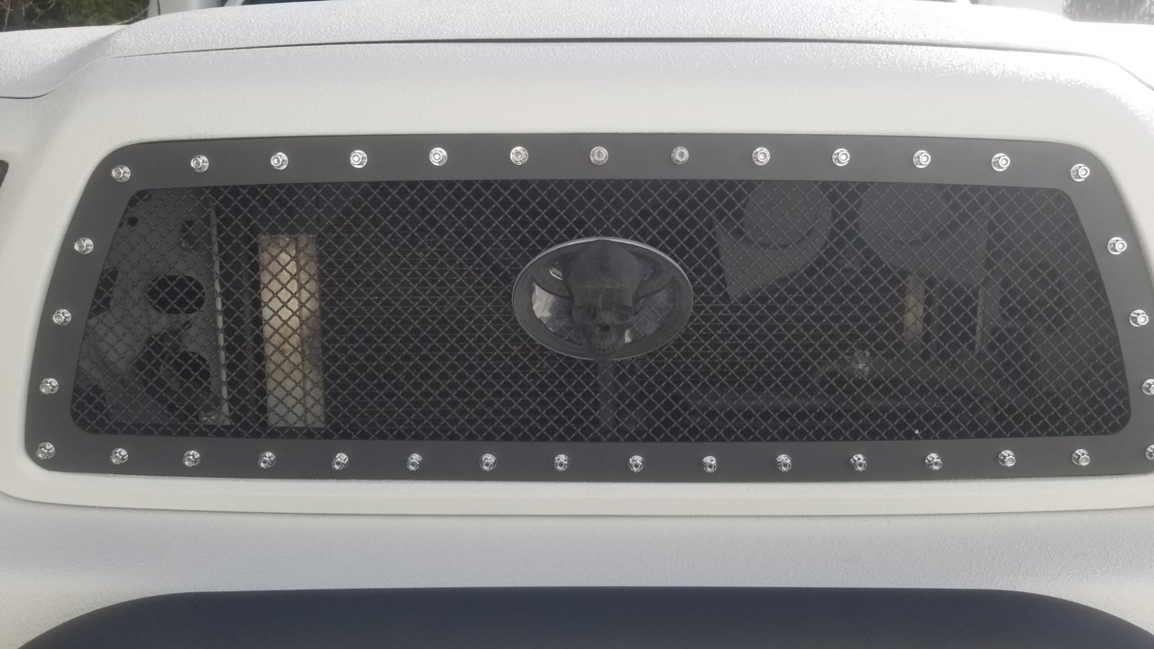

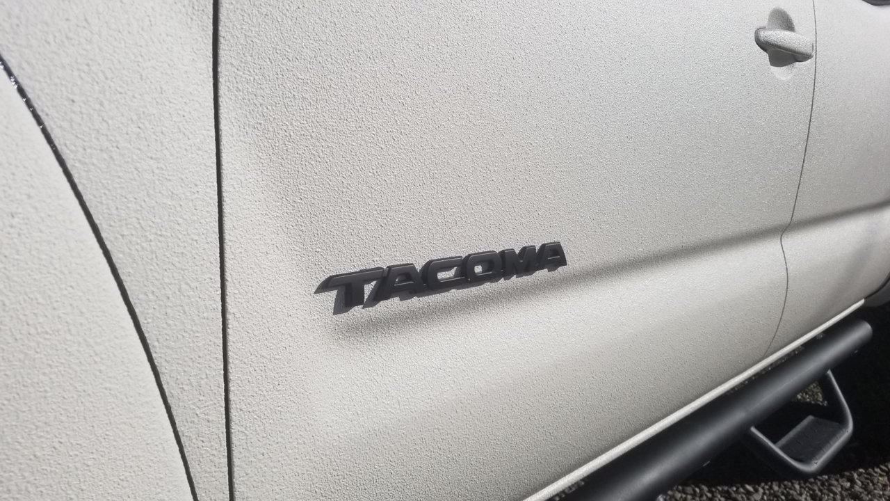

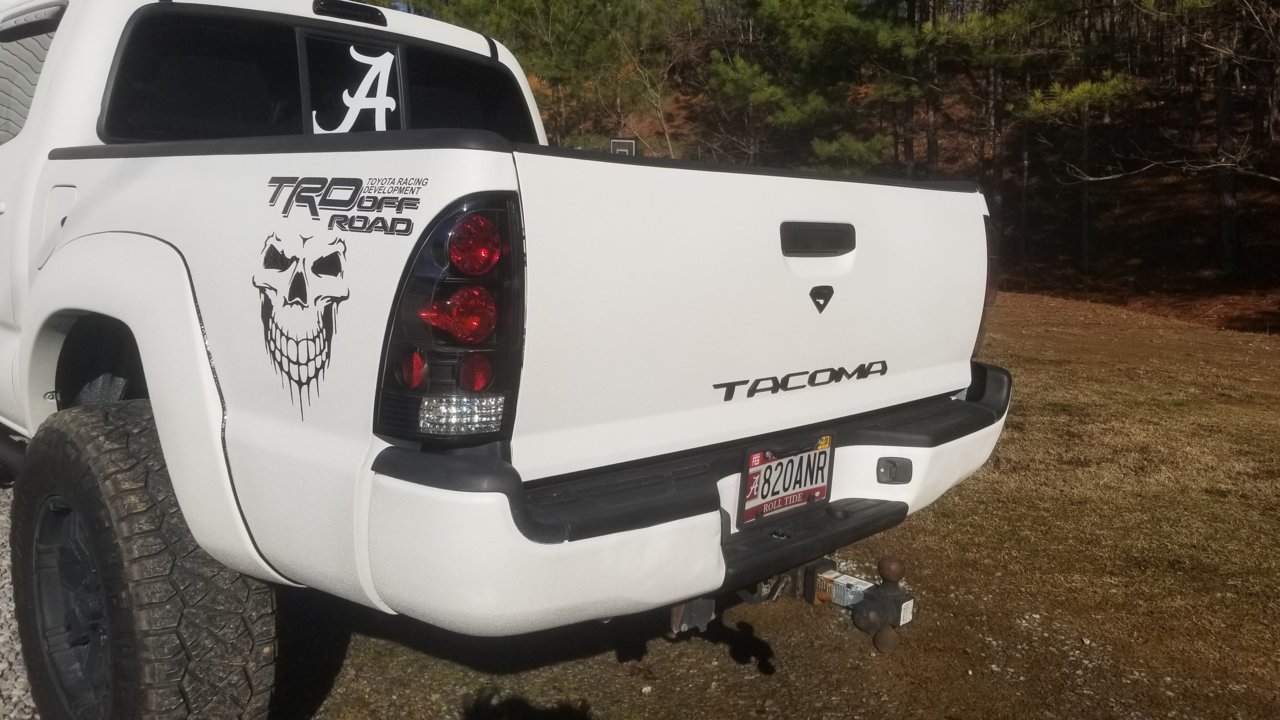

    Below are some pics I took right after painting.
    20191230_163355.jpg 20191230_163331.jpg 20191230_163429.jpg 20191230_163448.jpg 20191230_163509.jpg
    The most important part is prep work.
    Making sure the clear coat is roughed up(I used 120 grit sand paper) and any exposed metal, or bondo needs primer. Any spots that cannot be reached to sand or and plastic or chrome parts needs to have the UPOL adhesion promoter sprayed on it first.
    Once the sanding and priming is complete, use a wax and grease removing cleaner. I purchased some from AutoZone that worked great.
    I know this is not a detailed build instruction but I can answer any questions that yall might have.
