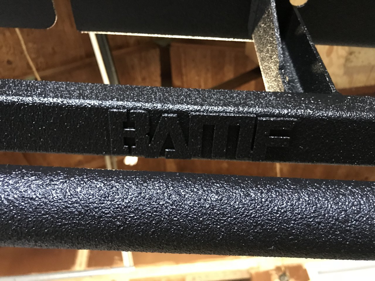

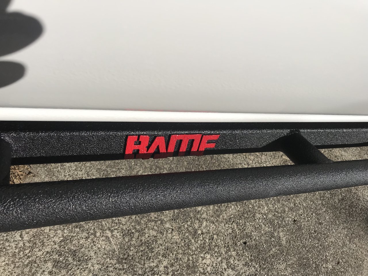

    I recently sprayed raptor liner on some BAMF sliders, turned out awesome. I intend to paint the face of the logo red, has anyone tried painting on top of raptor liner. One option could be buying a liter of tintable, and just mixing enough for a couple logos. Though I think it would be cheaper if I knew a compatible paint. I sent Upol and email, but haven’t heard back, I’ll try calling tomorrow.

    If the logo is recessed or embossed for that matter, I'd probably rattle can it after masking it off - you'll be able to touch it up easily when it gets marred and you'll still have the protection of the liner underneath. Any rattle bomb should work afaik...

    Embossed, I feel like it would be difficult to tape, I went with a pretty rough texture. Was thinking of using a roller with a thinner nap and just rolling the face.

    Yep - you could get a quart of rusto enamel and an empty 1 gallon can and a roller grid.
    https://www.homedepot.com/p/1-gal-Metal-Paint-Can-Grid-RM150/100574929
    Here's a pic of my setup for some wheels I painted:

    So after a bunch of research, the cost difference between using a compatible 2k urethane paint, or tintable raptor is $75. The raptor costing with pigment about $45 and the paint, hardener, and thinner, (Thinner is apparently needed to make it rollable being that it is intended to be sprayed.) running $120. So I’ve settled on raptor. Now I need to decide color match the truck, 040 super white, or the other option I was thinking 3L5 radiant red, keeping it in the Toyota paint family, and I believe being the closest color to my TRD OR decal.

    There it is. CA6C69E5-0404-4D2D-975A-53A15DB76647.jpg9F5D3D6B-D9C5-4908-BB93-904DBA3CFA33.jpg

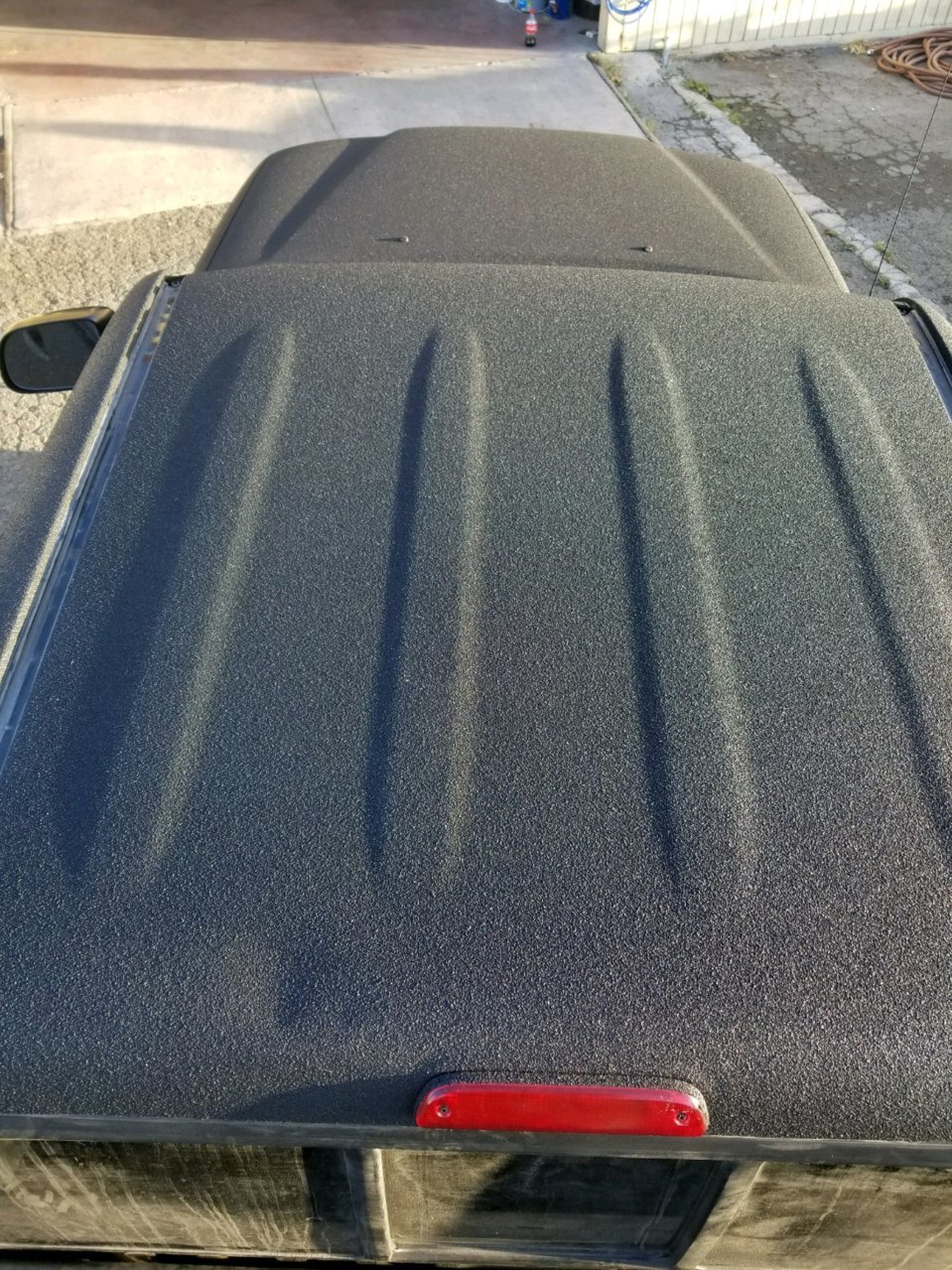

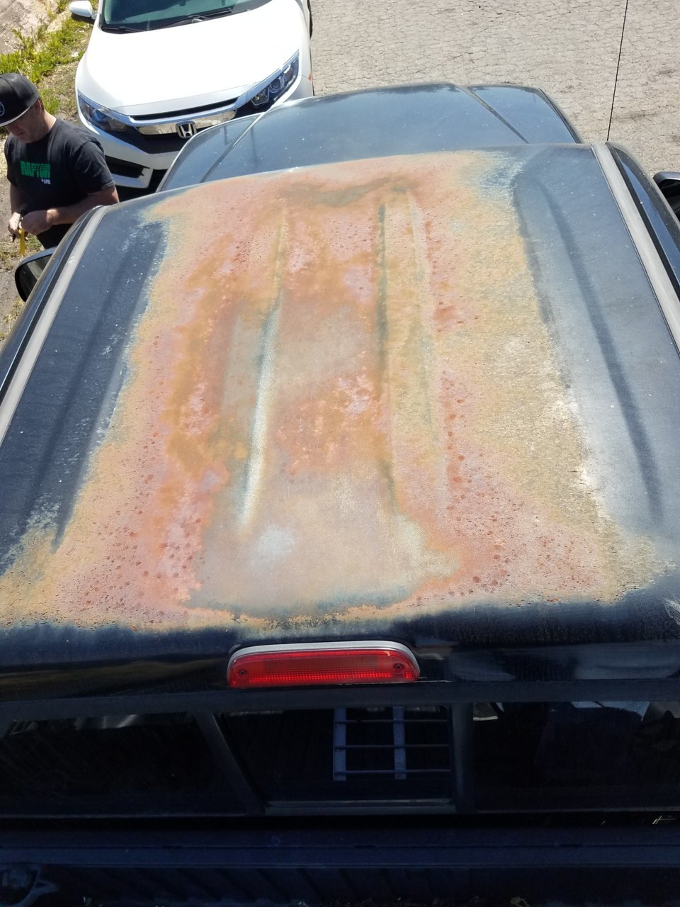

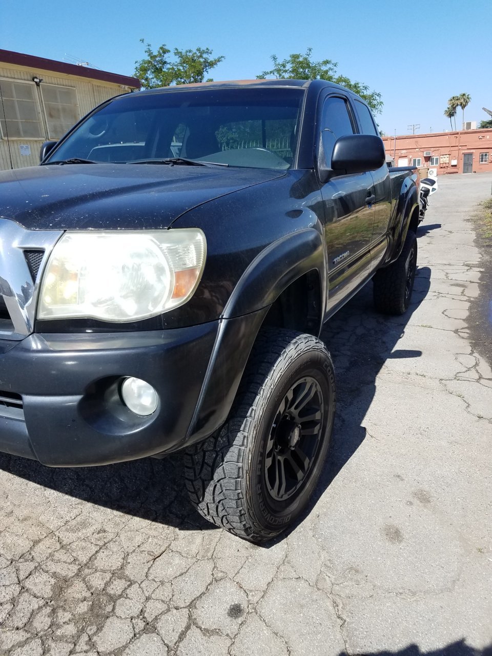

    -Maxtrac 4in lift spindles -5100's all the way around -Drilled and slotted rotors with ceramic break pads -Pro comp 1in AAL -17in wheels with a -6 offset (4.5 backspace) -1 - 10inch kicker comp (ported box)

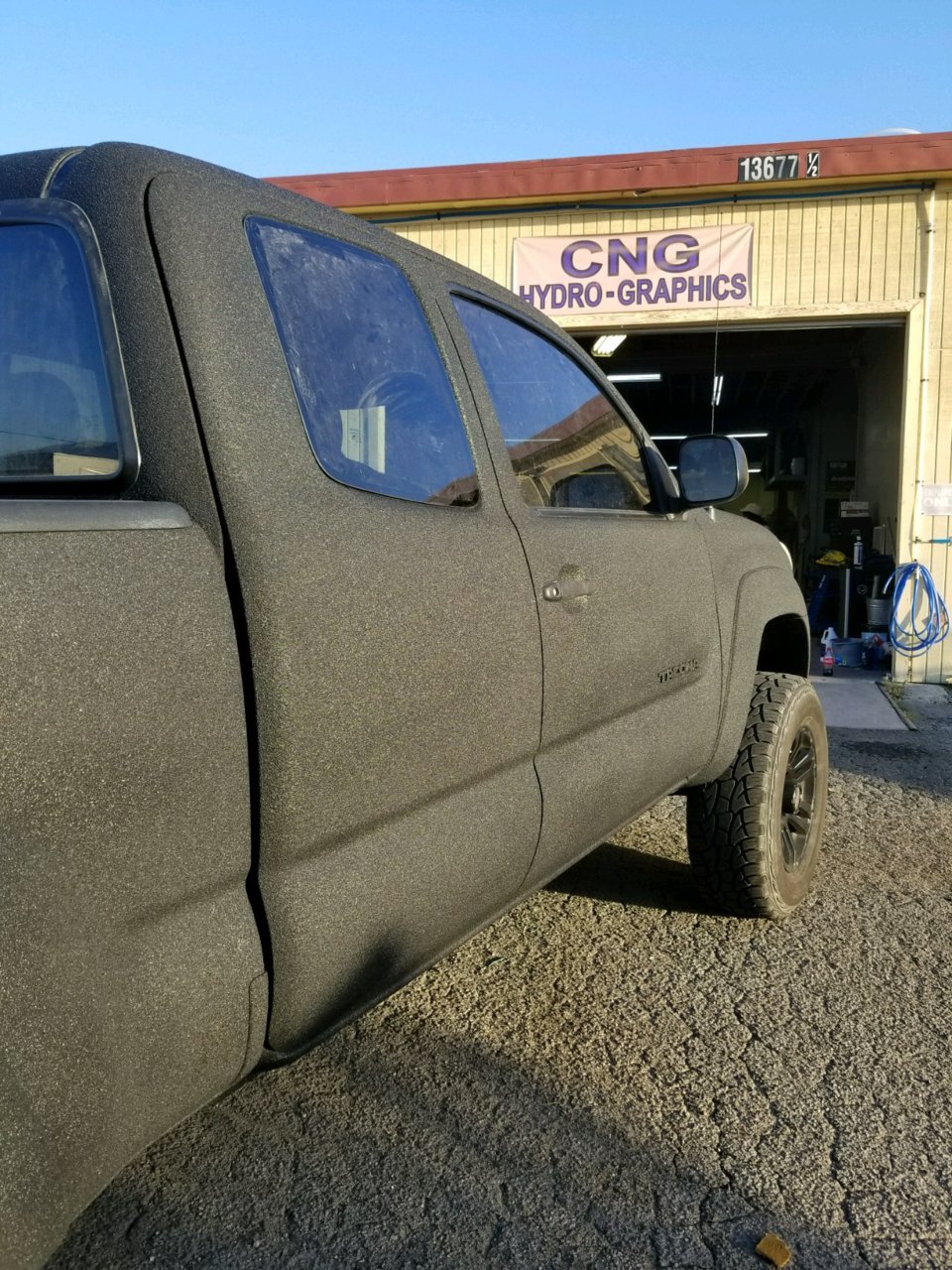

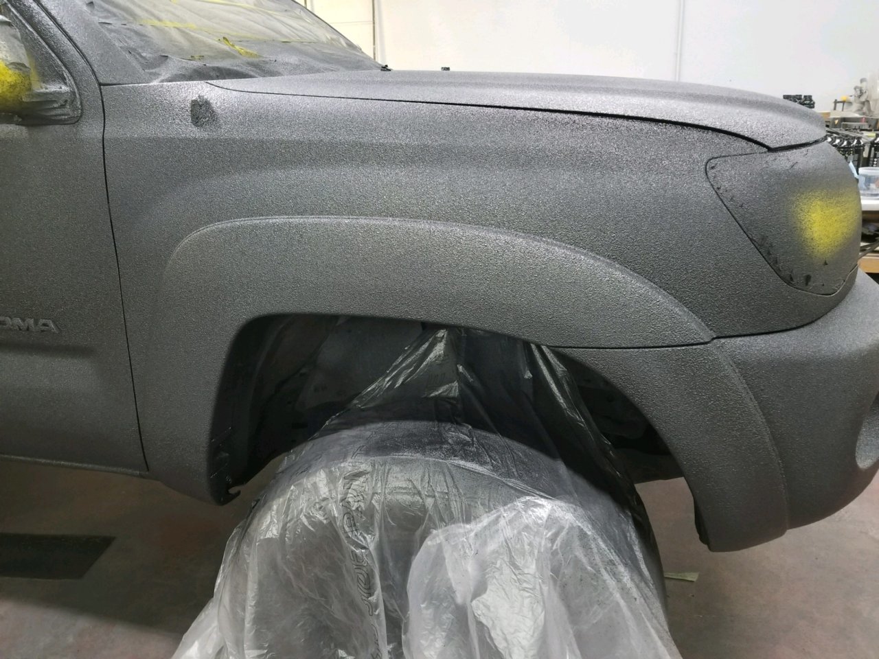

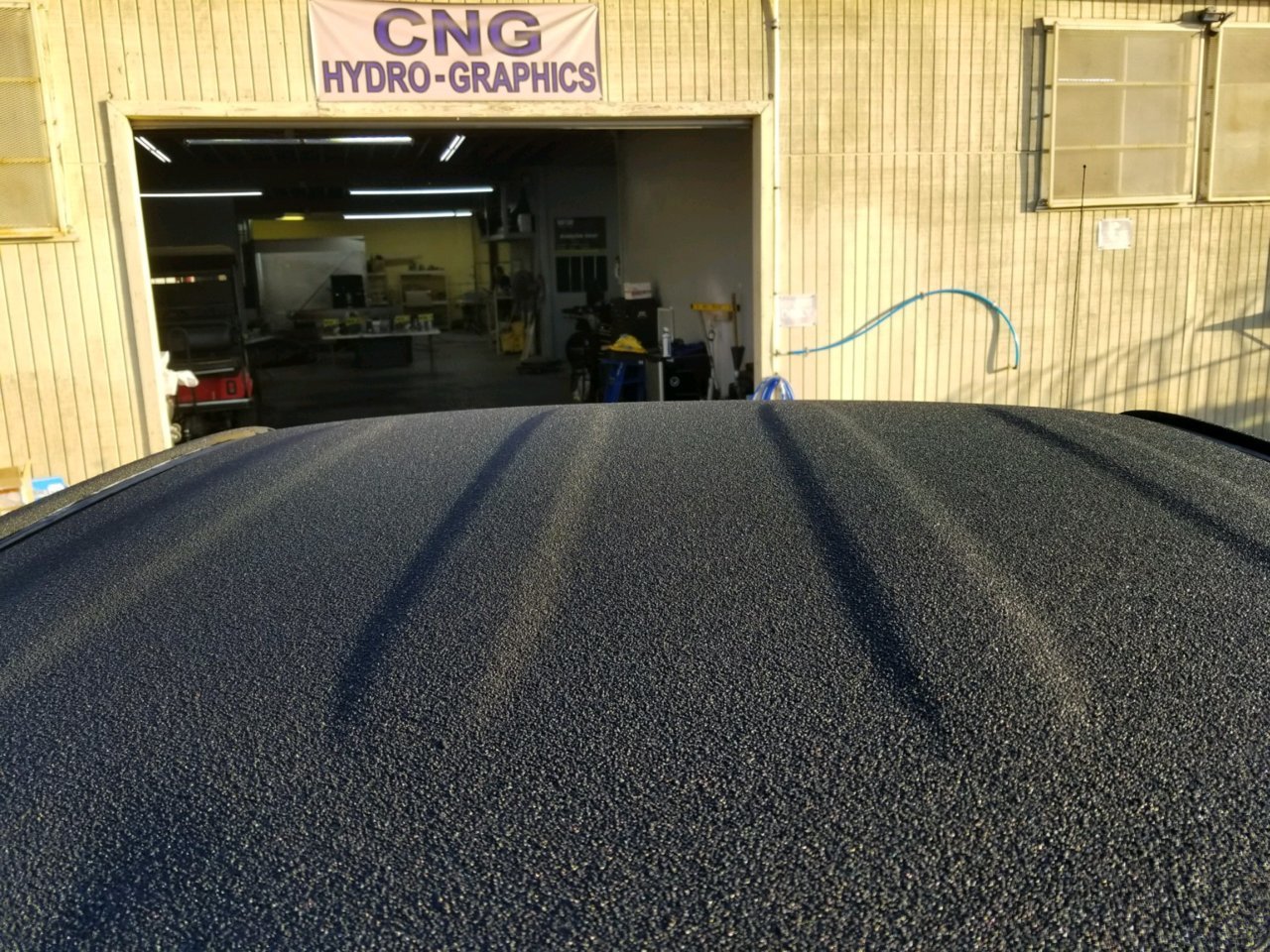

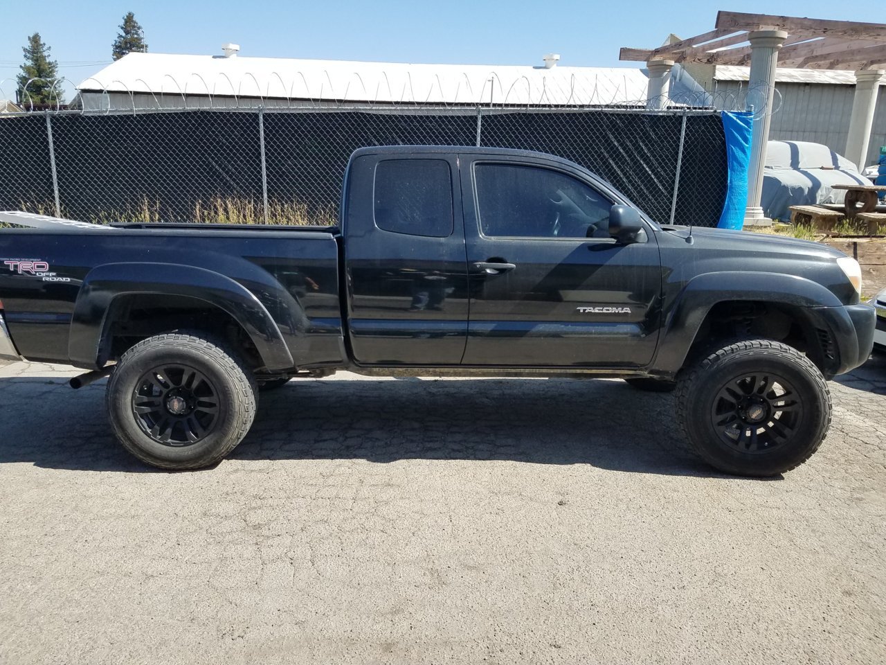

    Finally pulled the trigger on this project... got the dreaded rusty roof condidtion tacomas (2nd gens) are known for and could see hazy cloudiness coming on the hood so I knew it was about to go next.
    Before
    20180601_094626.jpg 20180601_094645.jpg 20180601_094731.jpg 20180601_101955.jpg

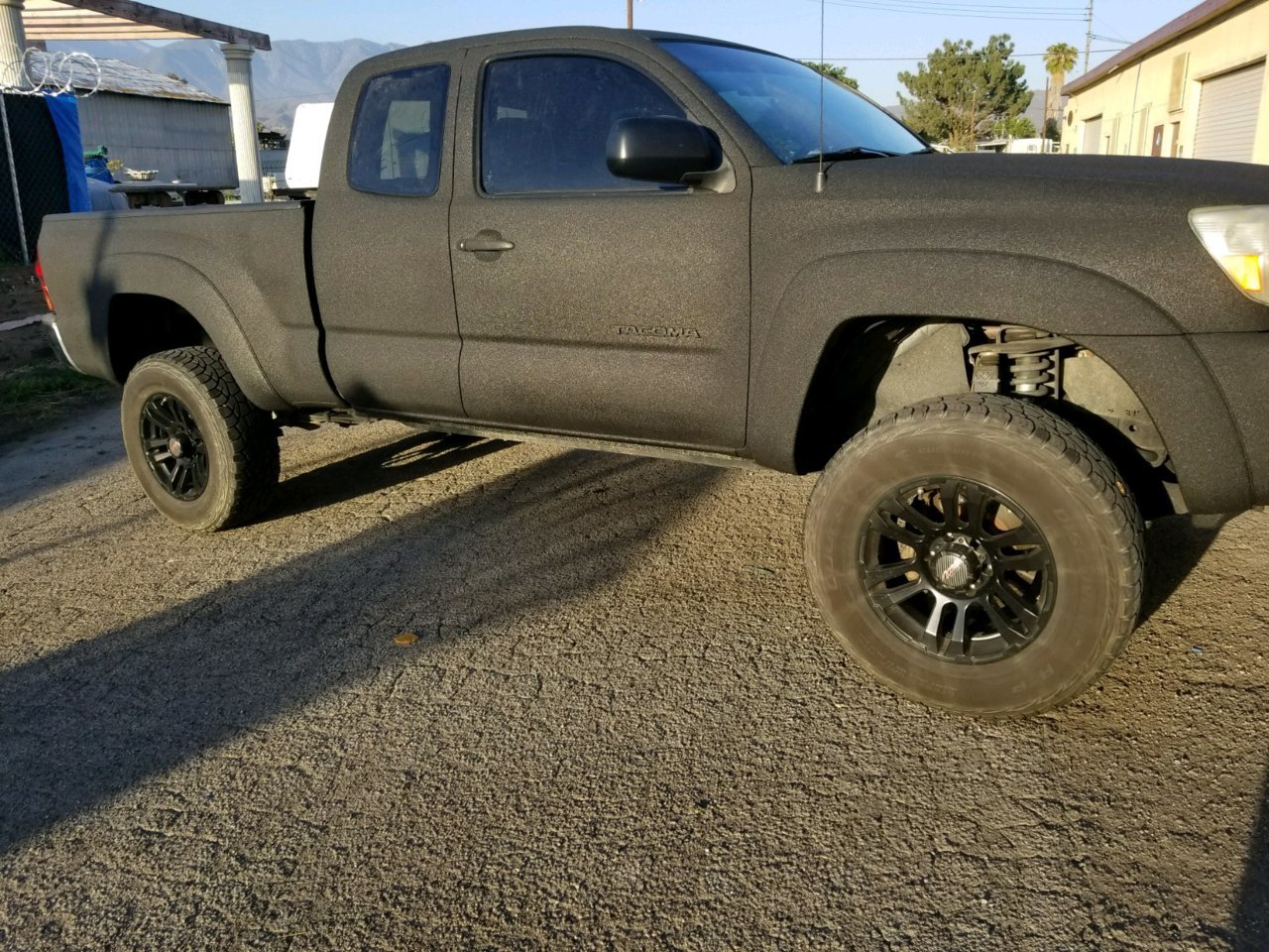

    After
    20180603_162933.jpg 20180603_162759.jpg 20180603_190305.jpg 20180603_190341.jpg 20180603_190444.jpg 20180603_190410.jpg 20180603_190327.jpg 20180603_190355.jpg

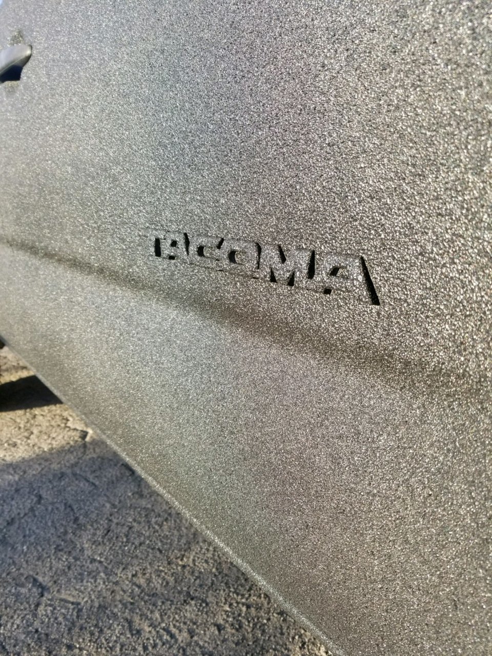

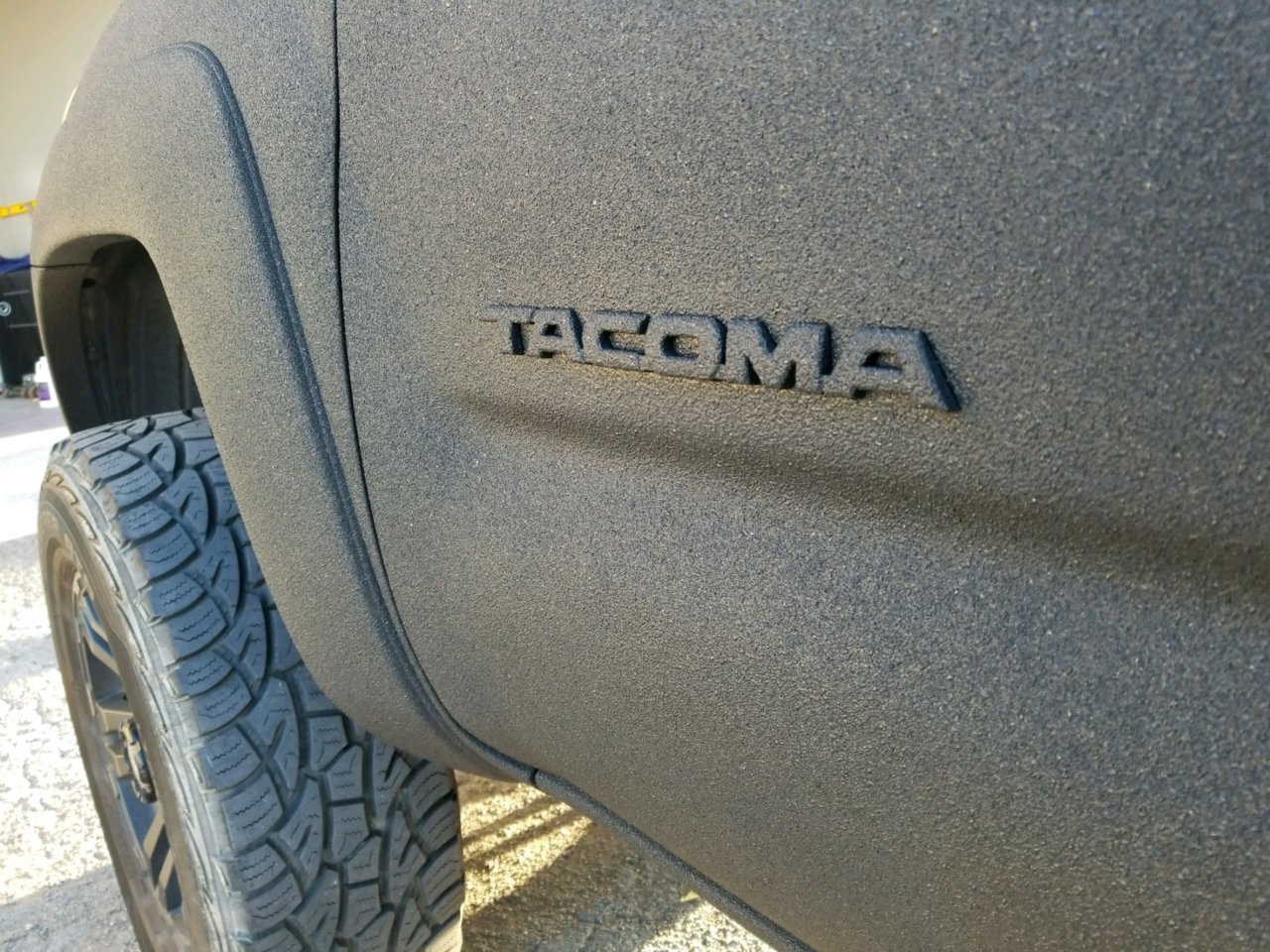

    Rust was sanded down then primered then raptor lined. Chose to keep the emblems on and have them raptor lined to give that 3D type of effect to it.

    Looks awesome. How much paint did you use?
  9. Jun 6, 2018 at 8:49 AM
    #49
    562Tacoma
    562Tacoma Well-Known Member
    Sep 21, 2009
    #23079
    68
    Southern, CA (SoCal)
    08 PreRunner TRD Off Road 4x2
    2 kits. Did some under coating spray too

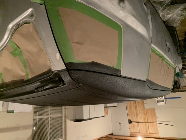

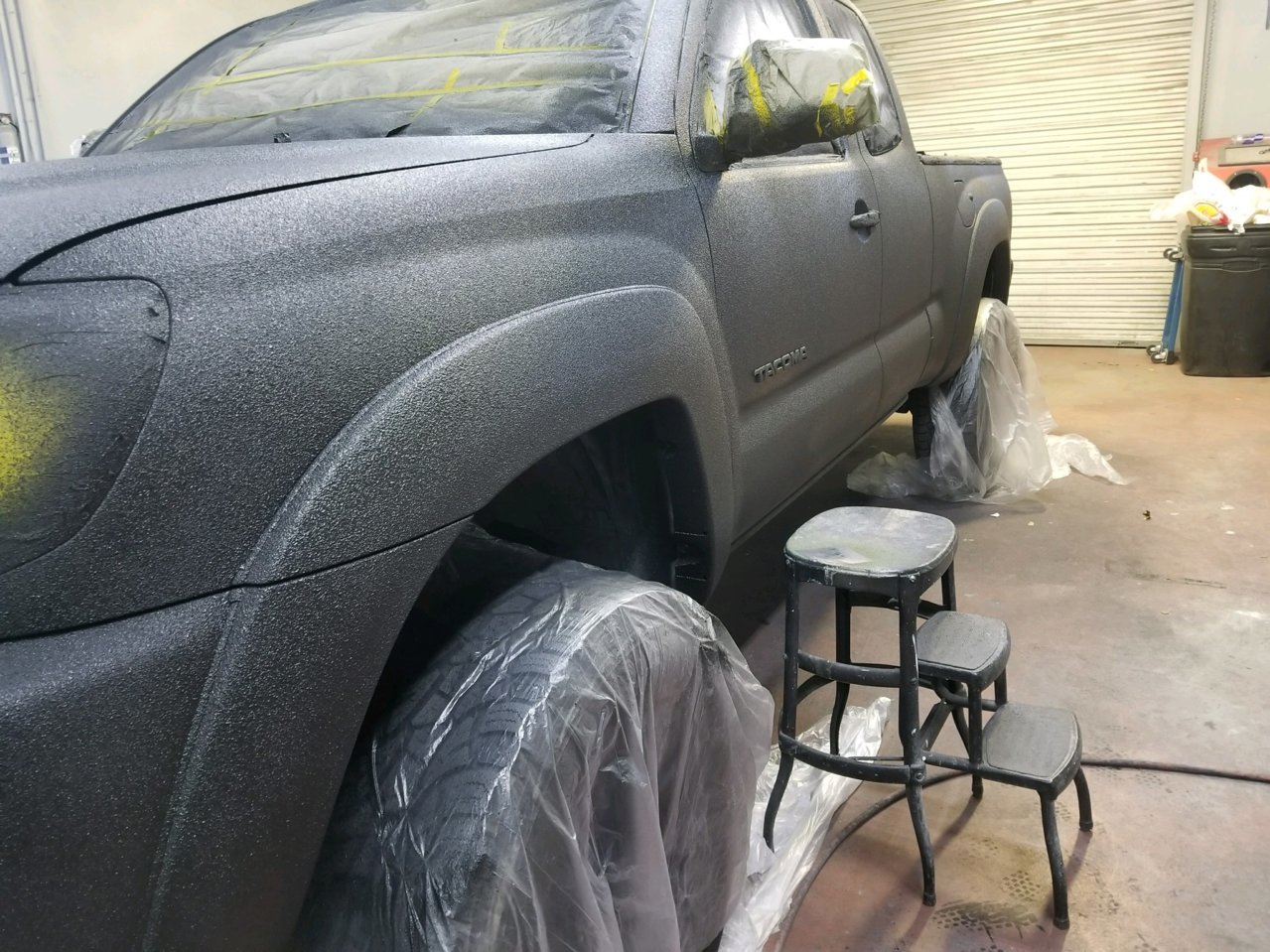

    Hey all, sorry to bring a newb question to the thread!
    So; we are raptor lining my GF’s FJ Cruiser. We just finished spraying the roof (2 coats), removed masking, bla bla bla.
    We plan on spraying the body tomorrow!
    My question is: How long does the roof have to cure before we can back-mask the roof line to prevent overspray? We are using frog tape and are incredibly impressed with the outcome thus far!!
    Idk why this is upside down...

    Is overspray of bedliner on bedliner a big deal? I think full cure is 5-7 days but seems like light use cure is 24 hours maybe???

    I assume you are asking because you are using a different color for the body. Check the manufacturer's website, I think I remember reading that you could back mask after 24 hrs. Post pics of the finished job! I won't be able to raptor my truck until late spring/early summer ('20) - need the warm weather.
