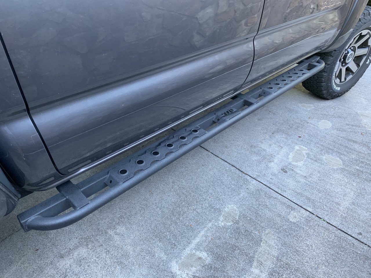

    Raptor lined my steps using the aerosol cans. I had a few heavy spots but for 8 year old steps I’m not too worried.

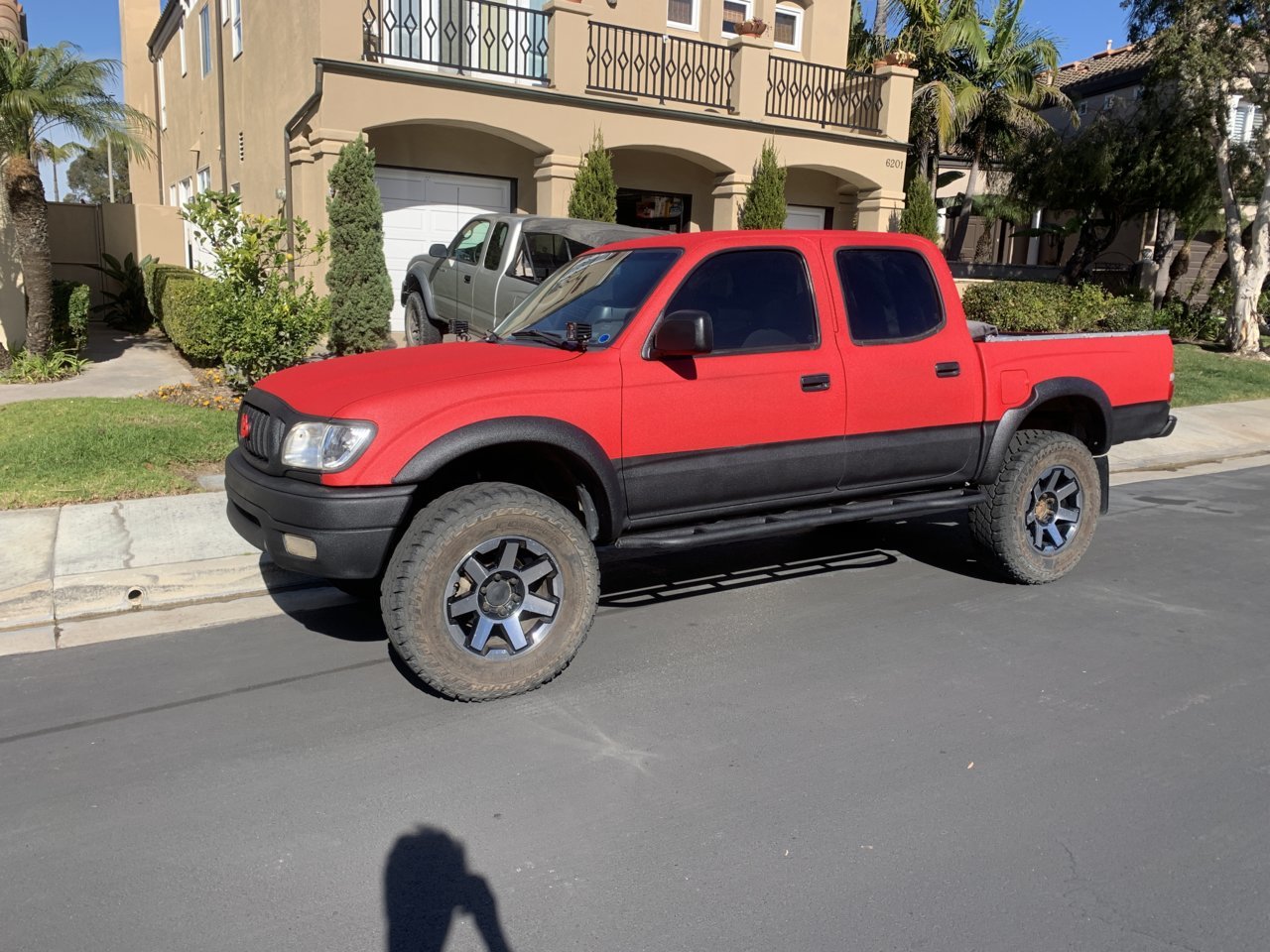

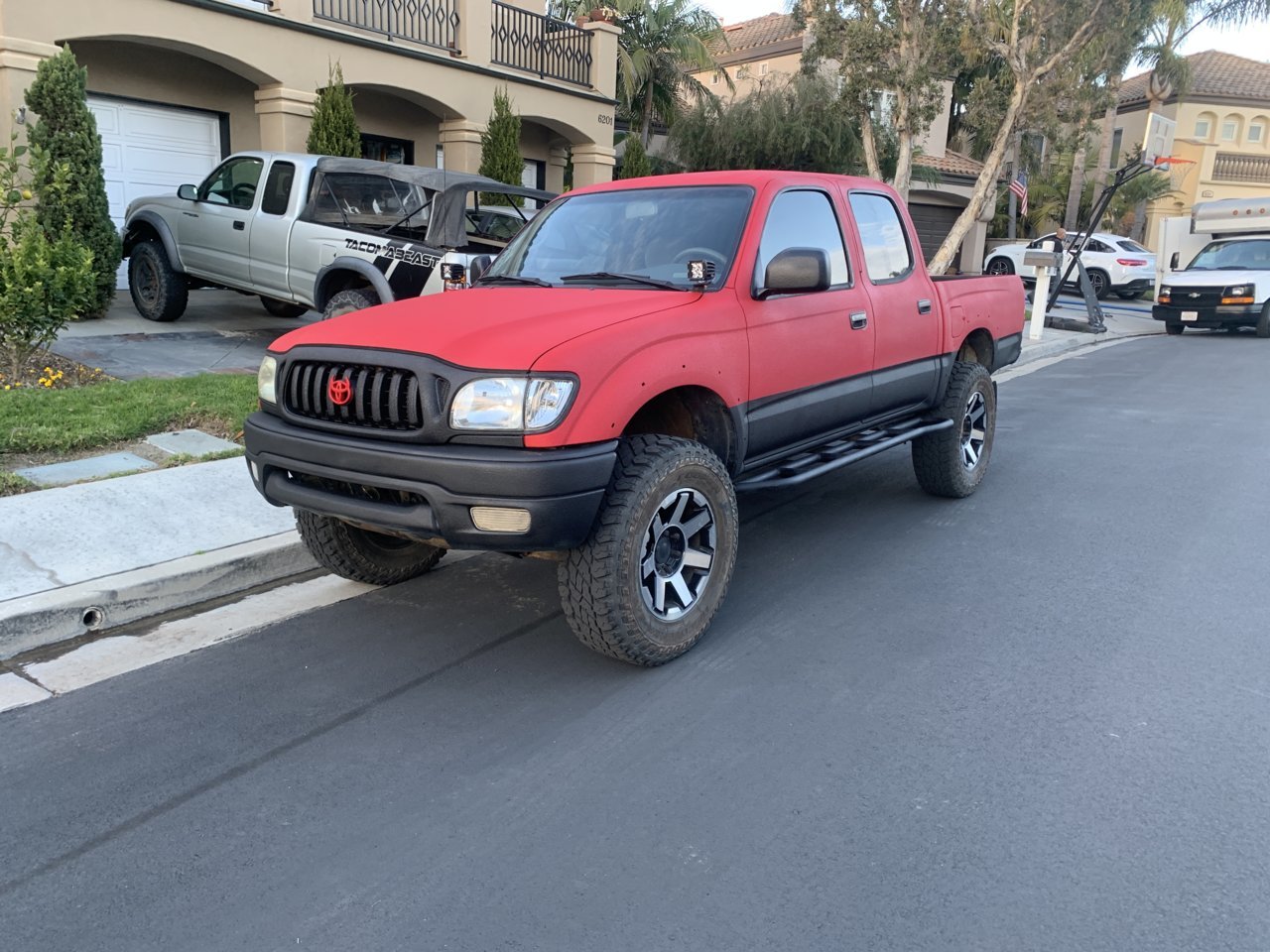

    Question for you guys that have done this before. I'm currently sanding my truck down, how aggressive do I need to get with it?
    I'm hand sanding with 150, do I need to completely kill out all of the color or just scuff up the clear?

    I just scuffed to get rid of any dead clear and/or color.

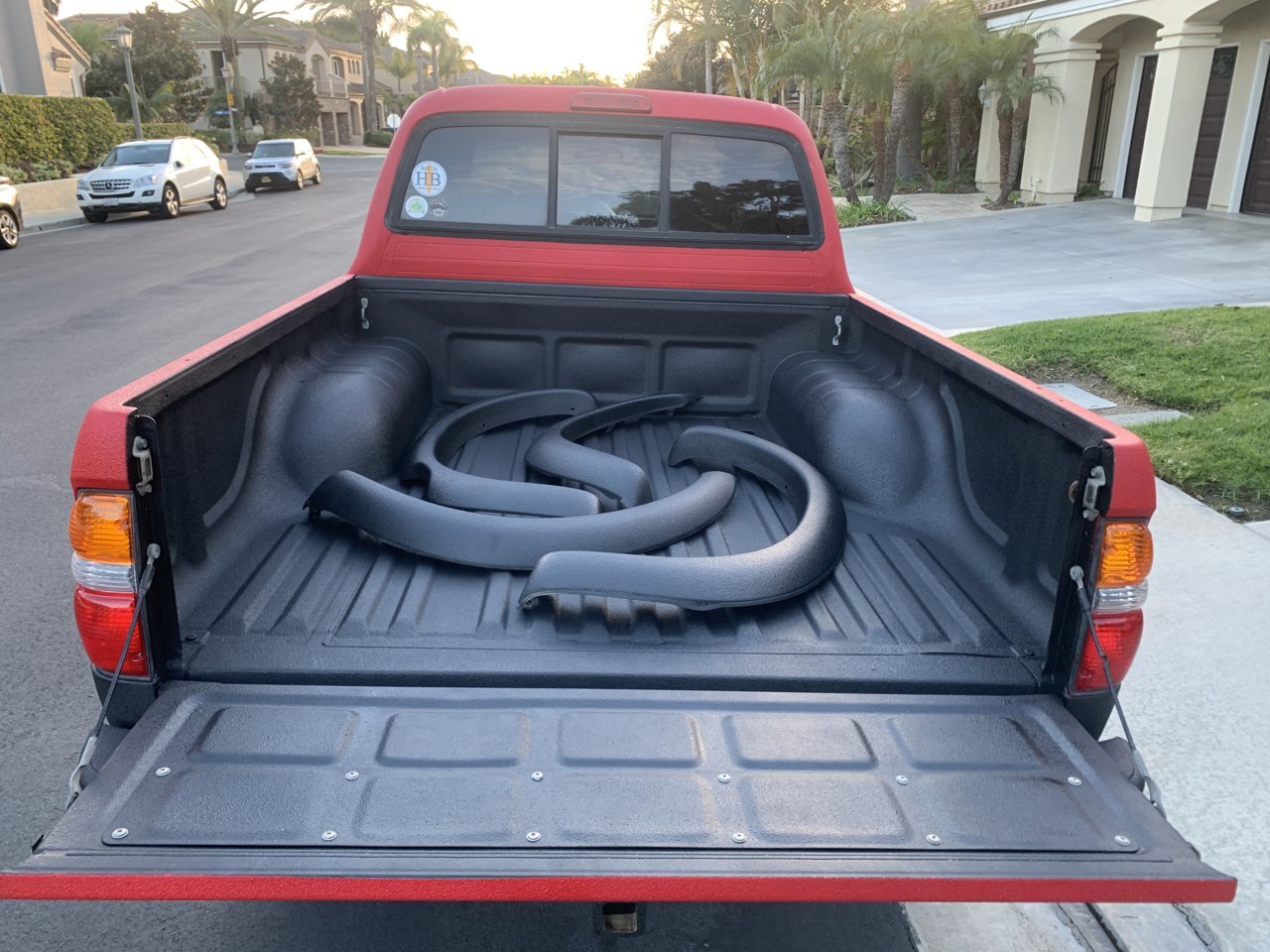

    Was hesitant to start a new thread and this seemed like the best spot…
    Can anyone shared experience with putting Raptor Liner over existing sprayed in bedliner? The 2002 Tacoma in question has had the liner since new, and structurally it has held up well, but has faded to a dull charcoal. Would like to freshen it up when I spray my fender flares and skids.
    Any input is greatly appreciated. Thanks!

    I haven’t done that before, but I have sprayed my whole truck and bed. From what I read, people who were reapplying bedliner would use a red scotch brite to rough up the liner than spray on the new one
    Also you should just go ahead and do your whole truck :cool:

    I sanded them with either 100, or 120, grit and I liberally sprayed adhesion promotor just before spraying them. Looking great so far
    https://www.amazon.com/dp/B00397POFC
    I also recommend using that promotor in the bed in hard to reach spots, helped me out a bit in the corners and under the side rails
