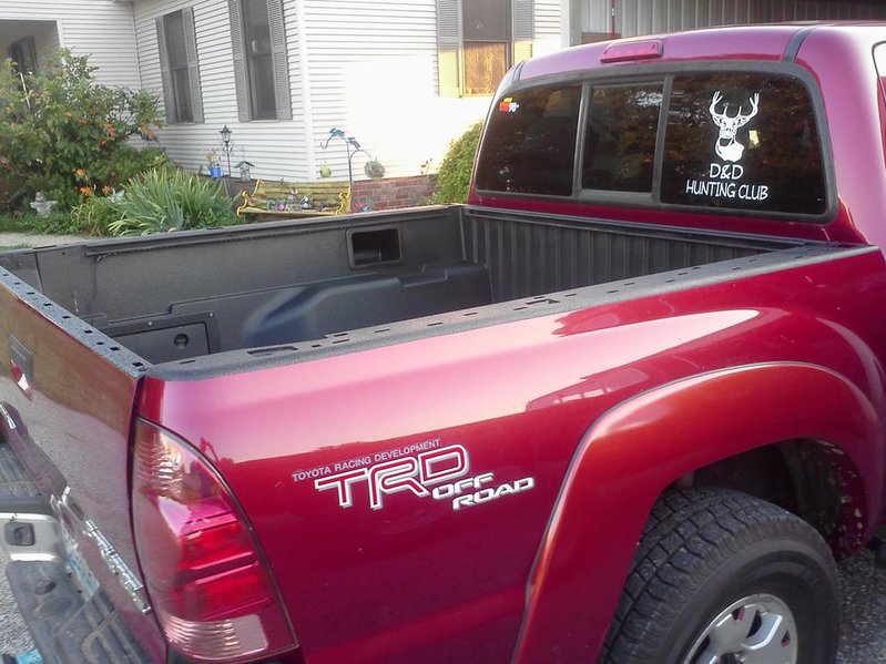

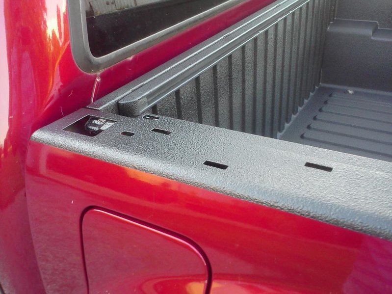

    i had a crack in the passenger front side of my bed that i did a fiberglass repair on that looked, well like i had patched it with fiberglass. my sister-in-law's father-in-law owns a paint shop and told me he sold this stuff and everyone that buys it loves it. i found a kit on ebay (4 1 liter bottles and hardener and spray gun) for $99 and free shipping. first impressions: its freakin awesome. prep time took a bit, i washed my bed like 3 times (i hadnt washed it in a year or so and there was quite a bit of mud/trash caked in there). I had sanded it when i did the fiberglass about a year ago so i just touched up some spots and wiped everything down with mineral spirits. taped and papered up every(almost good enough little over spray but it comes off with a little rubbing compound on a dirty truck) i did 2 coats(more or less) on the sides and top rail and 3 coats on the tail gate and floor of bed. spray times was about 45 mins. it says 2-3 days light use and 5 days full cure

    Looks really good!

    Looks great.

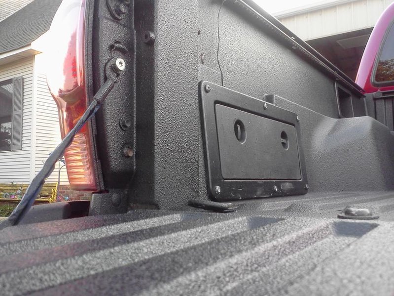

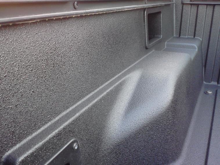

    my regulator was acting kinda funny(couldnt get it to work/go down) and i blew it at close to 90psi they recomend 45-70 but im pretty pleased with the texture. i saw a bunch of guys with jeeps online doing the insides of there rides with it and watched a few videos and thought it cant be that easy but it was.

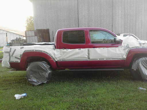

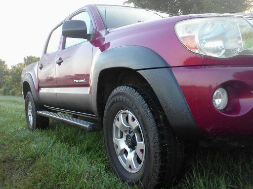

    i had two bottles left over and i am thinking about taking one and doing my fender flares and maybe the lower trim down the sides of my truck also if i can motivate myself to get back in this alabama heat and humidity for a few more hours this week.

    Damn man I like it !

    hows it hold up?

    Looks great still but only been 5 days but ill keep updates every month or so.

    looks. good! I did not know you could do a spray in liner on our beds.
    would like to know how long it holds up.

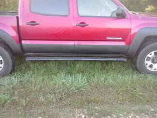

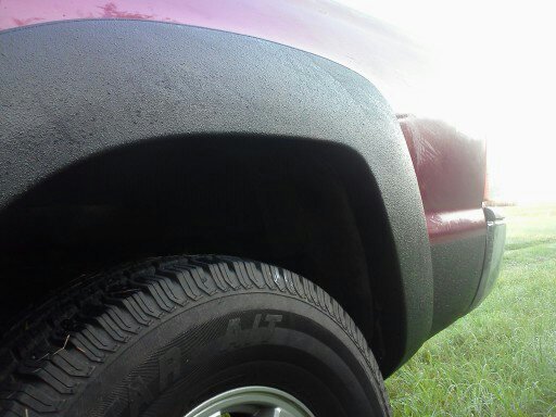

    got a break in the heat(only 89* yesterday evenin) no break from the mosquitoes but i pushed through.

    Looks good man!
