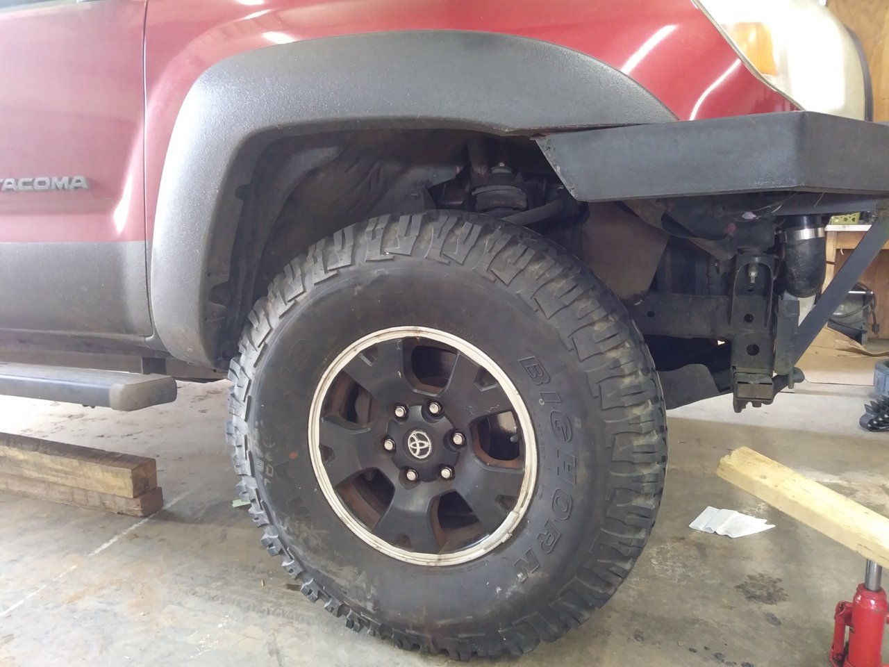

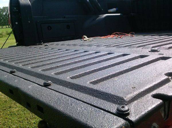

    Heres a pic where i touched it up with satin black. Its where the door seal protector was and it came off.[​IMG] heres the bed just over a year later finally washed it since it was comfy out today[​IMG][​IMG] still looks great. Kinda hard to clean behind the tires where mud accumulates due to the texture i guess but still love it. And as u can see the rattle spray paint matches really good for cheap touch ups

    Do you still own this truck and if so how's it holding up?

    It has still chipped on the edge where I did t sand too good, but my clear coat is getting bad all over so when I get my turbo as close to done as I can I will probably do the whole truck

    Yeah the only reason the edges chipped is because I was really easy sanding there because I had already tapped it off and I wanted a clean line. If you are gonna do a whole panel and can really scuff it up good everywhere I dont think it would chip at all with normal use. And it is still just as today as it was 6 years ago 20190330_120901.jpg

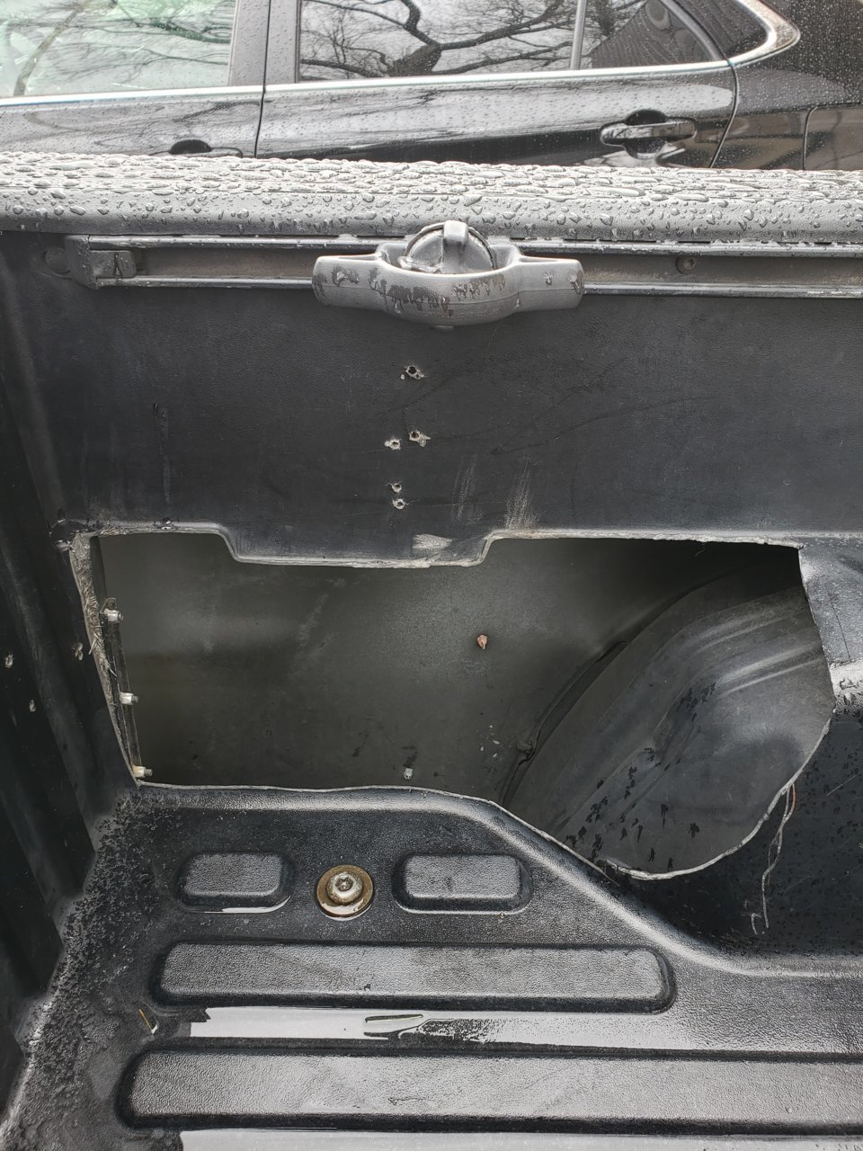

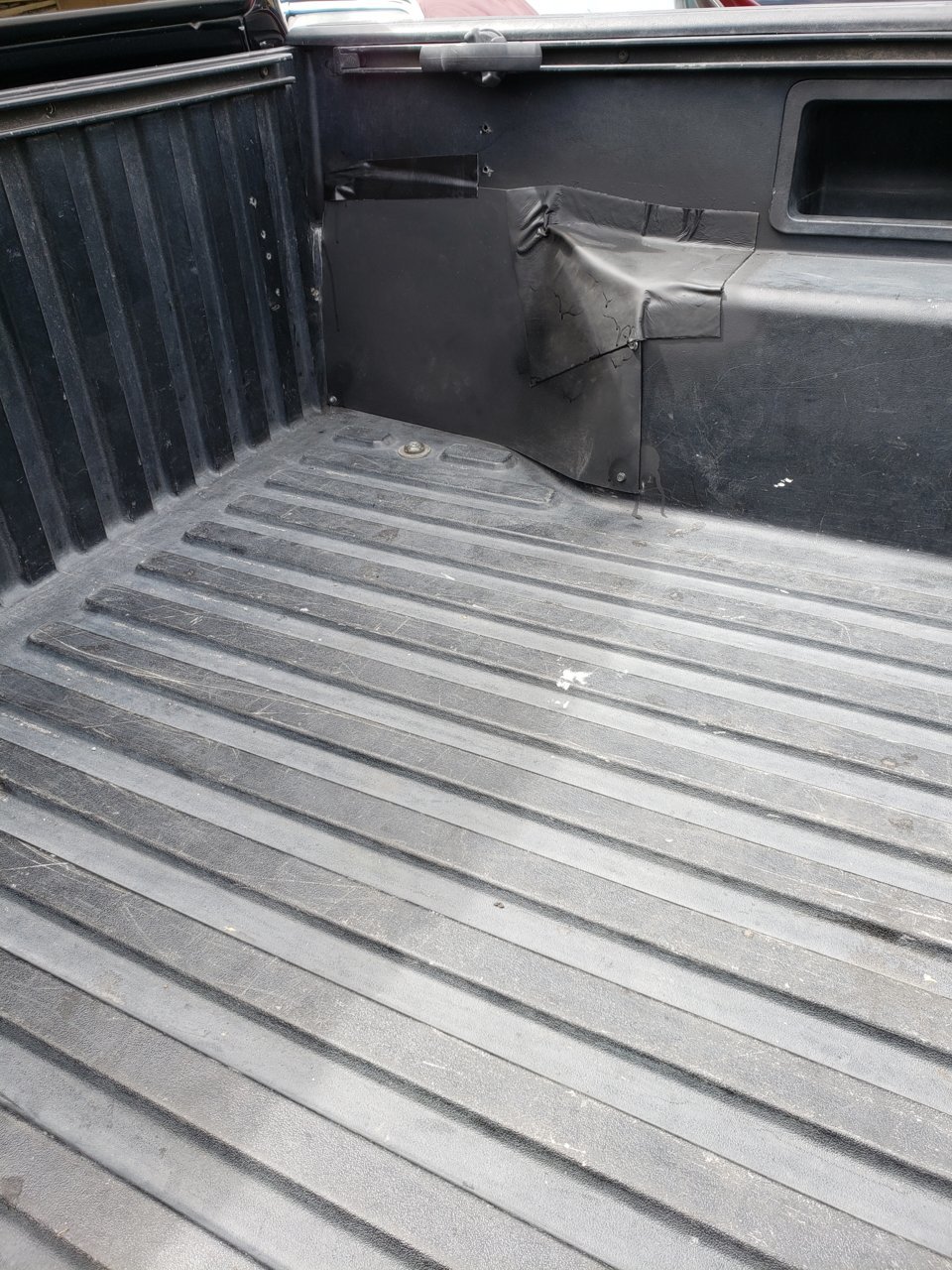

    Yeah I've tossed around the idea of doing the entire truck to. It is getting a little rough around the edges from taking it off roads. But it's still my daily not my fun toy just yet I just want to fix the more important things right now if that rust has to go. This is what the holes look like from the previous owner and then what I did to fix it.

    I still have a little touching up to do. I put a piece of sheet metal, and this rapid patch kit for fiberglass which needs to be sanded down still. But it sure looks a lot better than with those big old holes haha

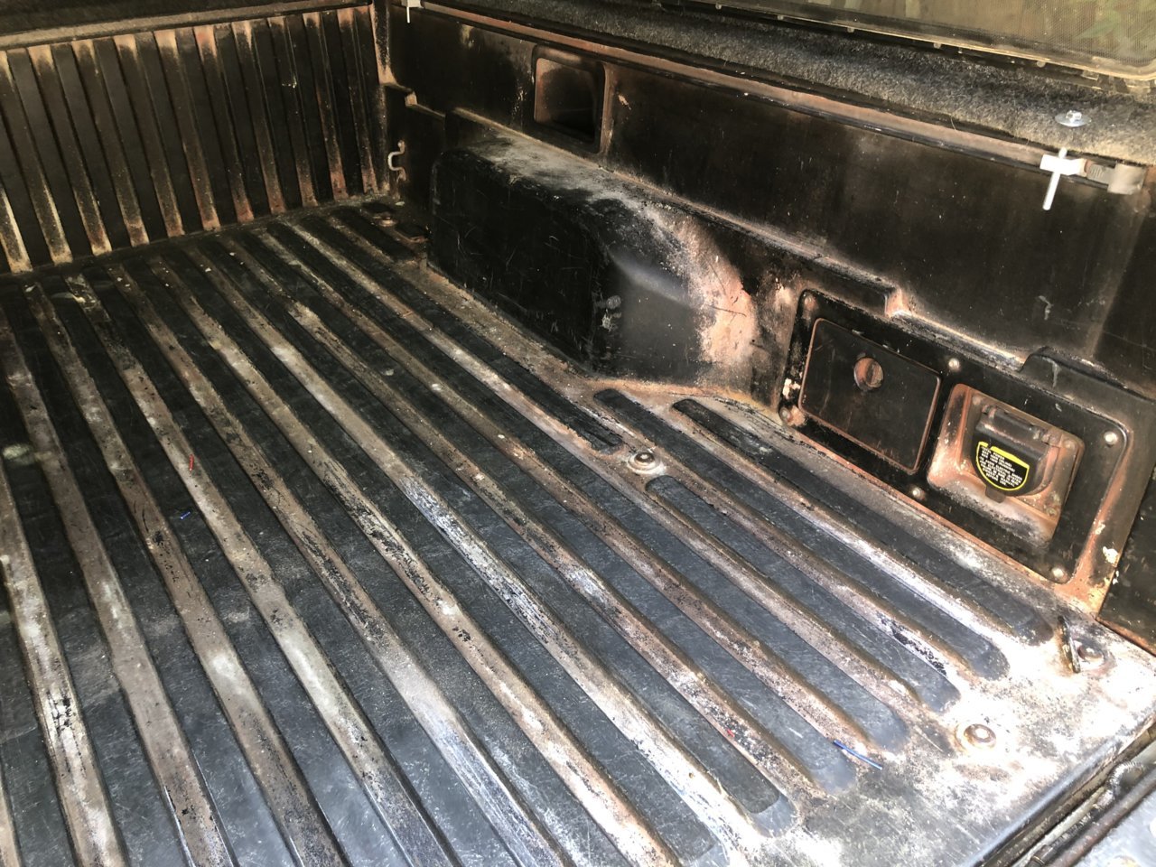

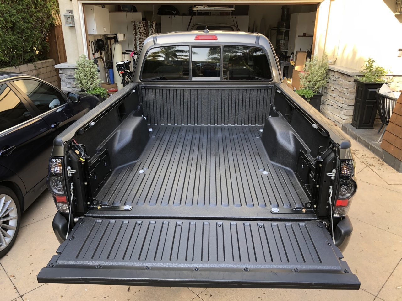

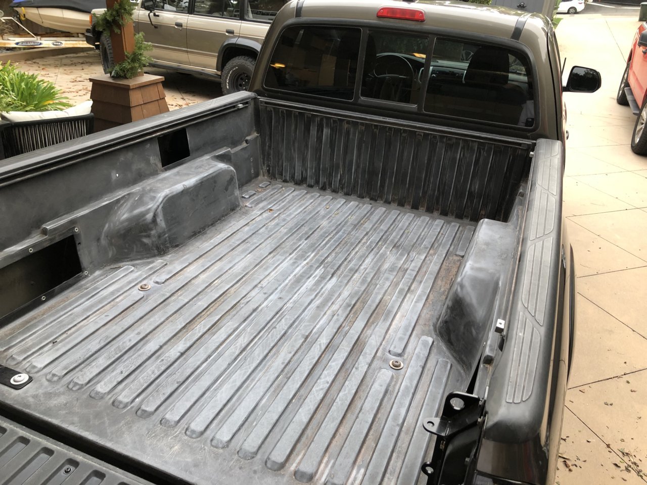

    I raptor lined my composite bed and it turned out nice.
    Pictures show what it looked like when I bought truck, after I prepped it and the final outcome.
