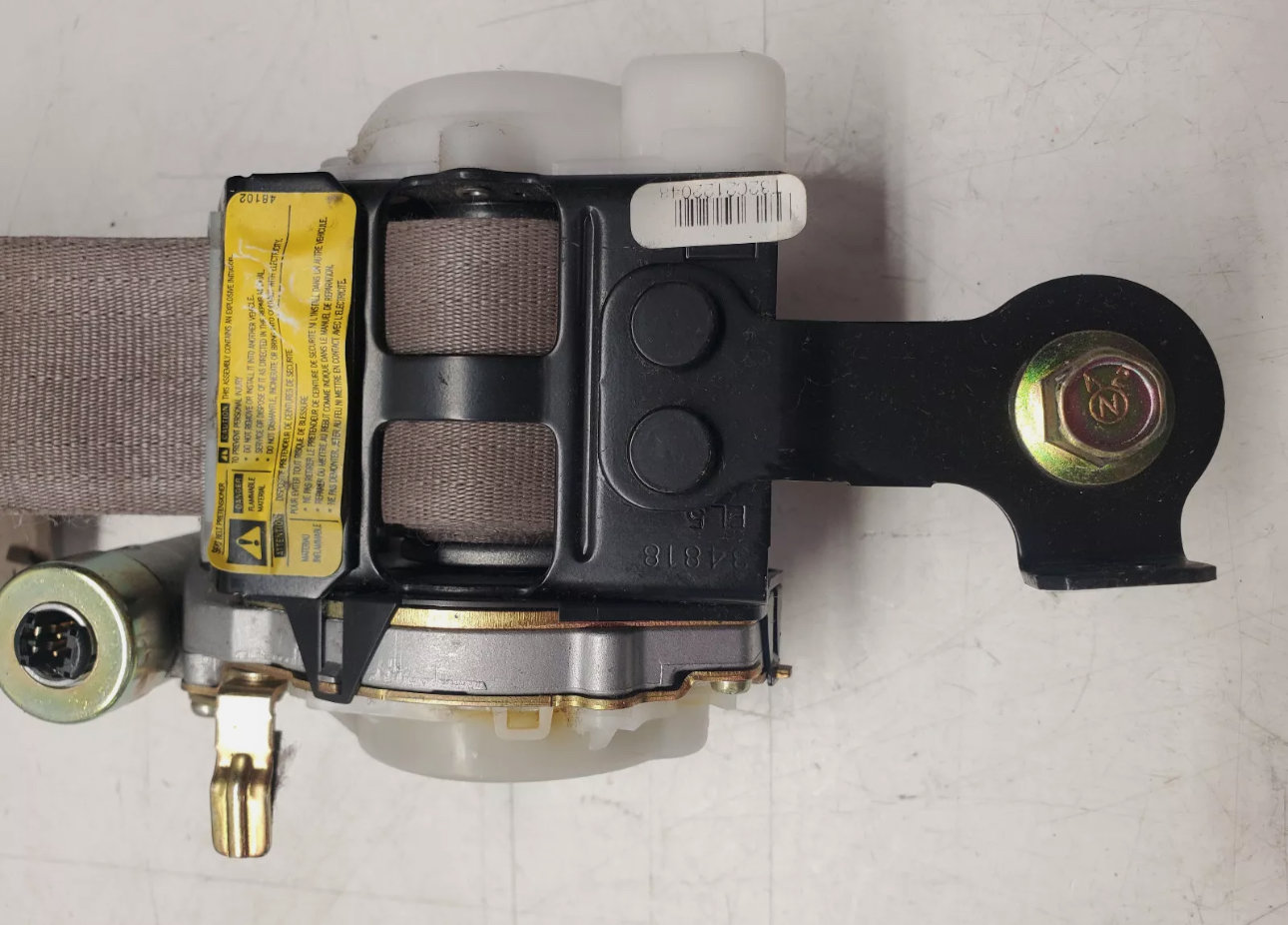

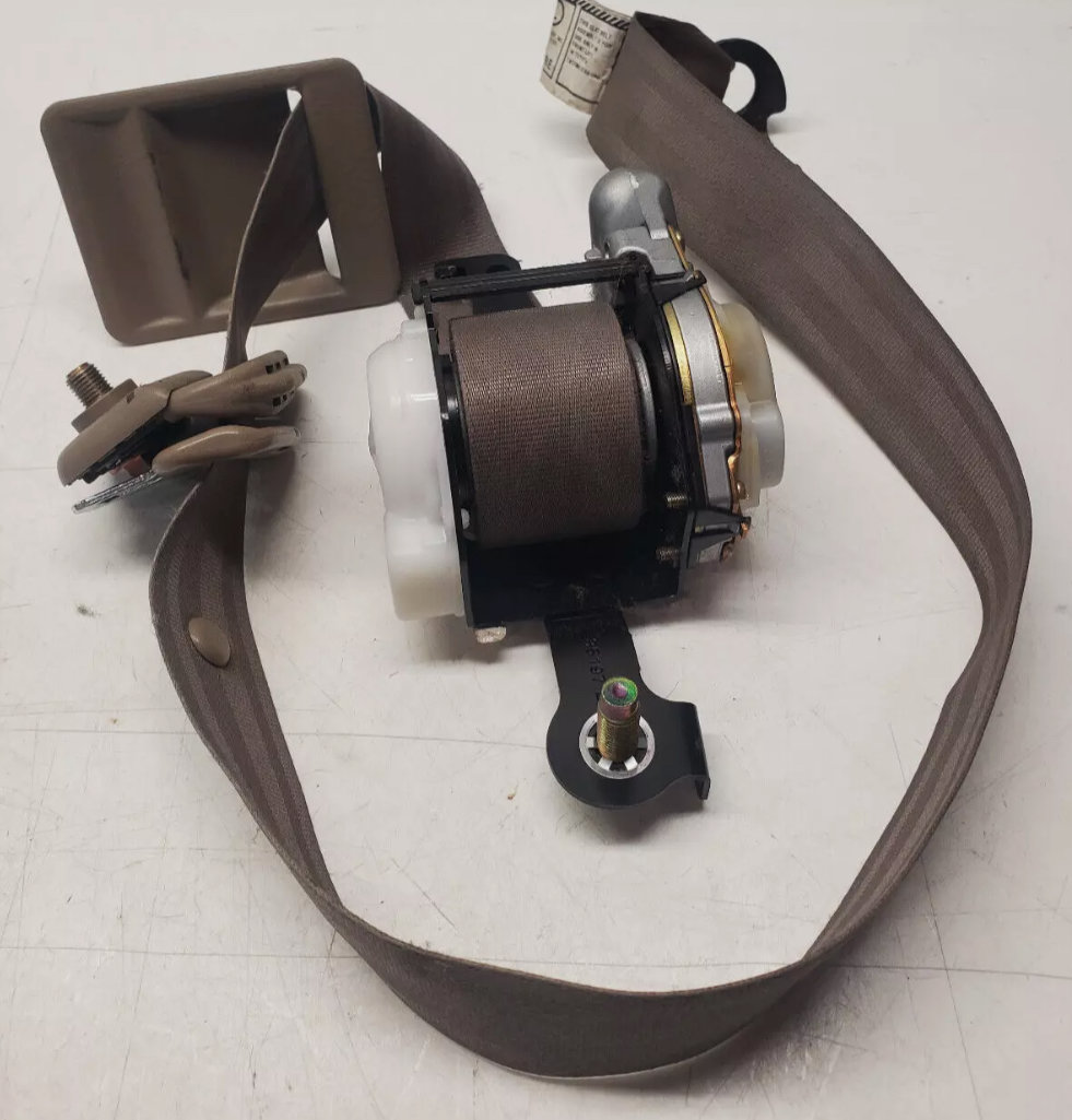

    Contacting sellers on eBay ended up being the winning ticket. I was able to find a seatbelt for my truck as well… Same seller as the throttle body. It wasn’t listed. He checked his inventory and then got back to me pretty quickly(same day) with a price after finding it. It looks almost brand new and cost $149 plus shipping. Not too bad for a discontinued OEM part in great condition.
