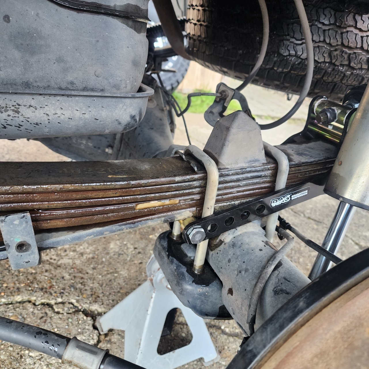

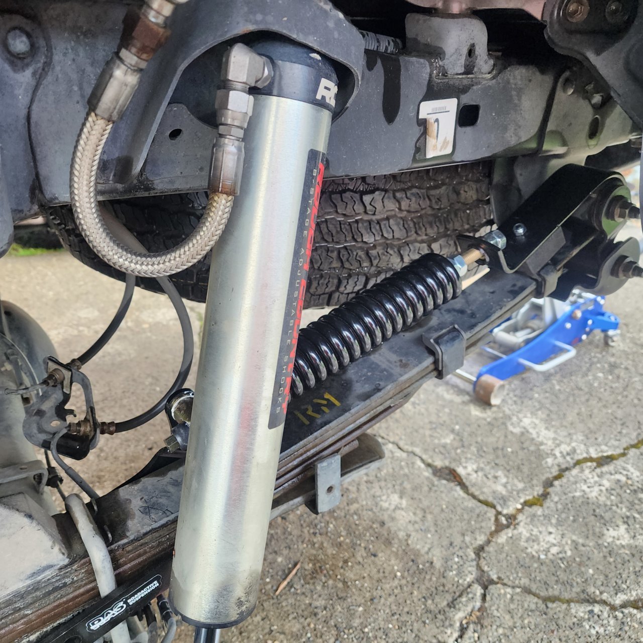

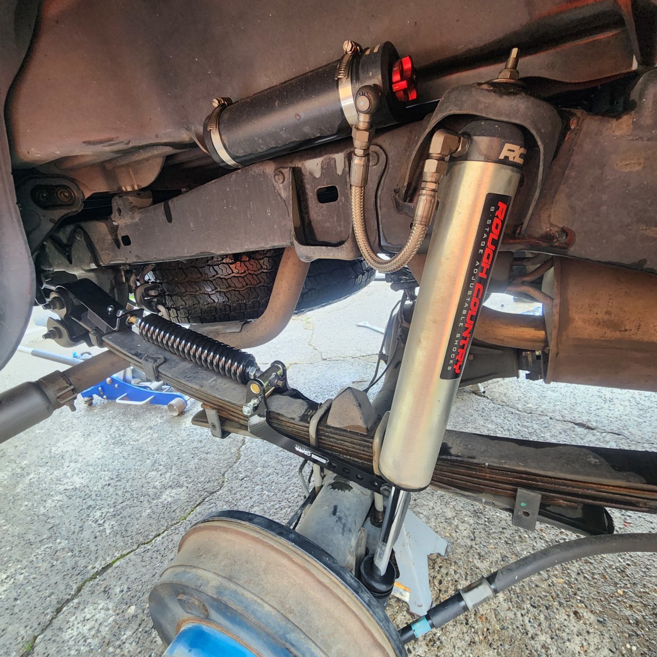

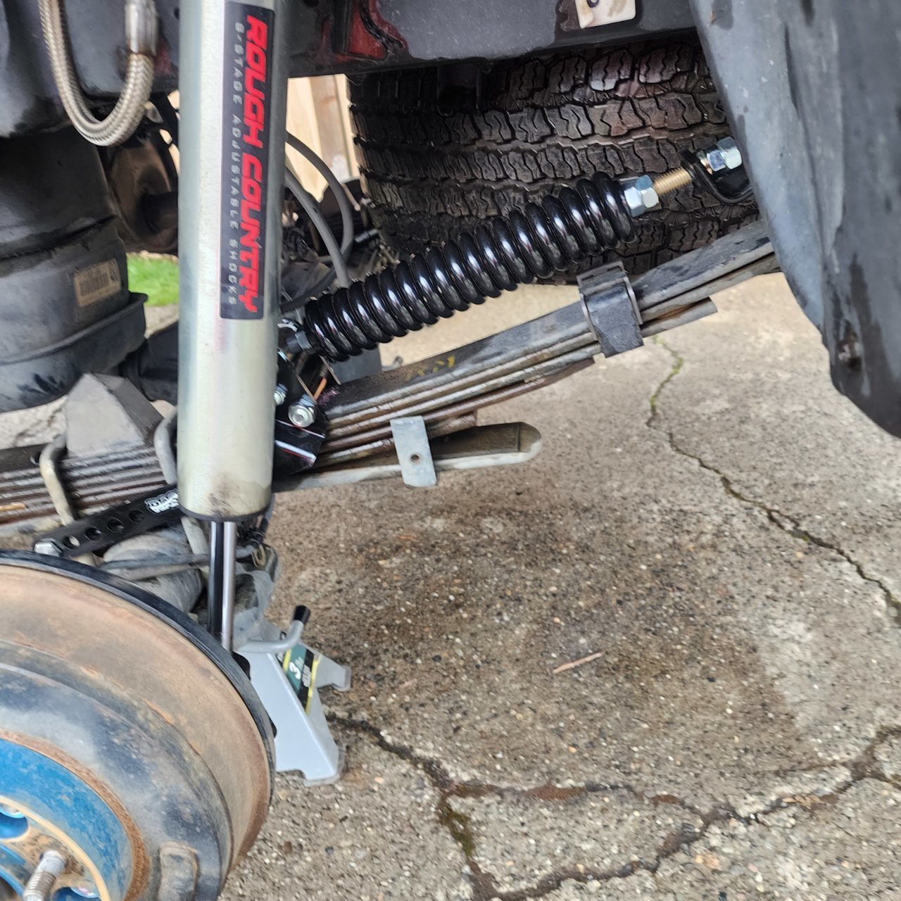

    Bamb took minutes to install now after dinner a test drive 20230323_181533.jpg 20230323_181541.jpg 20230323_181554.jpg 20230323_182151.jpg

    Got back from the test drive if you don't have this setup you're missing out . Handling is definitely improved, acceleration is improved, and braking is way improved. I can actually feel the full power of my truck now. Axle wrap is a terrible disease.
    The ride is just as good or if not better than the front ifs suspension. I'm serious you don't have this you better get it soon . Now for off road capabilities I obviously havent been able to try that out yet . Right now im just happy that my daily drive will considerably be way better .

    I've added quite a bit of performance mods and getting too much axle wrap. Didn't want traction bars .

    Can't see that spring lasting very long.

    If you have axle wrap, its the leafs and/or the alignment. The stock leafs weaken over time. Just look at how many vendors have tried to address the axle wrap esp while lifting vehicle and failed when trying to address both. I believe the RAS was aiming to address towing concerns,sway,added weight. Axle wrap may not have been its goal. And yes its sounding like it helps if adjusted for that wrap problem.
