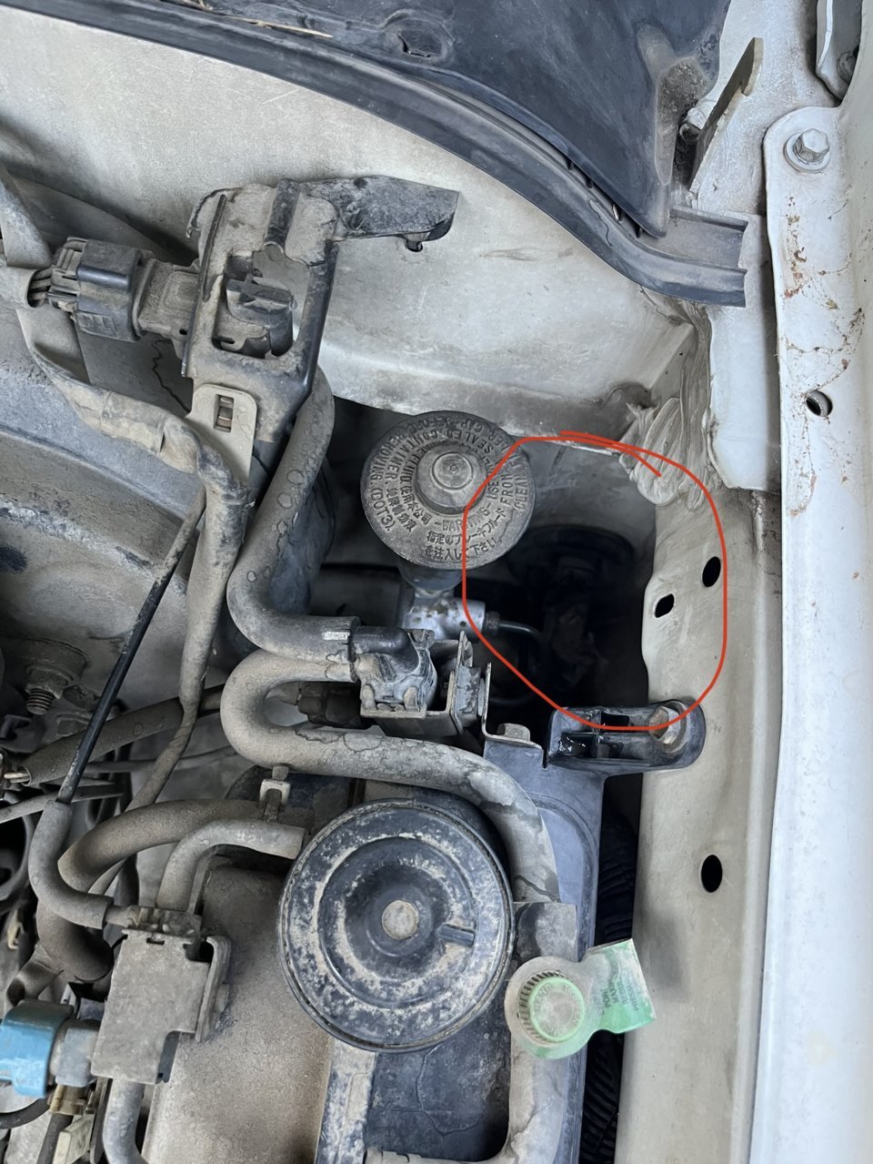

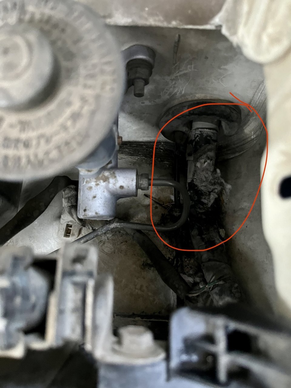

    Can someone please ID this damaged area? Wiring harness, I think? Runs from below the fuse box into the cab of the truck, below the master cylinder.

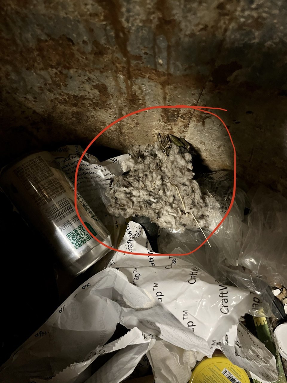

    Left my truck parked next to my wood pile for a few weeks, opened the hood and found a rats nest in the corner closest to the driver’s seat. Underneath the master cylinder there was about a scrotums worth of fuzz. Not sure if that was collected outside and brought in, or if it was pulled from the wiring harness it was resting on. Part in question seems to have been chewed on but there are no visible wires or anything, just fuzz and little bastard teeth marks. Wondering is this is something that needs to be priority replaced. Drove the truck for half an hour, seems totally fine.
    Thanks all.

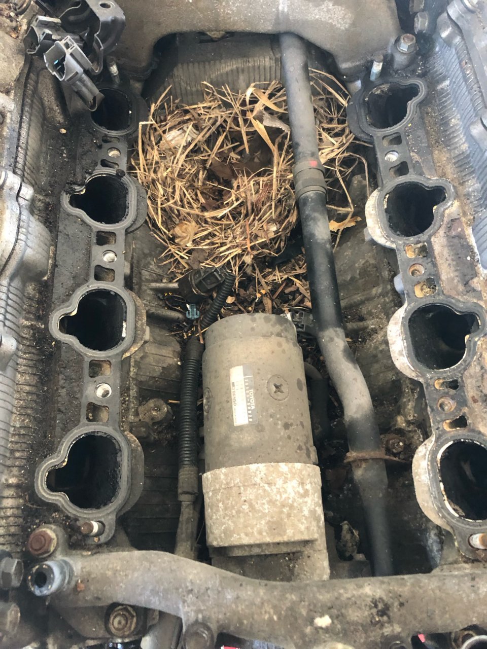

    Thats a small problem, but a problem still the same. The one I pulled out of my Tacoma covered the entire top of the engine & they filled up the a/c system with grass to boot. Took 4 hours to clean it all out.

    As long as you have no problems. I might start looking for that used harness just in case fuses start to open.
    Clean things the best you can and keep driving.
    Good luck!

    My damage was confined to the washer hoses & the headlamps connections. I put heatshrink on the headlamp wires & taped up the washer hoses to fix everything. Every couple of years, the little buggers get into the fan & evaporator core in the A/C system & plug it up with grass in the late fall. Doesn't matter where I park it This last time in November of 2022, it caused my fan resistor to burn out as they really packed the grass in tightly & stopped the fan from turning.
    I cleaned it all out again & replaced the fan resistor & it worked great till a few months ago when the system bled down the freon. I replaced the freon & it has been working great. Rats, mice & palmetto bugs are the ban of Florida out in the country. One mouse 5 years ago got into the cab & ate a hole in the seat covers which I just replaced as they didn't eat the actual seat material.
