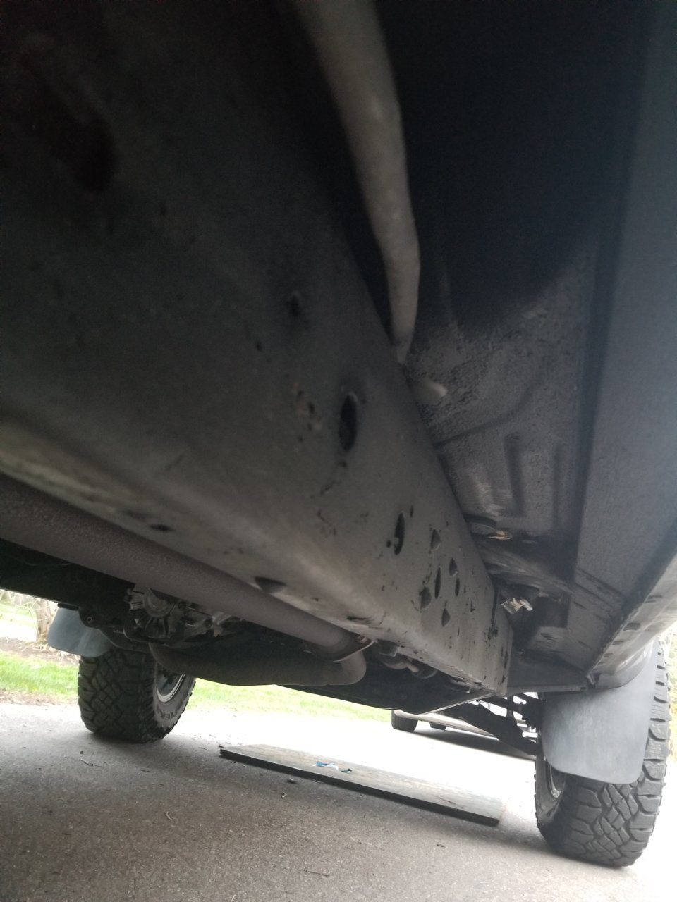

    Those areas are the main regions of my concern. I'm going to unearth the CRC and I'll post back on what I find underneath!

    BTW frame looks decent for a truck from the rust belt. I'm 8 years in on the frame maintenance each year I spend less and less time on it I have build up a decent layer of protectant on it. You are going to need ( 2P) patience and preparation for the surface. USN adage ( 6P) Proper planning prevents piss poor performance. Frame maintenance is mandatory on these Toyota trucks that deal with snow and brine . GL

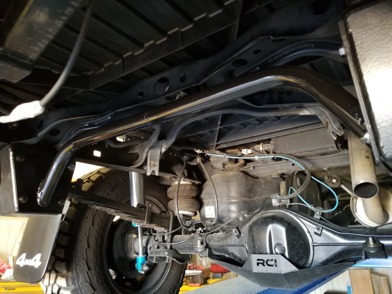

    Interesting recommendation and great looking truck. I do have one issue though. You're in California and they don't use road salt there. Black house paint would probably hold up in those conditions. Folks who have never lived where road salt is used have absolutely no idea how aggressively corrosive it is. And once corrosion starts, it's exceedingly difficult to stop - especially on a frame with boxed and laminated sections.
    Getting back to the OP's question, I'd suggest that your frame doesn't look bad at all for a 2006. My (fully Ziebart undercoated) 2014 didn't look much different when I recently sold it. (Yea, I live in the heart of the rust belt.) If you want my 2 cents, I'd pressure wash the built up dirt and sand off, let it dry for a week or so, then Wool Wax the whole thing - especially the box sections near the catalytic converters. You can try wire wheeling the easy to get off stuff and painting it with POR-15 first, but you'll very quickly find that access is a total PITA.

    Correct, I do not live in the rust belt, but have driven through them many times in the winter, 11 different states. I still pressure wash, have to sand, wire wheel, and paint. I do agree with you and if I did live in the rust belt area, I would probably use FF or some other methods of trying to save my truck from rotting away. It doesn't matter where you live, the coating/paint is crap on these trucks, if you don't take care of them they will rot away, even in CA. Thanks for your input, take care brother.
