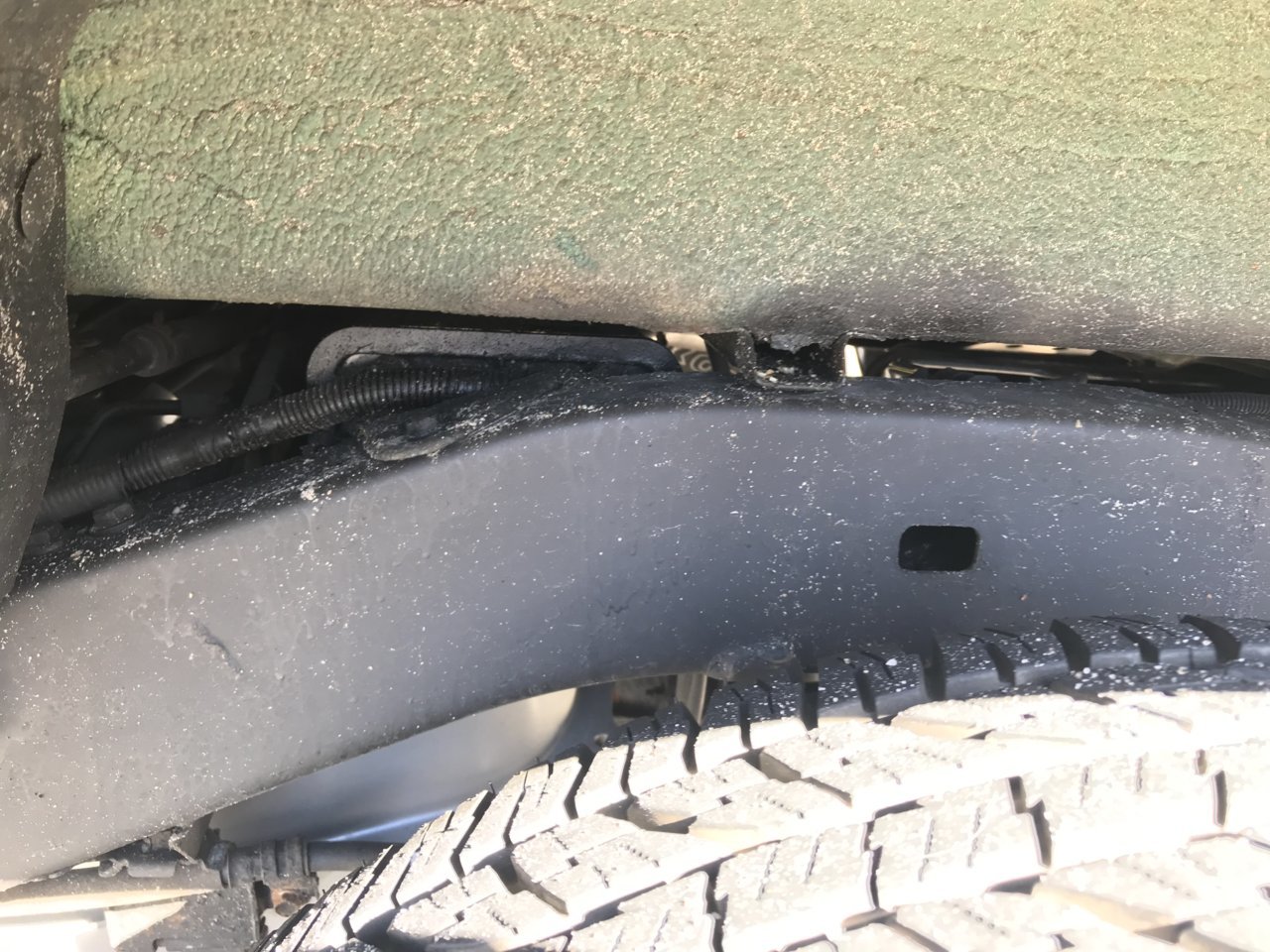

    Doesn't look too bad but seeing that you have an 04, you should take it to Toyota pronto and have them inspect it...if they can perforate it in one of the worse spots you may qualify for a new frame, which is only possible through the end of this year.

    I'd say you have a frame there that will last along time if you take the advice of some previous posters.

    8/10 for surface rust

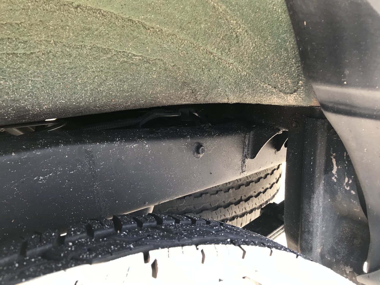

    Your frame was exposed to winter salt and this crap is a notorious killer of truck frames and cars.
    what you should worry about is not the rust outside of the frame but the rust inside. These frames rot from the inside out. They can look not that bad when in fact they are paper-thin. That's why you have to bang the frame with a hammer.
    The worst area for rust is where the leaf springs attach to the frame, right behind the cab. Then the inner frame rails by the gas tank and the catalytic converter can also be bad areas

    If it was me personally, I run a hose from the rear of the truck into each frame rail and flush out the frame for a good 15 minutes each side just to remove and crud or fine debris that is stuck in the frame.
    Then let it dry really really good, come back with a wire wheel and get the surface rust as best as possible, follow up with a good degreasing and then let dry and spray paint, and let cure for like a week or 2, then top it off with fluid film or something along those lines. You can get a cheap boroscope or something and inspect the inside, or just plain get up close and look inside as best you can. If there is surface rust on the inside I’d hit it with some Eastwood internal frame spray, then let that cure for a few days and follow up with fluid film or you favorite rust protectant just like the exterior of the frame.
    Everything else has already been mentioned in the comments. Check near cats for hiding rust on the inside of the frames. They go from the inside out as far as rust spread.

    I agree with you. The inside is what I’m worried about because like you said, I can’t see it.
