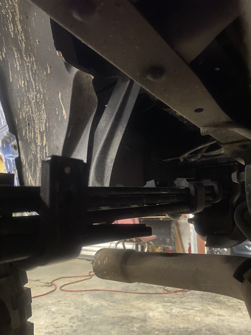

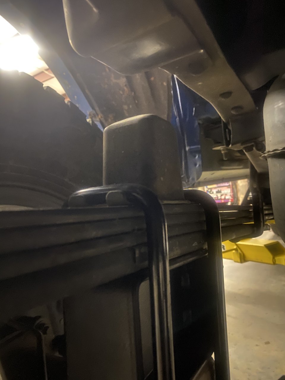

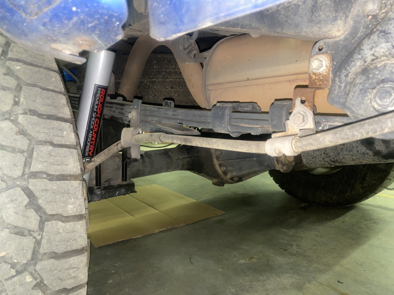

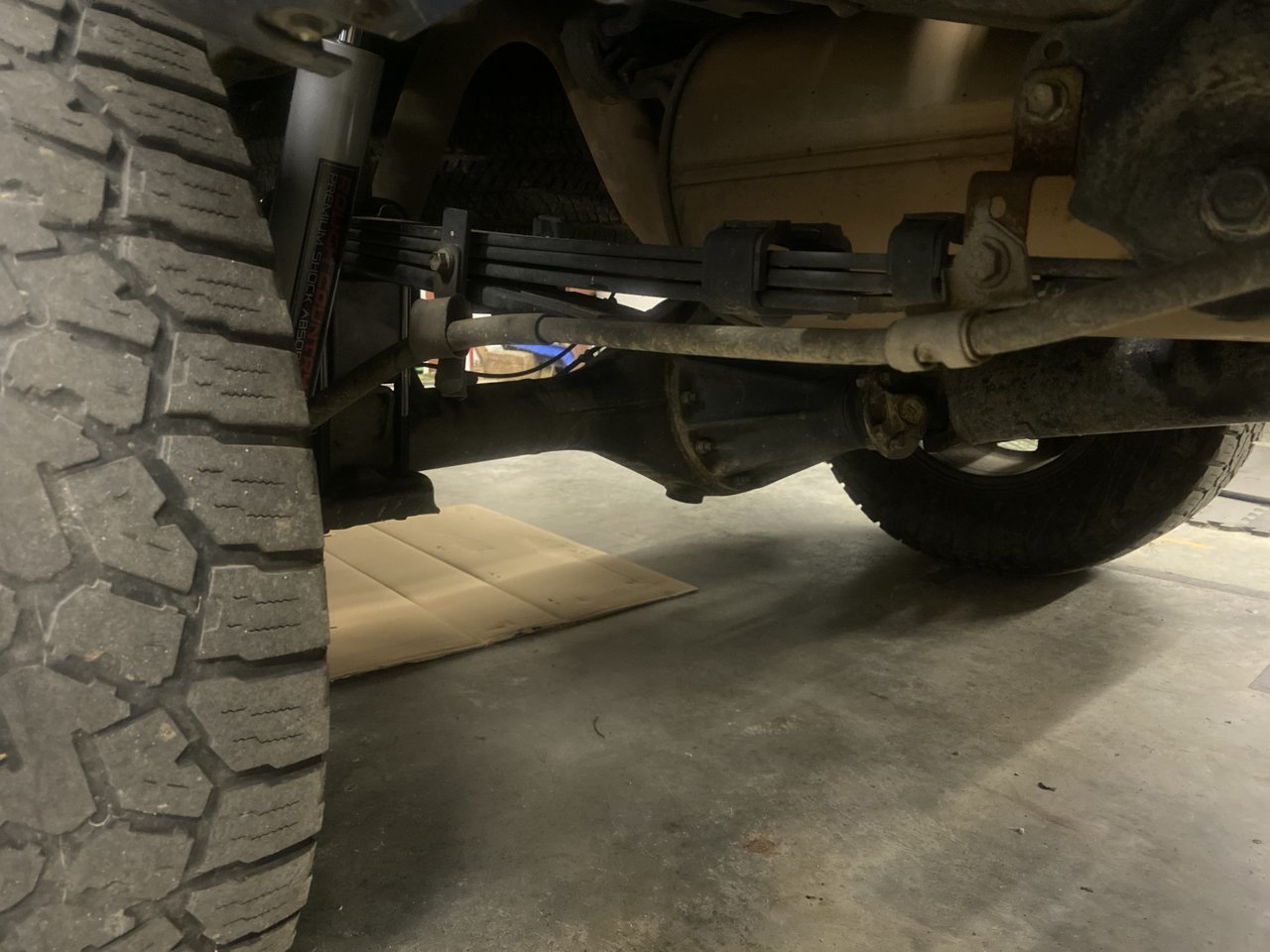

    Just installed a 6in RC lift on my 08 double cab, 5ft bed, 4x4.
    im happy with the quality of the lift and all but one problem! It’s got a bad squat in the rear. 1.5 inch difference.
    I have gone over threads,videos and so on.
    all this said do I need new leaf springs? Saw no cracks or bad damage, pads still look decent.
    3/1 pack if I’m understanding correctly

    Look about normal to me.

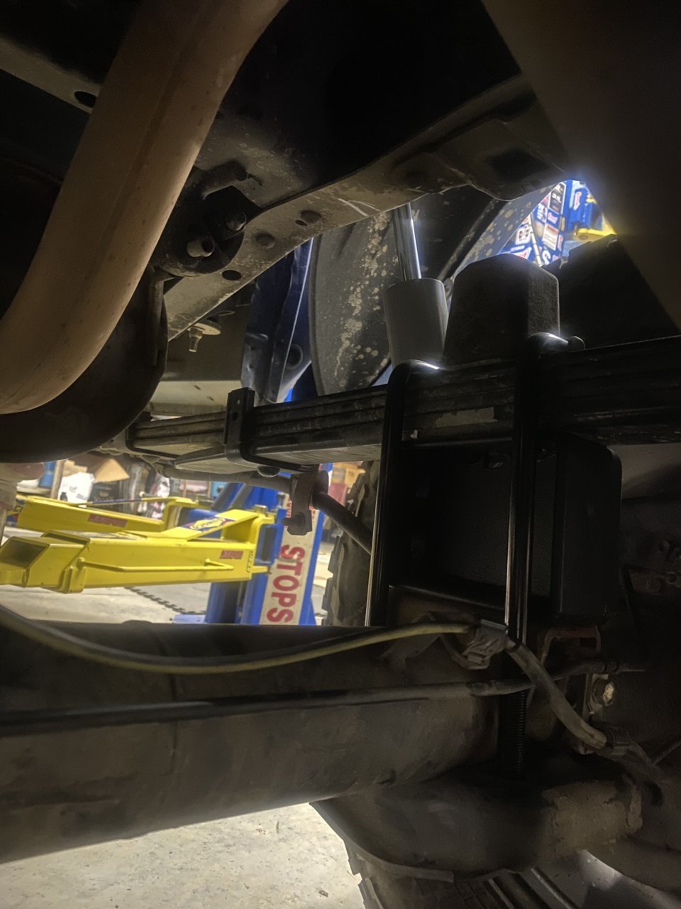

    RC aren't the best quality.
    Most 6" lifts that I do are 2-3" block with an add-a-leaf.
    That mega block in the rear won't do you any favours.

    They look like they're on their way out. Is that with or without any load in the rear?
    Anything you add to them will be a bandaid solution.
    Best option will be a full leaf pack replacement. Toss the shitty Toyota leafs in the trash where they belong.

    New leaf packs will be the best option.

    The springs look fine but that thing underneath them doesn’t look right
