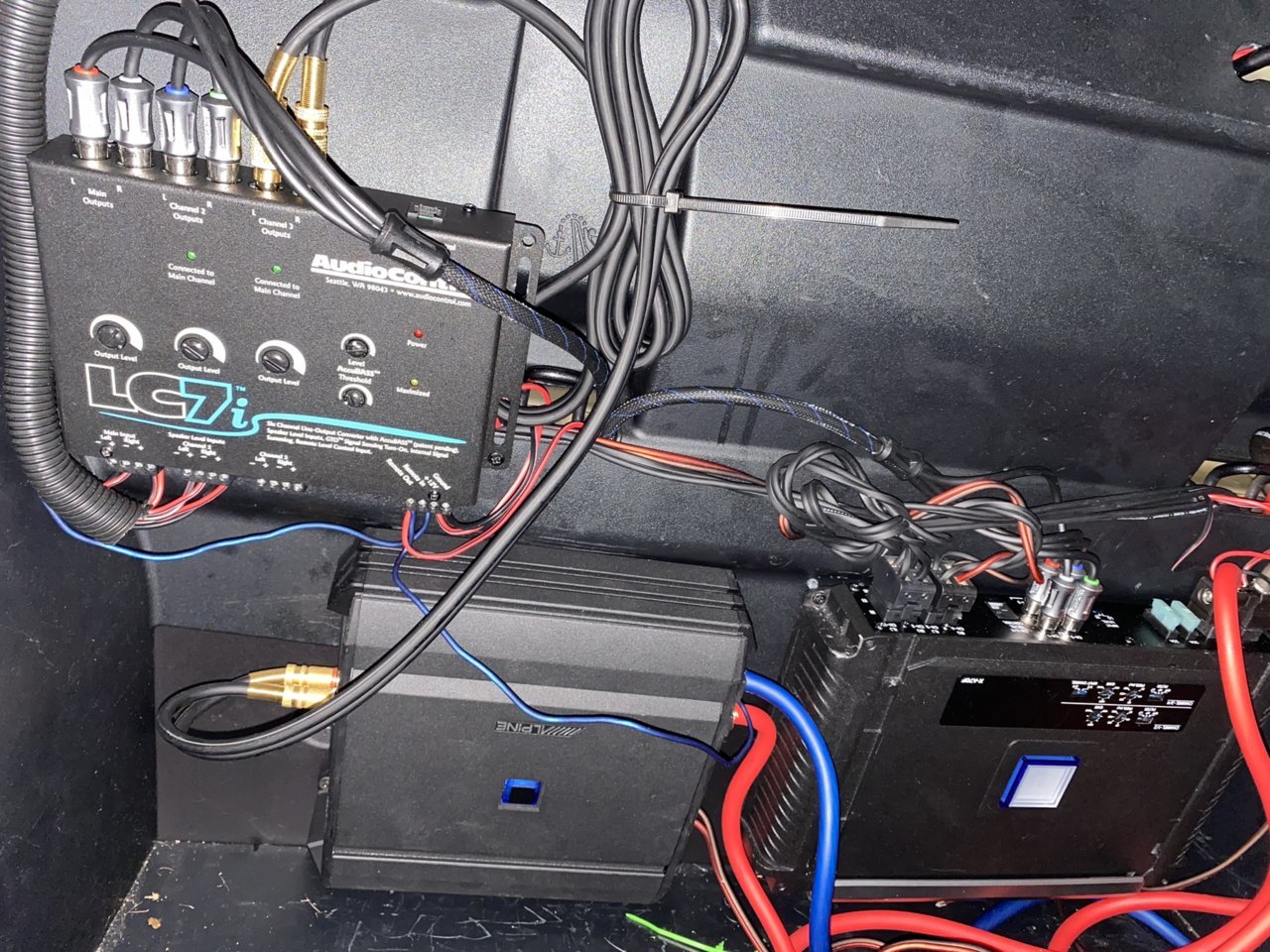

    I have a ‘21 Tacoma with the stock base head unit. I did not want to change the head unit because of all the crap it controls and displays. Rate what I have done and any suggestions welcome.
    I used an LC7i converter to change the speaker wire to rca’s which feeds an Alpine X-A70f amp 4channel. The dash has a pair of Kicker 2 3/4 mids (Want to swap but cannot find right ones in this size) The front doors have a set of Hertz Mille pro 165.3 component with a 6.5 woofer/tweeter/crossover. Rear doors have Mille 165.3 pro coax.
    It sounds great, I want to put in 1 10 or 12” woofer. *********.com sells a sealed enclosure that goes behind driver side rear seat. I was thinking Alpine a-s60m with Alpine sw10d2.
    Ideas, comments? Thanks.

    1 question, 1 suggestion.
    Q - Why the Kicker 2.75”? Wouldn’t a matched tweeter, to both the crossover and mid, sound better? Or did you not use the crossover?
    S - Just a note, if you go with the A-60 amp, get the D4 sub. That amp isn’t capable of 1ohm loads.

    The kicker is a leftover from the original kicker speaker upgrade I did before I got serious. I am looking for a decent mid now, but hard to find in that size for the dash.
    The front doors have a woofer and a tweeter. That is the Hertz Mille pro component set with the 6.5 woofer and tweeter that came with a crossover. I put the tweeter on the inside mirror cover.
    I like the D4 and the 2, thanks for the heads up. I was going to run it at 2ohm. Is the amp enough power if I bridge the D4 to 2ohm or should I get bigger?

    Understood. What about the Hertz Mille 70.3 mid? 1/4” shouldn’t be too much harder to fit, using the Metra dash adapters. Maybe a little trimming? Or have something 3D printed?
    The A-60F is good for 600w @ 2ohm, so wired for 2ohm, should be a perfect match.
    *edit*. Just had an idea. What about a www.cdtaudio.com wideband? That should fit almost like the Kicker.

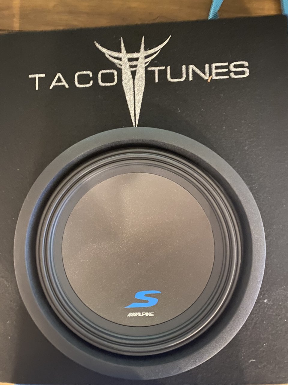

    I have my box and woofer, waiting for my Alpine s-a60 to come Monday. Then all done, I hope.
    I am now a believer in using the hush mat on the doors during install. I did both panels on each door as recommended. The Hertz Mille woofers hit hard, and the Tacoma is quieter than my ‘21 Lexus ES F. It is freaky, I don’t hear cars go by.

    Put the box in, amp Monday then BOOM?

    for as much as those boxes cost, you'd think they could include a trim piece for the top!

    To be honest I thought the price was good for a custom box considering how much contour they have in the back. It’s quite heavy. I highly recommend it for anyone looking to put in a sub. AND it is on driver side so I had all the space on passenger side for the amps.
    They could not do a trim piece or the seat would not close.

    The amps are in, everything sounds great. The sub is sick. I am breaking in the sub at 50% and it is shaking the truck.

    How are you tuning the amp? DD-1, multimeter, O-scope? Always curious how others do it.

    Man I want a DD but for now by ear and then going to head over to local stereo shop to have them take a look. I don’t want to drop $200 right now on the DD and can’t find anyone with one.

    I’m like you. I start with with a DMM, then tune by ear after.

    One thing I will say, you got a lot o’ “psgetti” happening here. :D:D
