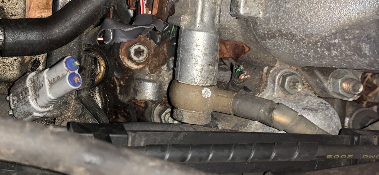

    Had a rough start up on our 2004 Taco this morning. Check engine light came back with a P0018 and low and behold we found the problem pretty quick!
    I've been trying to search the parts.toyota to no avail so far. I'll keep looking but in the mean time, any suggestions? thanks!

    ok, what is it you are asking for? If you can take a picture of your connector(s)... I have a harness that was on a JDM motor that I swapped out a few years ago, I just might have the connector(s) and a bit of wire attached.

    Unplug the connector, you can push those pins out and solder them to the wire, then click the pins back into the housing. The harness should be long enough to reach.

    X2. Unplug the connector and send some pics inside and out. I too have an extra engine wire harness, for 3.4 5vz-fe. Would send it to you free plus shipping.
    Or do as stated above and solder wire onto what you have there. Either way you have to solder/connect wires.
