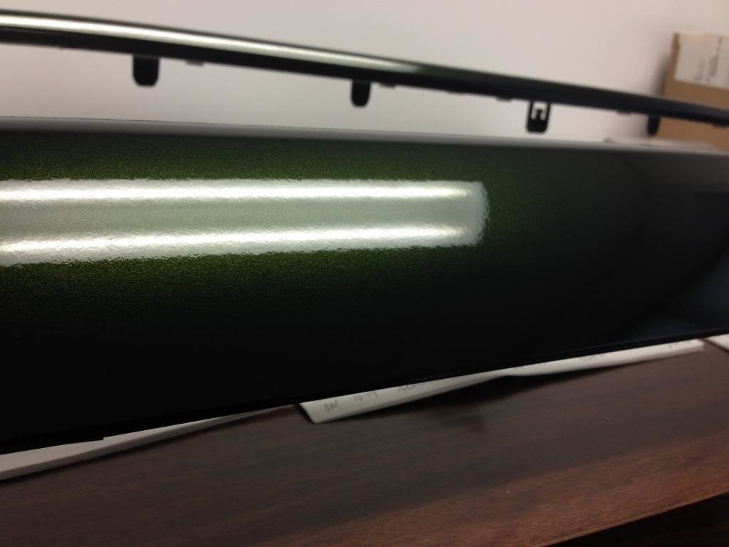

    Just rough up the chrome. I did 4 coats. First primer, then I used metallic with the speckles for a little texture and then satin. Clear coat for finish and a year later no problems. I've learned if you always wanted to go back you can find one on here or CL.

    If you click the link I posted it's a whole guide. I got everything from Automotivetouchup.com. Their paint comes out perfect and their clear coat is smooth as can be. Here ya go- this is 100% rattle can
