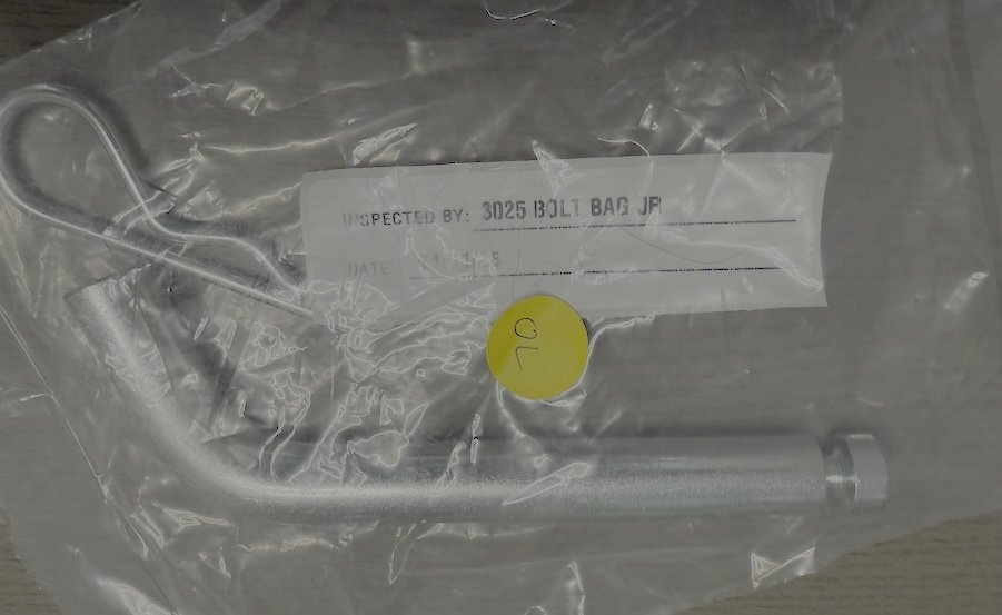

    When sitting in the front passenger seat, the noise sounded more like it was from glovebox. Opened it up, removed the owners manual, cable package, and all the paperwork. Buried at the bottom was a receiver hitch pin! That was what was rattling around over rough surfaces. Took that out, truck is nice and quiet now. Maybe this will help someone else in the future :)
