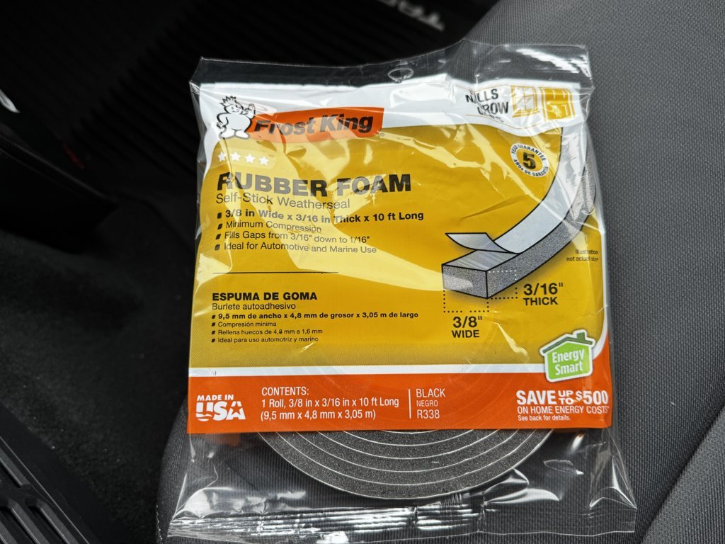

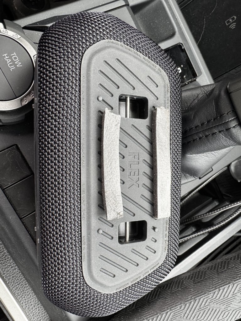

    I'm new here, longtime Toyota guy one month into ownership of a '24 SR5. Not sure if anyone else has experienced an annoying rattle from the dash JBL Flex speaker. I wanted to share my solution in case anyone else has this. It's pretty minor, but rattles are maddening.
    I'd been hearing a rattle from the dash since I got the car. Couldn't quite figure out what it was until my son popped out the speaker just for fun while we were on the road and the rattle finally stopped. While the bottom of the speaker is soft rubber, the whole unit, at least in my case, doesn't seem to engage tightly with the spring clips when it's pushed into place. It seemed the clips were tapping the metal bars just slightly, causing the rattle. I just added a few strips of foam weatherstripping I had in my workshop to the bottom of the unit. This lifts the speaker a bit when it's in place, and tightens the engagement between the clips and the metal bars. No more rattling.

    If it were me I’d go to the dealer, ask them for another speaker, drop it in, go for a test drive to see if it’s your speaker or the receiver. If it’s the speaker that’s an easy fix.

    System sounds substantially better with the speaker popped-out & not in use...
    Way to much volume from the center channel makes thing an overwelling cluster fk.....
    Also takes away from the alright sounding other dash speakers...
    Inregards to the op, I wouldnt accept your workaround as fix, we paid alot of cash for these trucks...
    Yes techs use foam strips to fix rattles on interior panels, but not on a portable speaker that your going to see everyday when its being use as a portable unit...
