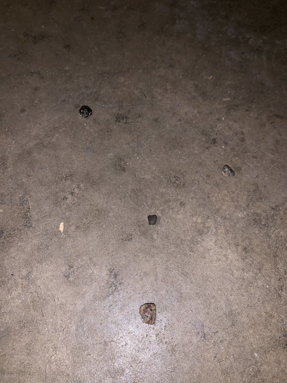

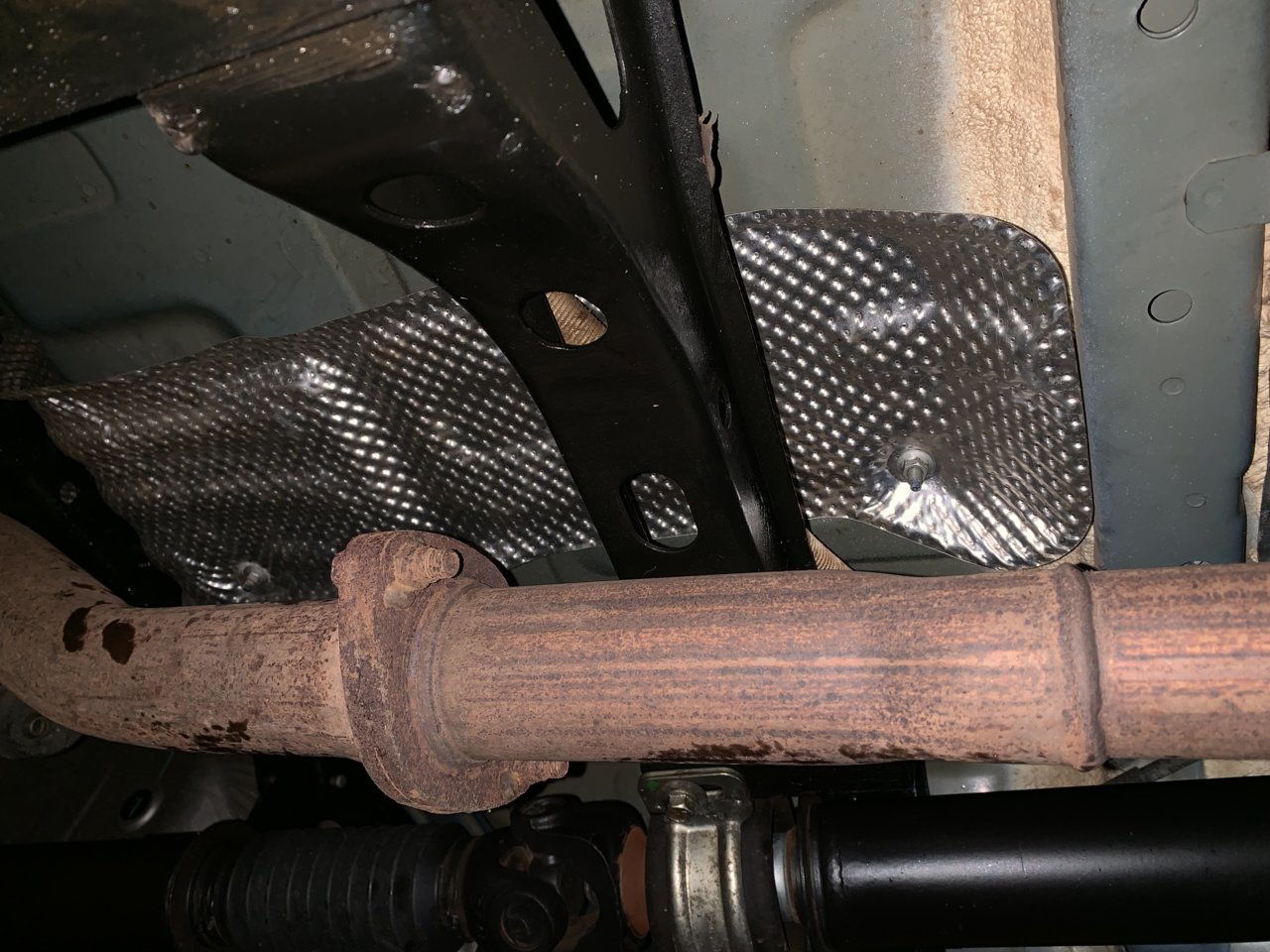

    Had an odd sounding rattle when going over washboards/small bumps.
    Was possibly 4 small pebbles on top of heat shield. 10mm and bend down to remove shield. Sounded more like a loose bolt. Will see if sound is gone tomorrow.
