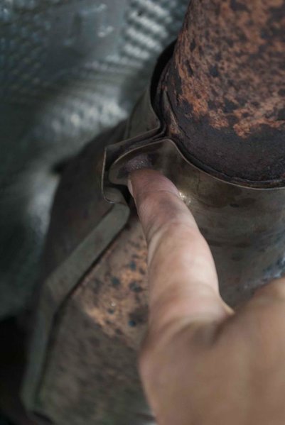

    I found the problem in my case, it was the foil heat shield above the cat and clamp around the heat shield on the cat. The foil heat shield had corroded and the nuts went on through it. The clamp (see pic) was totally rusted off! I fixed it today, 90 F outside on a crushed stone driveway, ouch :eek:!

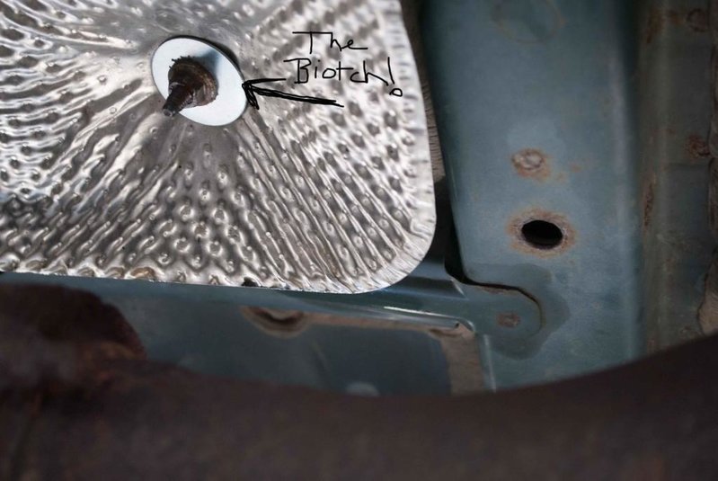

    I had that same noise, drove me nuts. It was the shield over the cat, one corner bolt rusted thru and it was the one end of the long skinny heat shield. The hole in the heat shield enlarged and slipped over the bolt. I added a fender washer. Here are the pics of the problem spots.
    Edited; forgot pics LOL

    Same problem - 2008 with 100K miles on it. I took it to the mechanic and he quoted $200 fix. I found the problem with a lot of help from your comments and Recker's pics. It was the exact same bolt that Recker is pointing to and it caused an obnoxious rattle around 1500 RPM's. Bought a hose clamp and fixed it for $2. I'm a newbie to the forum and to working on my truck so I just want to point out a few things that I learned that may help others in my shoes: The "heat shield" is actually a casing around the catalytic converter and not the series of thin protectors attached to the undercarriage above the exhaust. See Recker's pic with finger pointing to bolt. This is most likely the culprit if you're having the same issue. I also found that one of the thin protectors had a hole that was rusted and slipped over the bolt. I took this bolt out and added a washer thinking this would solve my rattle. It did not but I'm sure this would have caused a rattle down the line so I'm glad I attacked that as well. Thank you all for your help!

    Bump for a thanks. Never would have found the rattle in a million years if not for this thread. My case was the same as Recker's; opposite side of the heat shield from the strap. The strap on mine actually looks to be in relatively good condition
