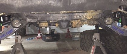

    New to the lower control stuff...do they help you not to need an alignment?

    Just gussets... everywhere
    Just need the cam tab gussets or it won't really align

    The cam tab gussets hold an alignment better than stock. Could also solid mount the lowers and adjust via a heimed UCA.

    Thanks might need to invest into some TC lower control arms
