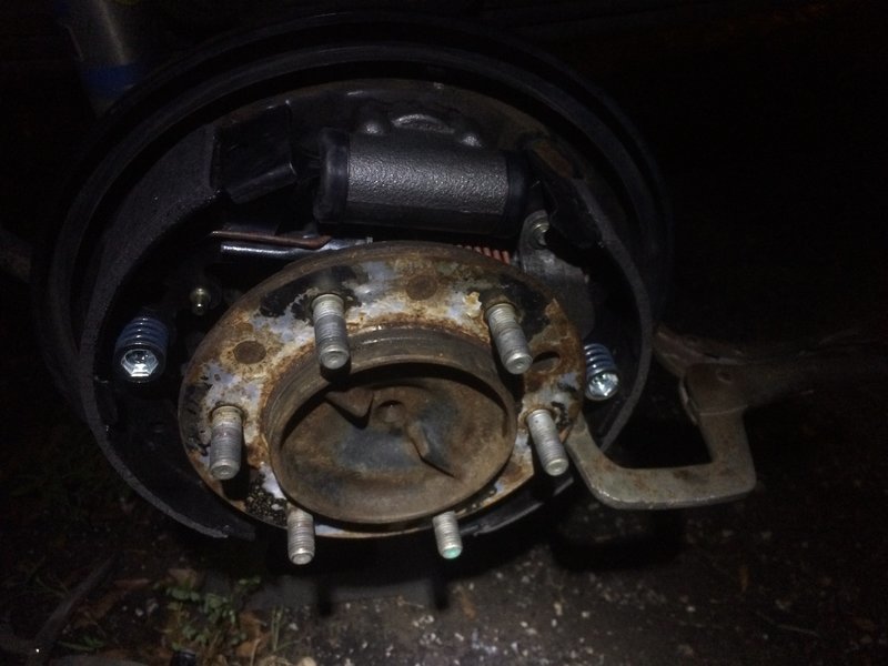

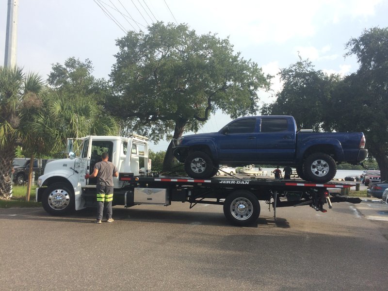

    So my rear passenger wheel cylinder blew and I lost brakes while heading to go do some fishing. Luckily I was close to the boat ramp and was able to limp it there. Went fishing on my friend's boat then when I got back I had it towed home. Ended up doing both sides and man what a PITA the wheel spacers were in getting them off. @Taco No Baka had a good idea of putting the wheel back on and pushing it back and forth and they came off. Then the drum where the wheel cylinder blew gave us issues because the adjuster was all boogered up. We got it done though and didn't have to take it to the dealer :luvya:

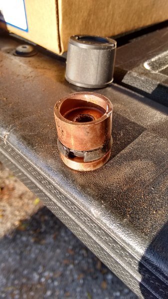

    Here's one I took. This was the cause of the issue. :thumbsup:

    that rat bastard! thanks again for the help Lee!
