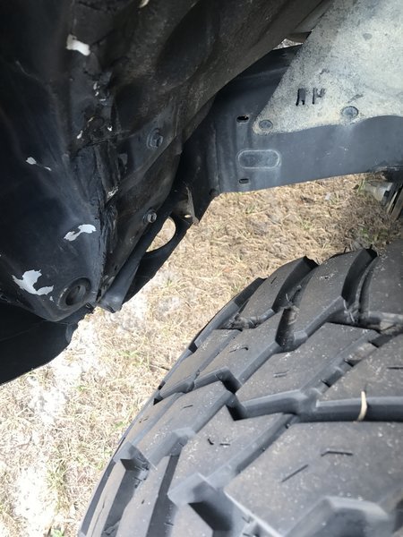

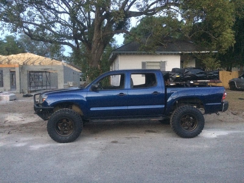

    Wheels have 3.5" BS which means they stick out more than say 4". The alignment will get my caster up which will push the wheels towards the front of the truck more. If it's not enough, more hammerin and cuttin!
    Yes sir! All in the Original Post (OP)
    Lmao and fuck my brand new tires up!?

    Frank in order to move your tire to the front of the wheel well you need to decrease the caster is that correct?

    Yes, I'm aware. But wheels with 3.5" BS will also make the tires describe a bigger arc when turning because they sit further outboard of the pivot points (your ball joints in this case). Wheels with more BS will be closer to the pivot points and will provide more clearance.
    If you still have more you can trim, then go for it, but just keep in mind, if it's rubbing now and you get it clearanced so it doesn't, it could very well still rub when stuffed. Mine are still trying to grab the wheel well liners and junk even though I keep trimming them back. They were grabbing the bumper as well until I cut an inch off the ends of that, and I'm running 3.5" BS in the front with only 33s. Granted they are different trucks so your mileage may vary.

    Increase! Ideally want 3.0 but knowing tire kingdom they'll shoot for 2.5 which is stock
    Yep need 3.5 BS so i dont rub the rear shocks. If all else fails, I'll get @Timbo89 to tub da bitch

    Definitely going to take more off

    Truck is looking great man.
    I wonder how bad I will scrub with 285/70/17's and these wheels on 5" lift up front
    Already did the CMC, just havnt started with the BFH until I get the tires
    What are you spraying in there the coat the pinch weld?
    Rattletrap66[OP], tacoma16 and MarX like this.

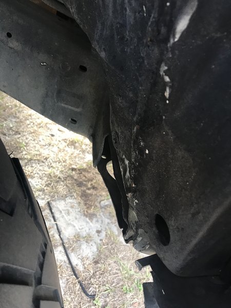

    I'm running 4° caster. Also cut the body mount all the way to the actual mount and then smashed the wheel well back to it. Still rub in reverse full lock but it's a smooth rub so not damaging the tie
